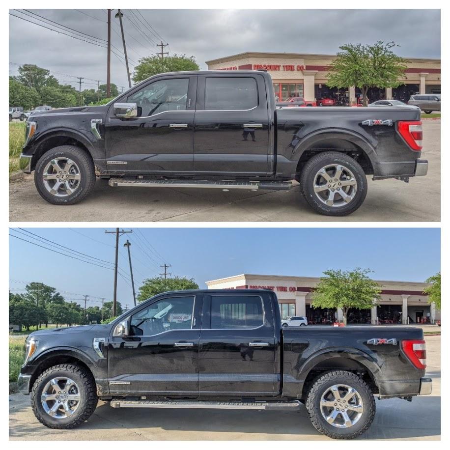

I know I asked for light tires, but in the end I went with the tried and true BFG KO2s. I had a 17 Raptor and went through two sets of KO2s on that truck and they are such a good all around tire that I didnt want to experiment.
285x65x20 no level no rubbing.

I installed firestone destination x/t AT tire and they are light weight and quiet.
How are you liking these tires so far? Any photos of them installed?
That is by far the least rake I’ve seen on any unmodified ‘21. Looks good!

Update on this thread - Have about 10k miles on the 285x65x20 KO2s with no level. MPG is same as it was stock - I get 23-24 in town and 22-23 on highway doing 70 mph. Yes I recalibrated the speedo with forscan. I almost always run 93 top tier gas from costco and yes I do notice a 1.5 mpg drop when using no name brand 87 gas ocassionally.
Not seeing any downside to the 34 inch tires. Not leveling has a lot to do with this is my guess. i.e., level affects MPG more than tire tread or size. Again, just my view, your mileage may vary (pun intended).
