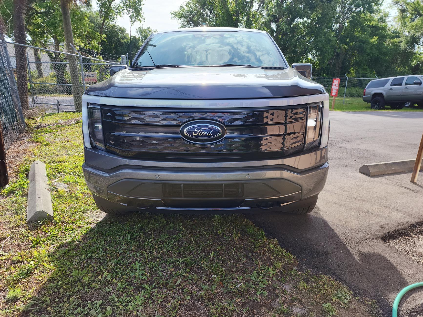

flrsb62
Mar 27, 2023
2023 F150 Lightning
Ford F-150 Lightning Paint Protection? 20230327_100534
I I just covered the entire front, mirrors and A pillars. Basically where rock would hit while driving. I ceramic coated the rest using System-X.
