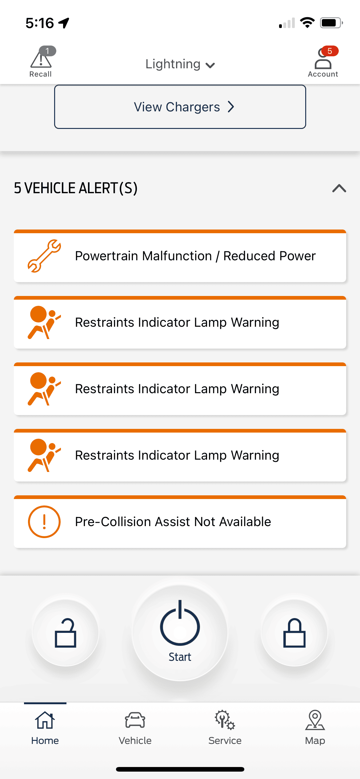

The dealer could not cause the fault(s) to occur again. Picked up my Lightning Thursday. The issue happened again right when I was stopped waiting to turn into our subdivision on the way home from work Friday. Another pickup passed me coming towards me on the left and that triggered things. Maybe a faulty sensor in the front bumper?
I did stumble upon messages appearing in the FordPass app.
Ford F-150 Lightning Pre-Collision Assist not available error 87CB4622-781F-4437-BE8A-72AD46132BF3

My truck had not had this happen in over two months. Until this morning on my way to work I was stopped waiting to make a left turn and coincidentally at the same time a car was driving by on the passenger side when this happened again.
Multiple messages show up in the FordPass app as well about different modules in the truck with failures, and the brake lights were stuck on as before.
FordPass app messages:
collision warning system has detected either a system fault or an obstructed radar sensor
restraints control module has an internal failure
system has detected a powertrain or four-wheel drive fault
occupant classification system module has detected a fault with the power train control module
restraints control module has detected that the occupant classification system module is present but not configured

Found this thread and my XLT SR had exactly the same errors as below:
1 "Powertrain Malfunction/Reduced Power"
2 "Restraints Indicator Lamp Warning:
1 "Pre-collision Assist not available.
Those errors didn't affect how truck drives and went away by themselves after a while. Also, I didn't pay attention if my brake light is on or not. So far it happened twice, almost at the same place and same time.
Wonder anyone else had similar issues or not.
