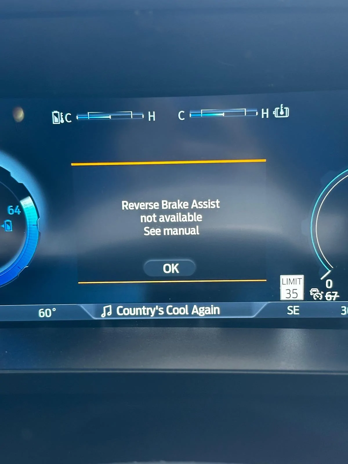

Anyone else get this? I’ve been getting it awhile now and it occurs about 50% of the time I go in reverse. I don’t really notice a difference in backing up.

from Page 242:
SWITCHING REVERSE BRAKING ASSIST ON AND OFF - VEHICLES WITH: 15 INCH SCREEN 1. Access the vehicle drawer on the touchscreen. 2. Press SETTINGS. 3. Press Driver Assistance. 4. Switch Reverse Brake Assist on or off.
Note: The system is unavailable when the rear parking aid, cross traffic alert or traction control is off.
Note: If your vehicle is not equipped with cross traffic alert the reverse braking assist relies on input from the rear parking aid and rear camera sensors. Note: The default setting is on in some regions.

Are the sensors or cameras soiled with mud or other debris ?

Mine does this all the time too. Perfectly clean SoCal truck. No weather. No cold temps.

mine does this everytime the tailgate is down and im doing truck stuff. makes sense then though.

Brake Assist....
Wait for the vehicle to finish booting up before shifting to reverse...
No I have a car wash pass and wash it regularly. Also just washed it yesterday as well.

Brake Assist....
Interesting.. so maybe I'm putting it into reverse too soon? I could see that.

Absolutely.
Yesterday, I noticed two separate occasions where it happened after I stopped somewhere (i.e. gas station), put it in park but didn't turn off the vehicle. Soon as I put it in reverse I got the alert.

This happens to me every single morning now. But I feel like I never saw the message before. I don't have any issues with my parking sensors or rear camera though. So I don't feel like its a hardware issue.
How long should I wait before I unlock and having the system booted up? I usually just jump in and reverse, but the backup camera / sensors don't seem to complain.
I have the 12" screen. But I don't ever recall turning this on or off anywhere. Just never saw the warning messages before.

After reading more on it, I don’t believe it has anything to do with how fast you put it in reverse on startup.
I read somewhere (Reddit I think) that updates can cause it. The fix I seen was to drive on a straight road for 5 mins over 18mph. it’s supposed to recalibrate it. I’m not near any road that is straight enough to see if that would work.
I had my 30k mile maintenance recently and I mentioned it to them. They didn’t specifically say if they fixed it but I don’t recall seeing it since.
