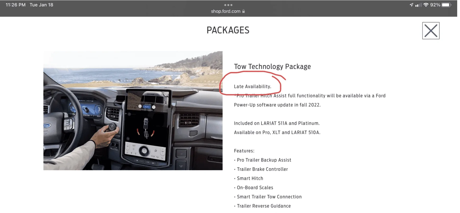

Hi;
came across this thread.
I have a 23 XLT with the trailer package - I guess. I have the option with less features. This might be totally beside the point for 22s, but I was interested in the hitch assist pro as well. I researched parts first (tasca.com) and then just popped the blank panel off the dashboard. I have wiring in place for the button, so it cost me around $105 for the button, the bezel around it and S&H. I have a Momgo

Hi;
I did see the
FOr you it would be more involved.. You have to add pro trailer back up first.. That involves replacing the AIRBAG module(RCM)
Not that hard to do but some people freak out over that stuff
Once you have the correct RCM you can add the TRM(Trailer module) and make the appropriate changes.
Adding just that button wont do much
