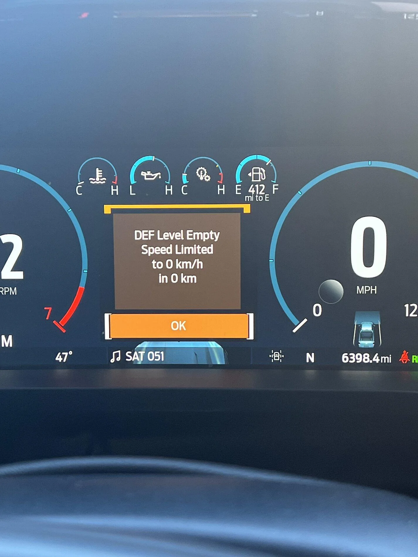

After the most recent software update. I have had several issues with my truck. Most recently alarm is very sensitive and now it keeps showing my DEF level is low, however I have a powerboost so that’s not an issue. Many times on startup the screen falshes multiple system errors before moving to the built ford touch screen. Anyone else’s having similar issues, Or suggestions?

All you can do is get it into the dealership so they can plug it in and see what soft and hard codes might be there. I had issues with multiple error messages and not going ready. After 4 months Ford finally replaced the drive unit

Thanks. Appreciate that! For the most part updates aren’t bad. I also have auto updates turned on, which by default I believe is off.

Thank you. I figured that was going to be the end result, but was also curious, if anyone else was having this issue.
