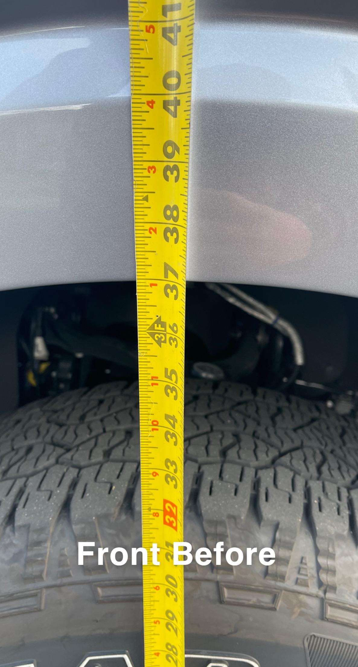

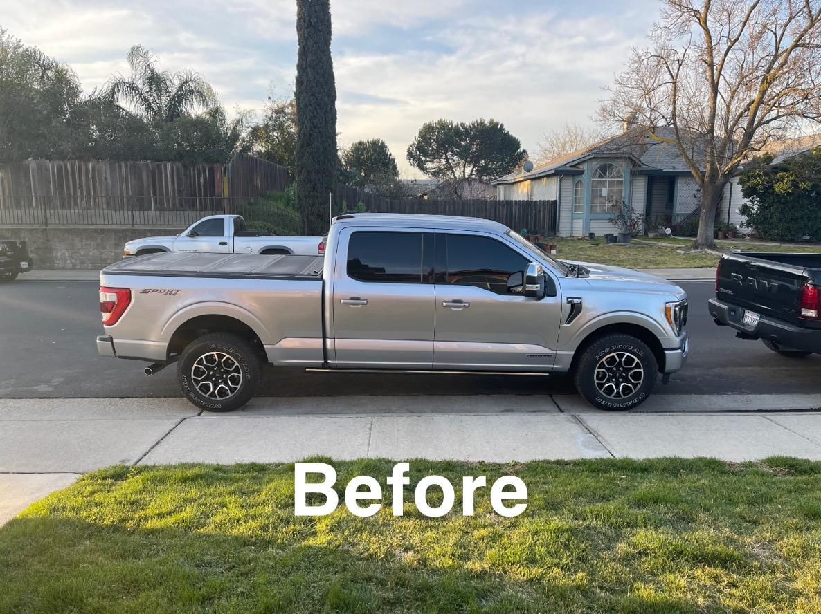

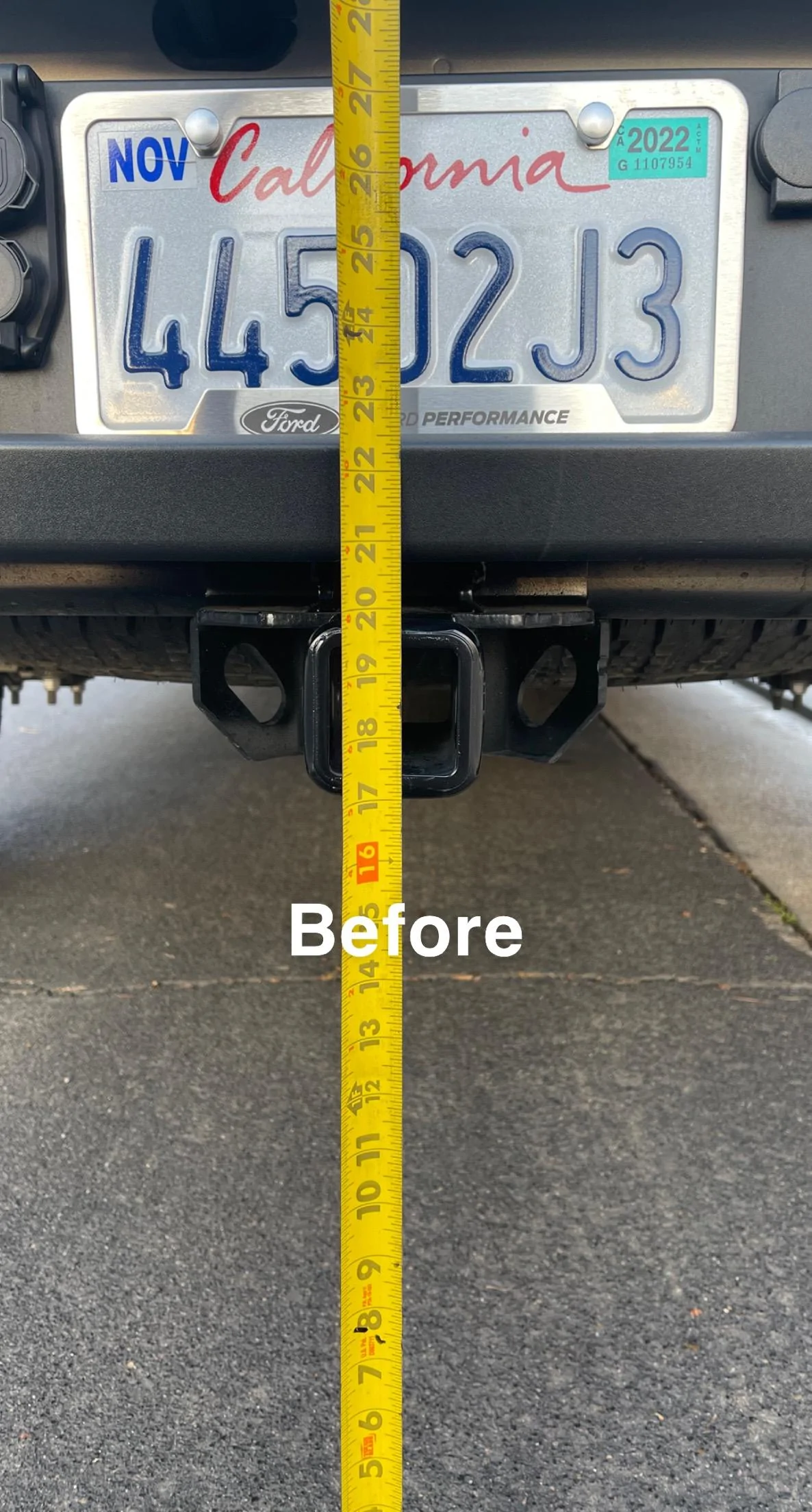

Well, Today is the day folks. I pulled the trigger and I am having my truck lifted. I am doing the 3.5” ReadyLift SST kit. I am having Les Schwab install it. I will be keeping my stock wheels and tires for now. I have attached some before pictures below. Once the truck is done I will be posting the after pics.

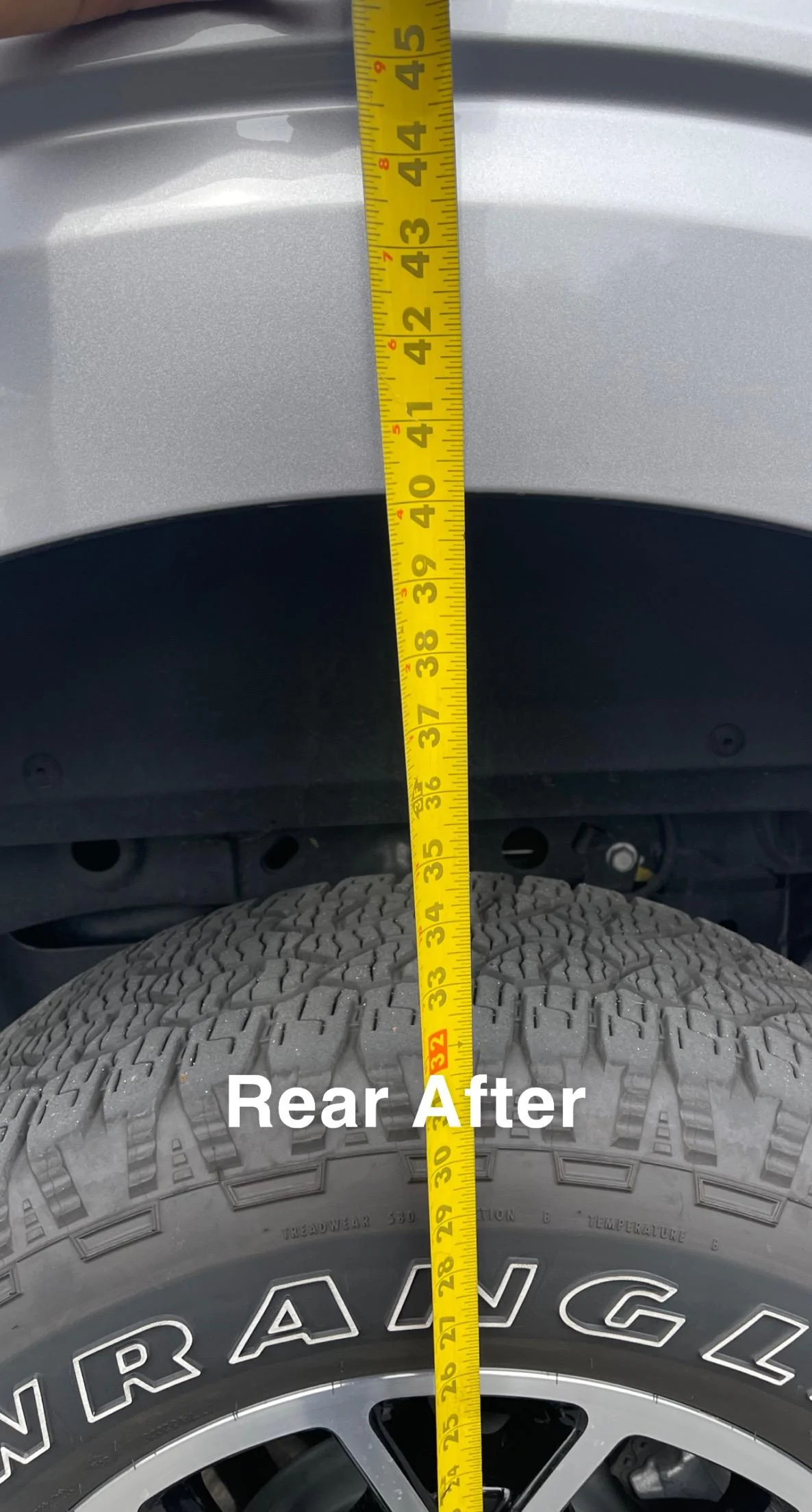

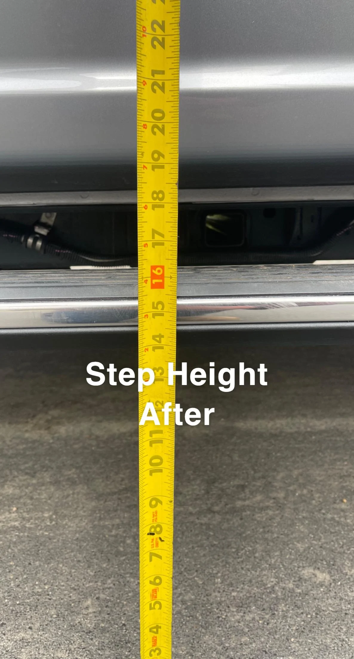

Well, it’s all done and looks great. I ended up not doing the rear lift blocks. I did not want any rake. I prefer the look of it slightly lower in the rear anyways. After the lift it sits about .5” lower in the rear. Again, that’s without doing the rear lift blocks.

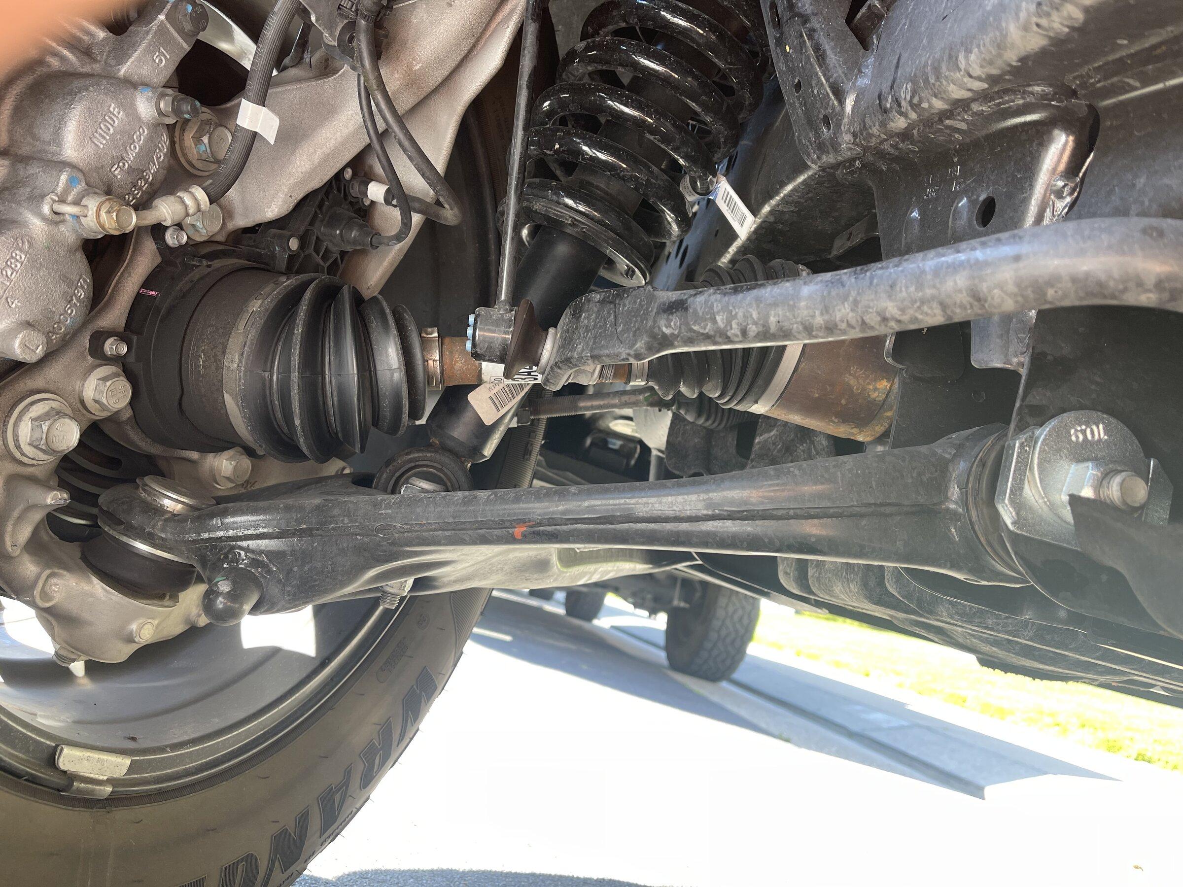

Could you share a picture of your CV angles in the front?

Here you go. CV Angels with Readylift SST 3.5” lift. If you want better pics at a specific angle feel free to ask. 2 pics are both sides and one pic is with the wheel pegged. I have driven the truck for about 1500 ish miles with the lift now. I have used 4H and 4L for off-road/ snow use. I also have used 4A in sport mode. So far no issues or weird noises.
