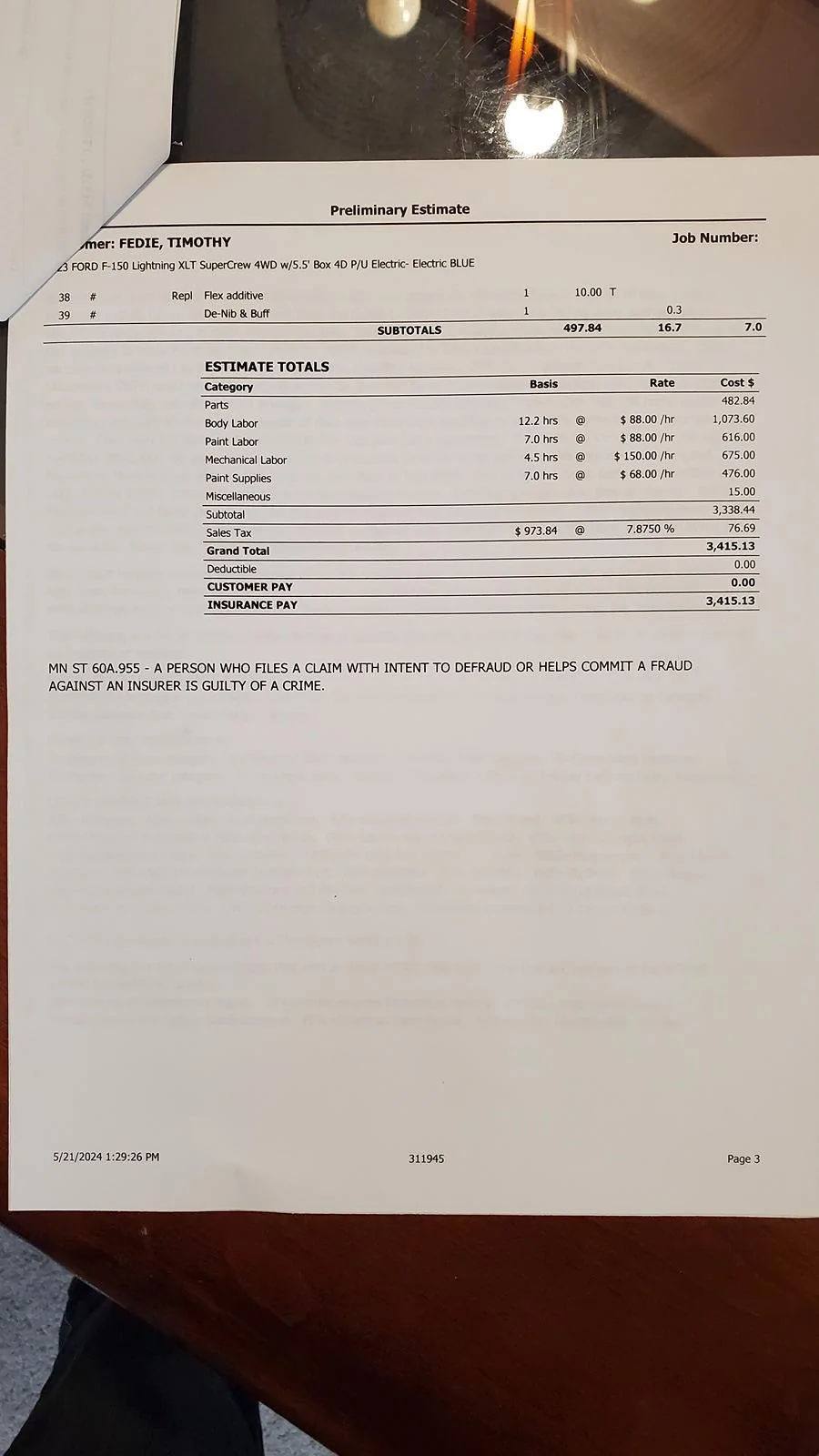

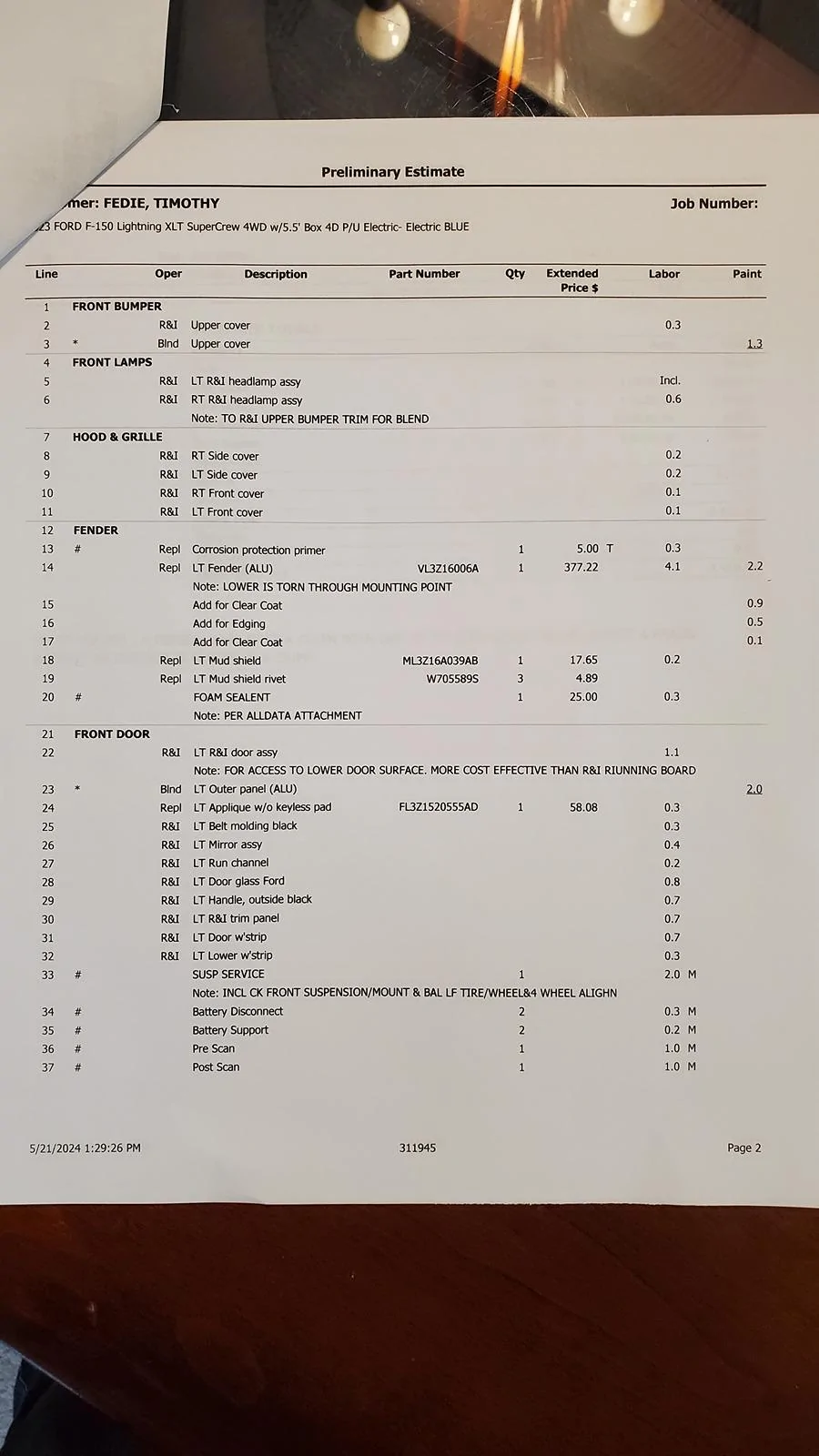

Unfortunately I get to replace the front fender on my Lightning after a young person missed a stop sign and bumped into me going about 5-10 miles per hour. The damage is minimal, but the aluminum fender ended up cracking so they are going to replace it. The total cost to replace it is almost $3,500. I'd figure I would upload the estimate in case someone was interested in what the replacement entails. It is the driver side fender, so I am surprised that there is nothing on the quote regarding the charging port door. Also surprised that they have to take apart the door to get access to the fender. That window sometimes made a weird noise when rolling it down so as a bonus maybe that will go away.

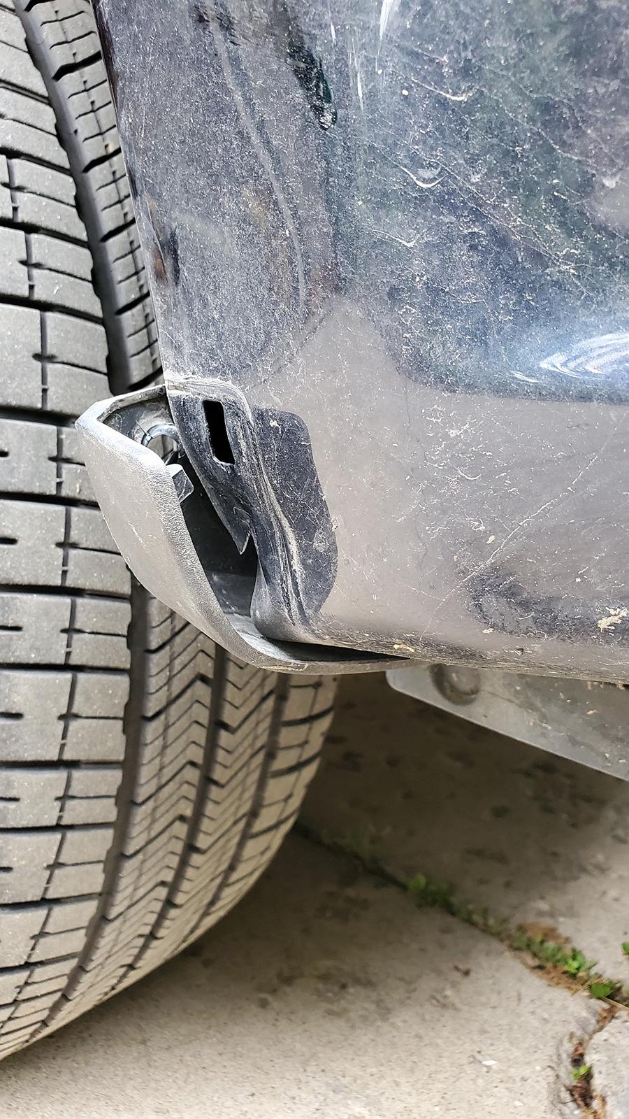

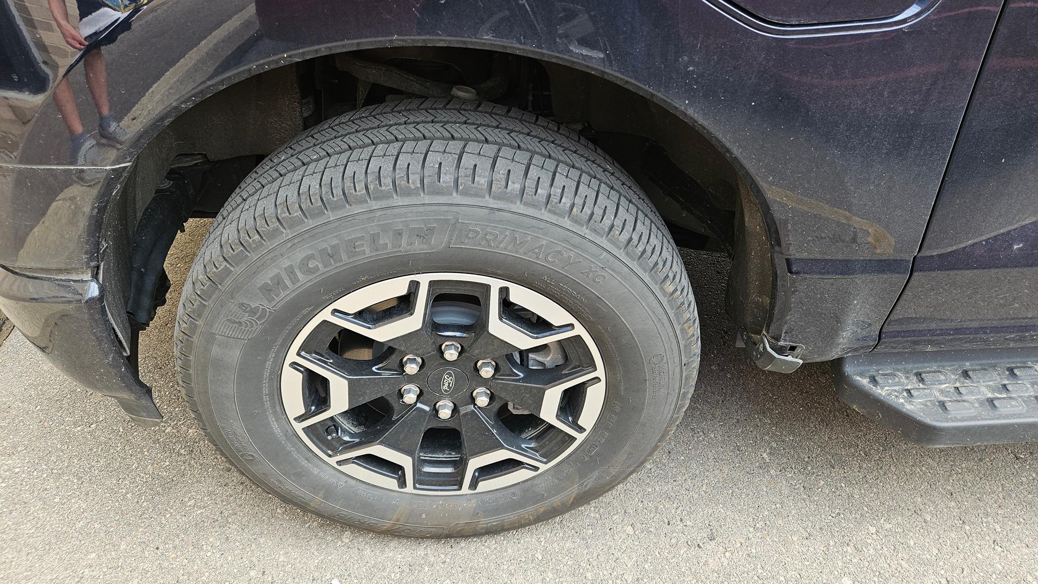

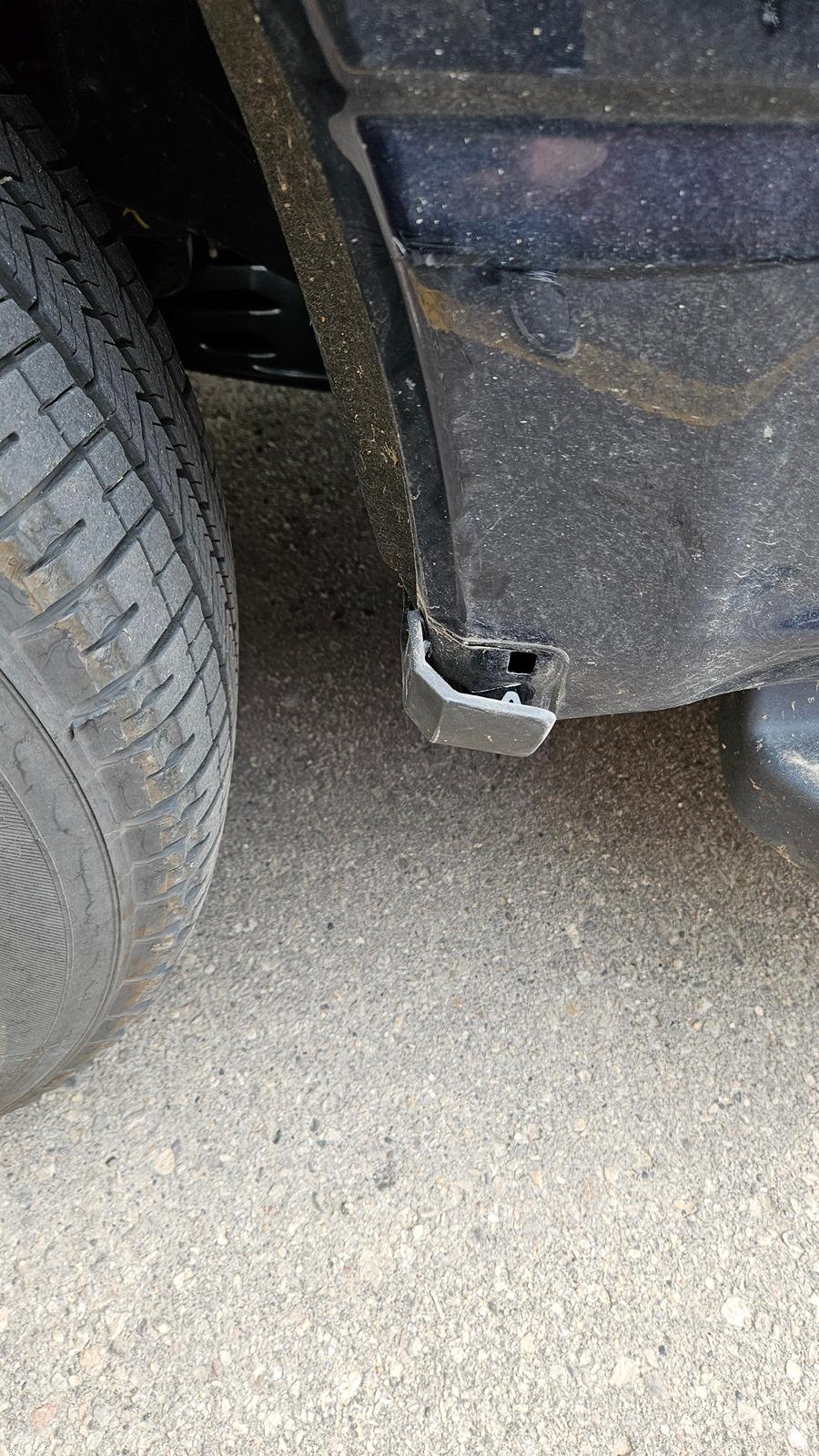

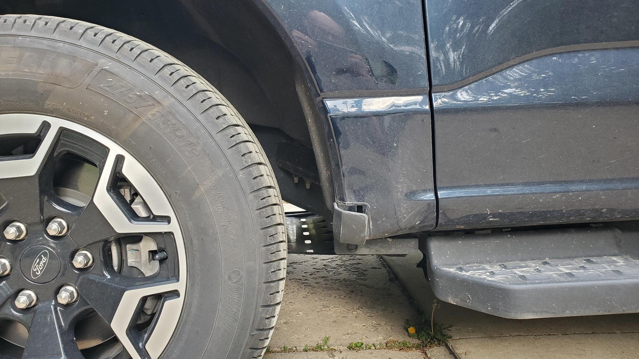

Pics of the truck. You can see the crack on the closeup through one of the mounting holes.

Now I see why my papa told me say no to crack. Cost of the labor alone can kill you. I see why insurance rates are going through the roof.
Would you have it done if it was out of pocket?

Not sure. $3500 is not a drop in a bucket, but this is the first new truck I have ever purchased. I have a cousin that owns a shop a couple hours from me so I might see what he says about hammering it out and welding the crack. It would all be hidden by the plastic trim piece anyway. If that wasn't feasible I would have him paint me a new fender and I would put it on and hope the paint on the rest of the truck hasn't faded noticeably in the one year I have had it.

That's honestly not a bad cost estimate - sure, it seems like a lot for such a small amount of damage - but they're replacing the whole fender - it might help to get a hammer and beat the crap out the of the fender (Careful, don't ding the hood or door!) to make the $3,500 price tag look worthwile. :)
I just noticed there are door parts on your estimate - was that damaged too?

No door damage. My only guess is that they figure they will break the trim around the keypad when they remove it.
