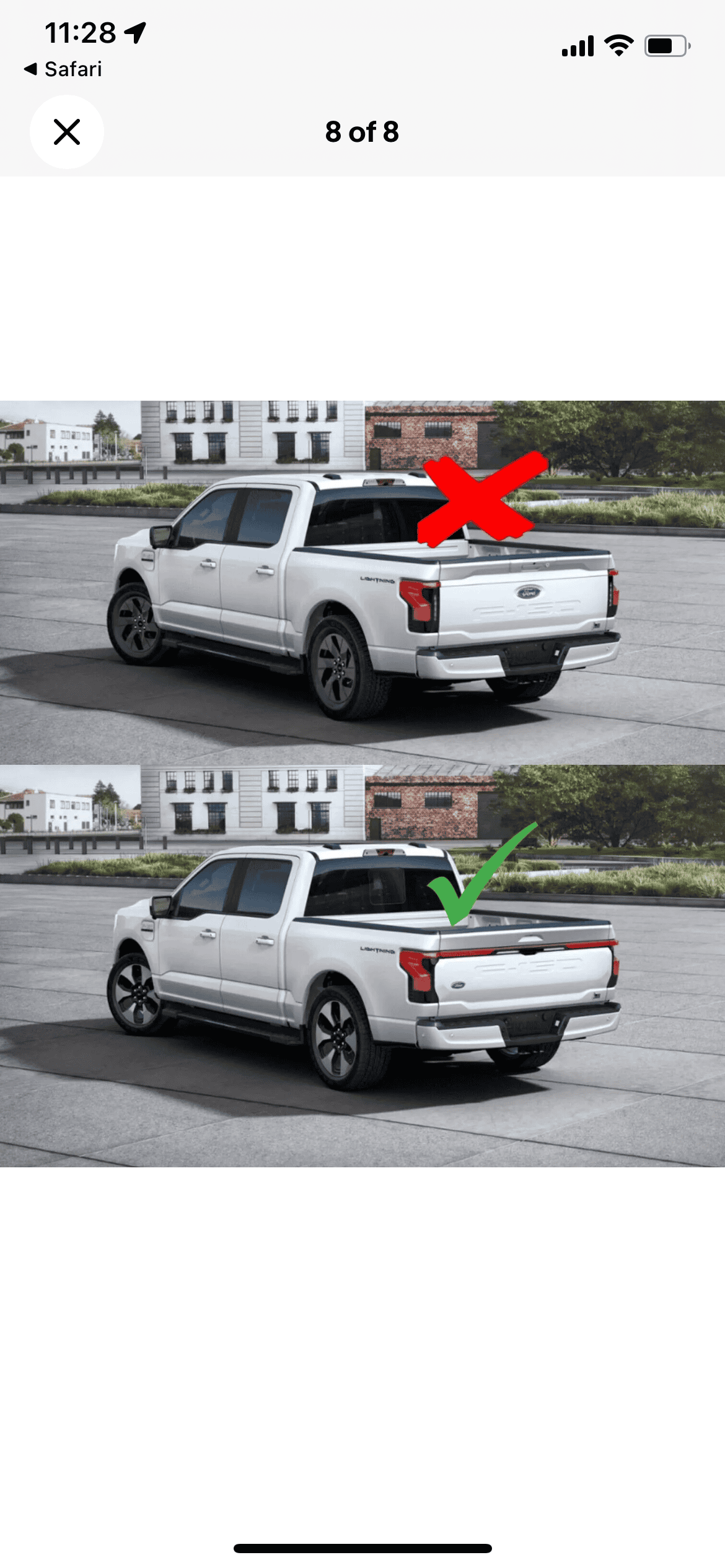

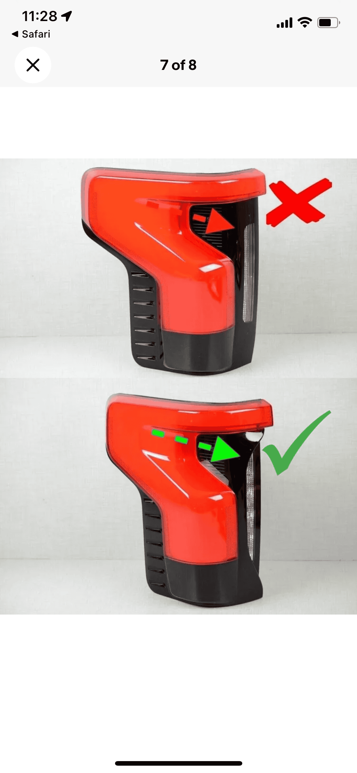

Just remember there are two versions of the tail lights (one for Pro/XLT and one for Lariat Platinum). Some eBay sellers are not doing a good job showing which one. The seller @Blochead21 linked to is very good and shows the difference. I have bought from that seller and recommend.

As mentioned, there are 2 different versions. This one on this eBay listing is for a Pro or XLT.
Pretty sure that's the Lariat version that OP needs. It has the trapezoidal backup lamp.

It’s clearly shown in the listing.
Second thought, I think you’re right. Good catch.

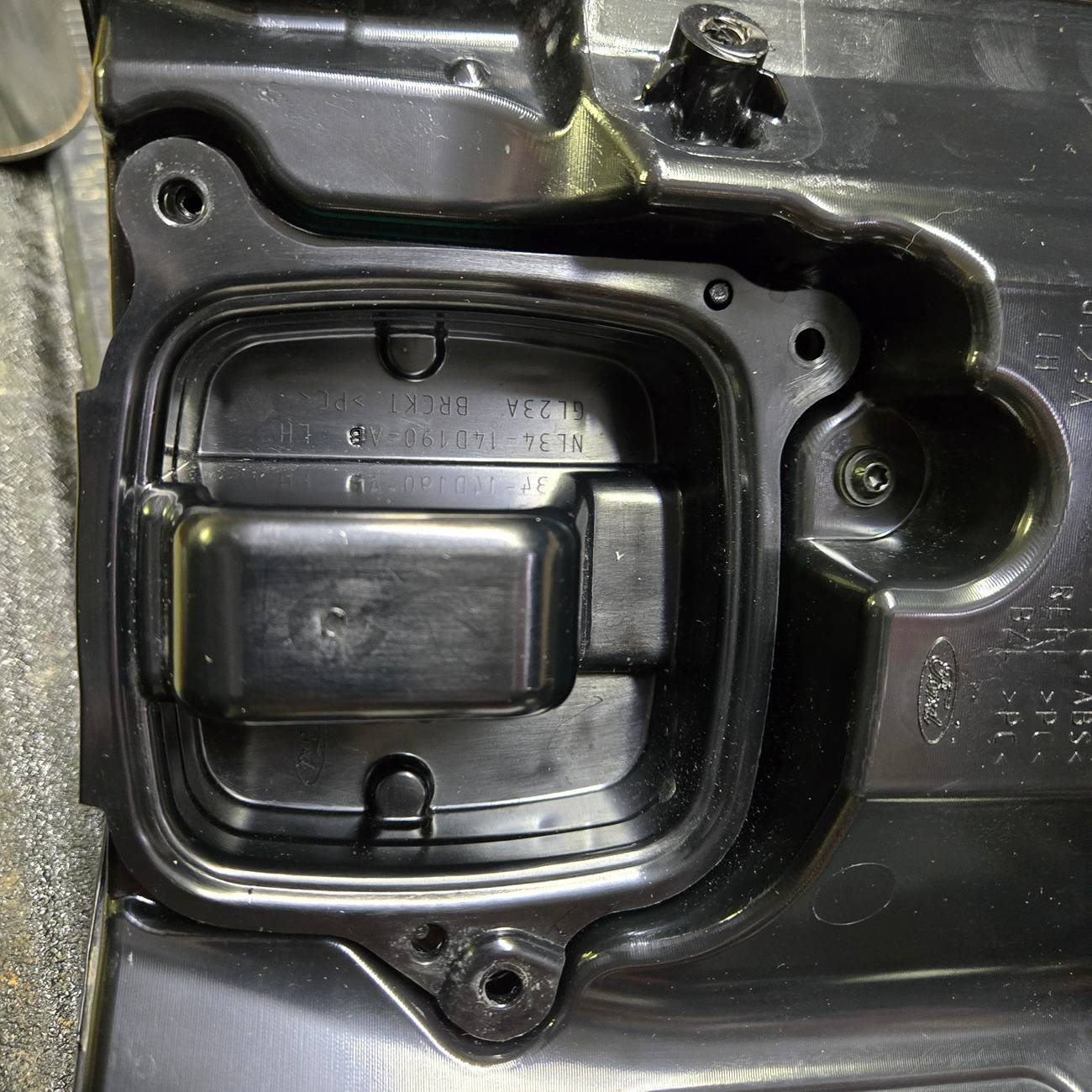

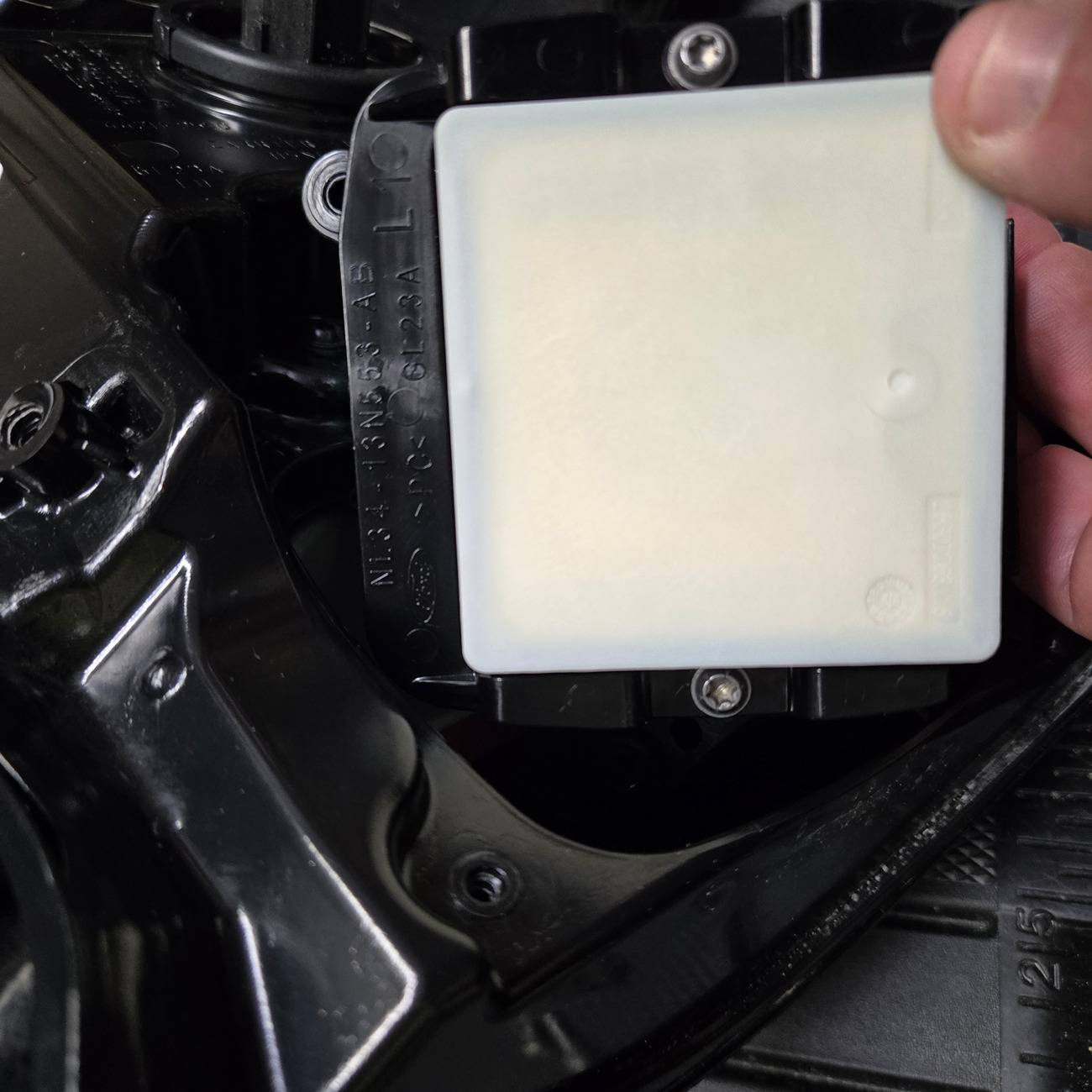

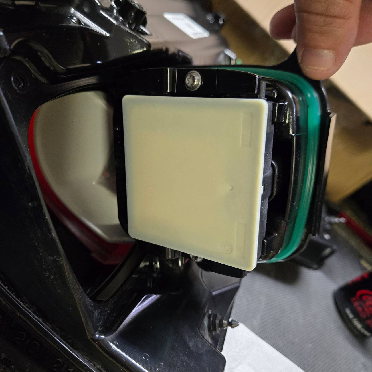

FWIW, I just went through this replacement this afternoon. The BLIS sensor is a bit tricky. three screws remove the housing, but the wiring isn't long enough to fully disengage from the lamp housing, so you need at least two, maybe three, steady hands. One holds the housing, other removes the two torx screws that secure the strap that secures the sensor to the lamps housing.
