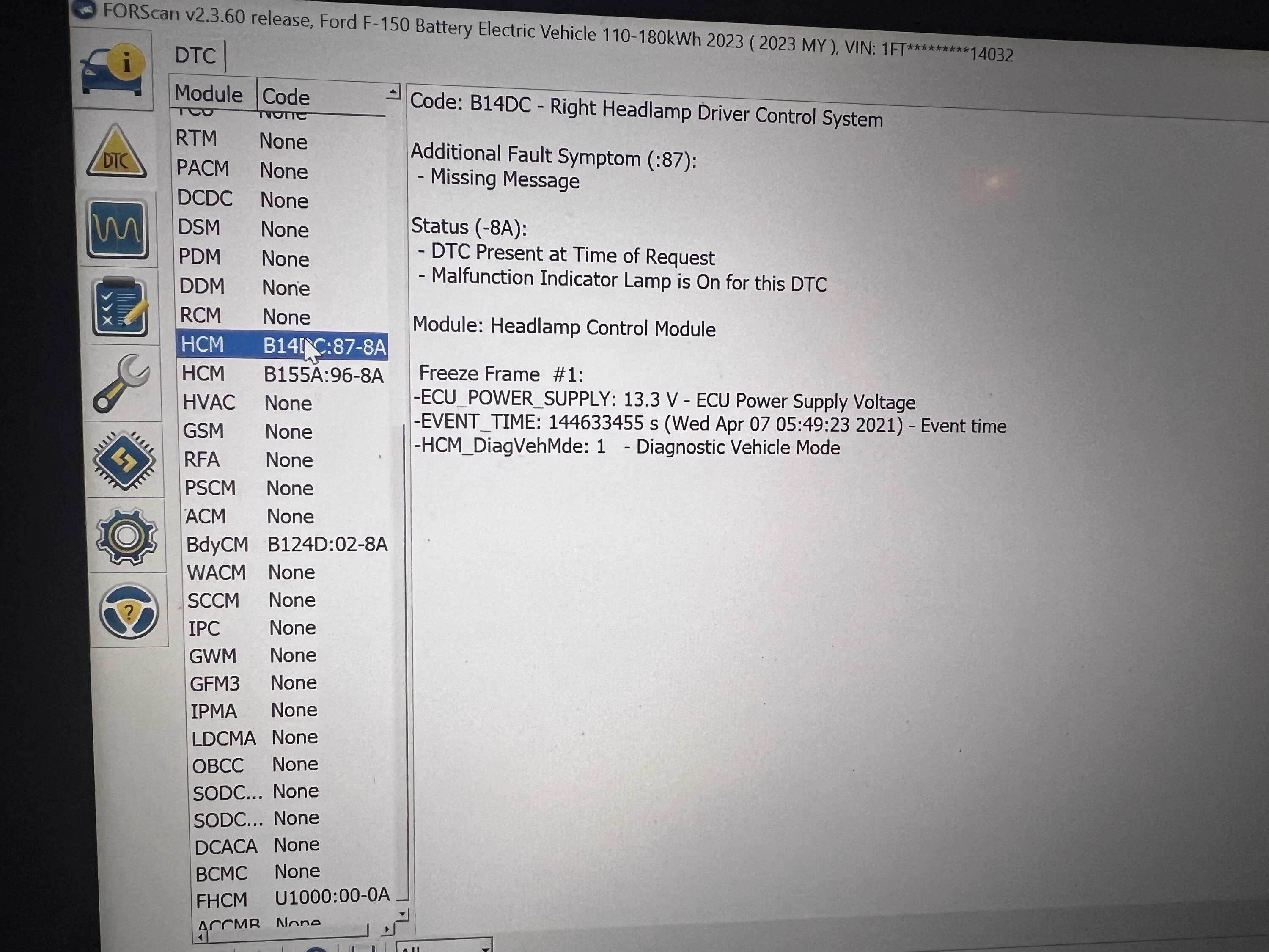

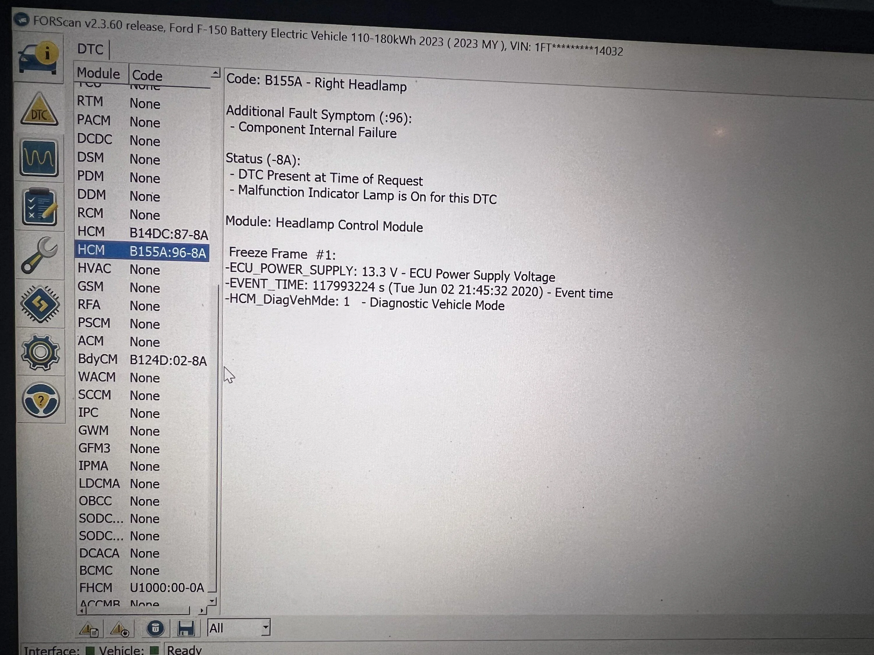

Hello I am facing this two error codes with my f150 lightning 2023 lariat
Any idea on how can I fix them?
Ford F-150 Lightning Right headlight issue IMG_2335
Ford F-150 Lightning Right headlight issue IMG_2336

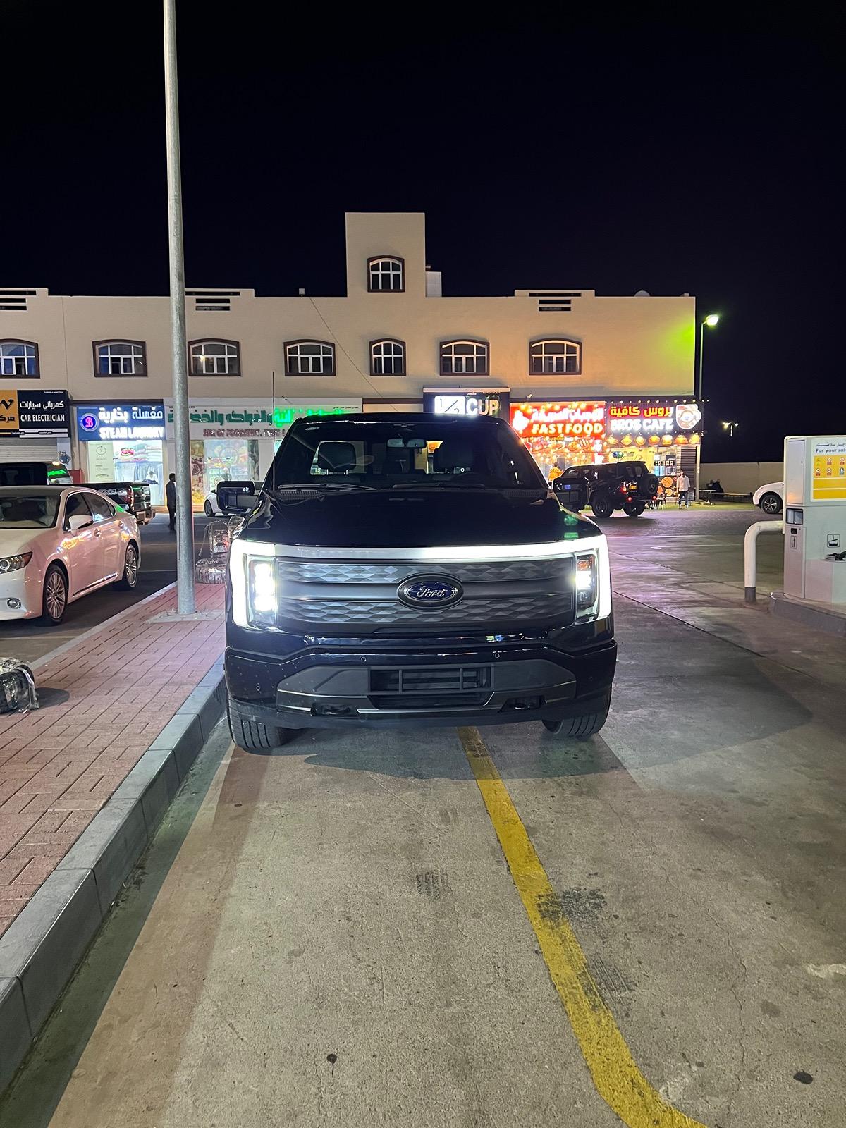

Wrong headlight installed or is it original?

It is original
Ford F-150 Lightning Right headlight issue IMG_2339
It is working but, turn signal doesnt work
Full beam doesnt work
And half of my bar light doesnt work( the side of the headlight i replaced)
