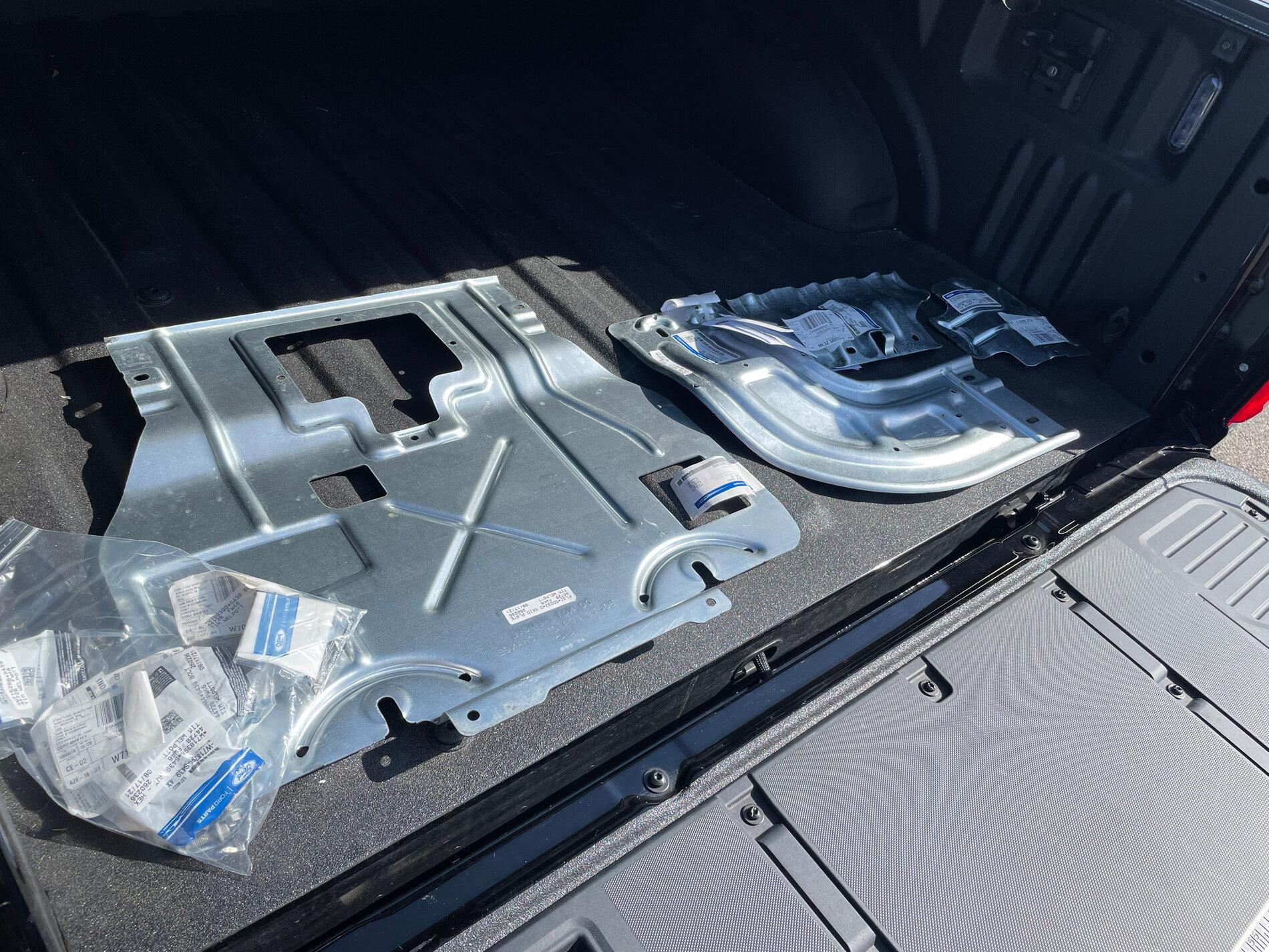

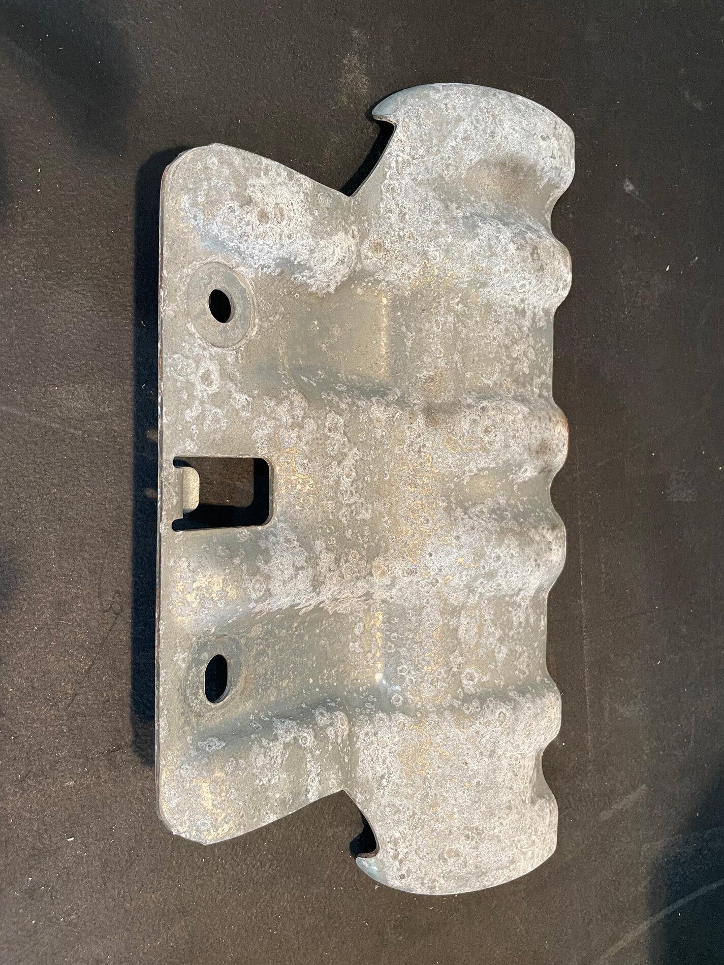

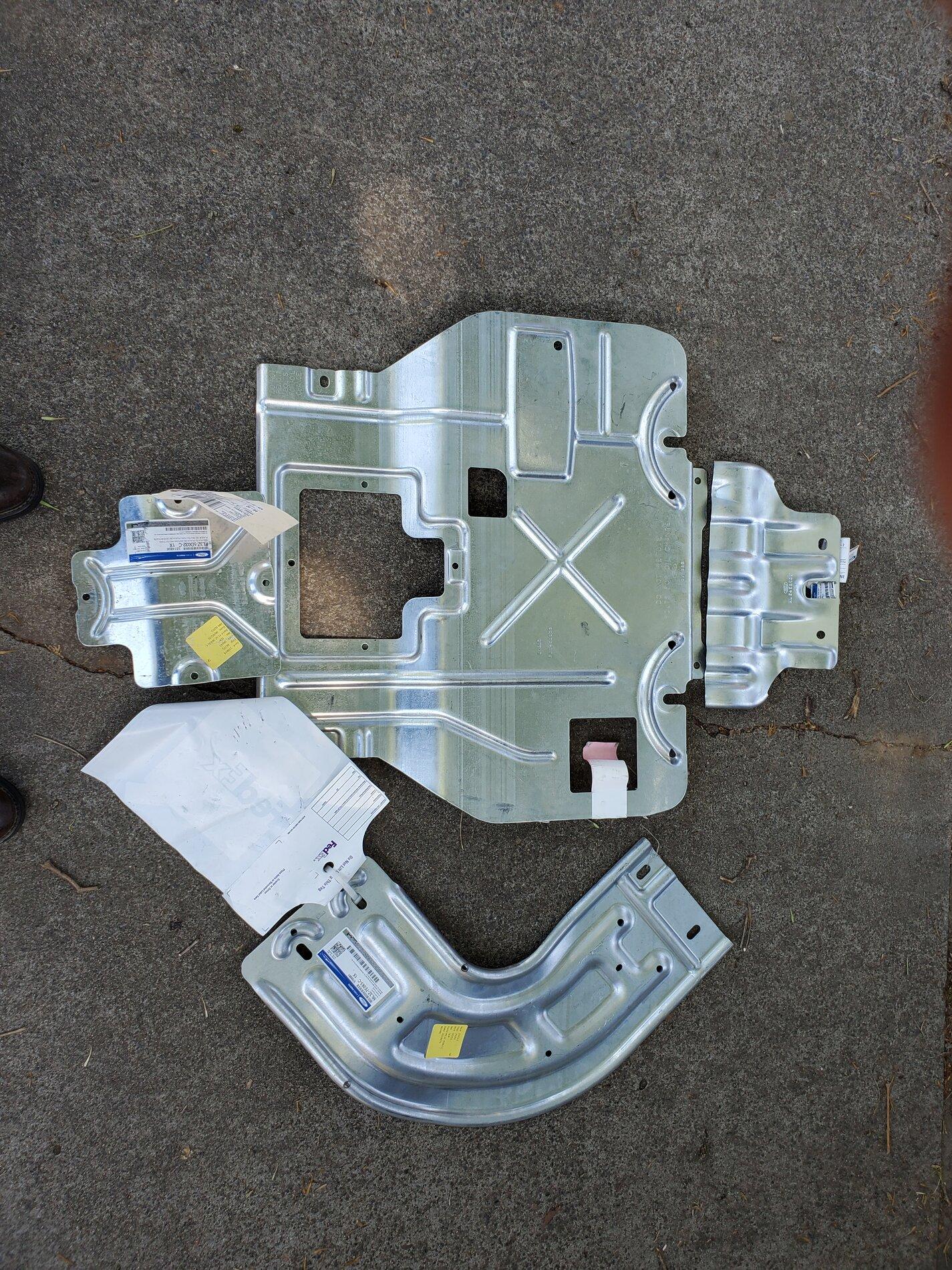

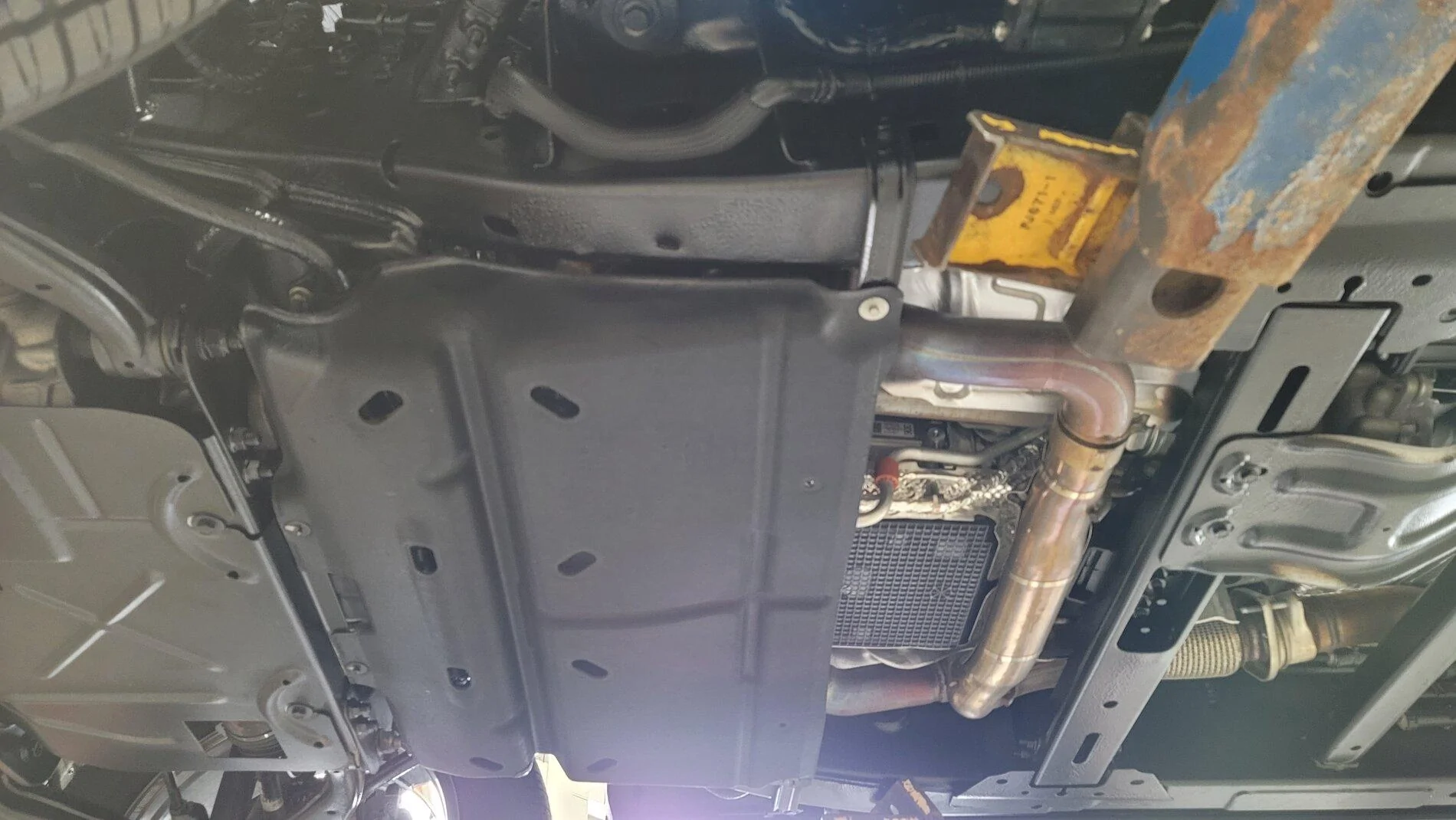

So, here is what I got so far. It looks like my fuel tank has some sort of skid plate (best picture I could do crawling under my car, partial view). And here are the pieces for transfer case, engine/transmission with oil pan cover and then a piece covering radiator and fitting under air dam.
Of course, there are connectors, I.e. nuts, washers, etc. Since the body is steel and the plates are aluminum, there has to be some sort of protection from electrolysis.
Obviously, the after market is not there for hybrids yet. Also the dealers, at least mine, are not real knowledgeable. It has been a very frustrating experience.
If I had ordered an off road package, I suppose this would have been taken care of.

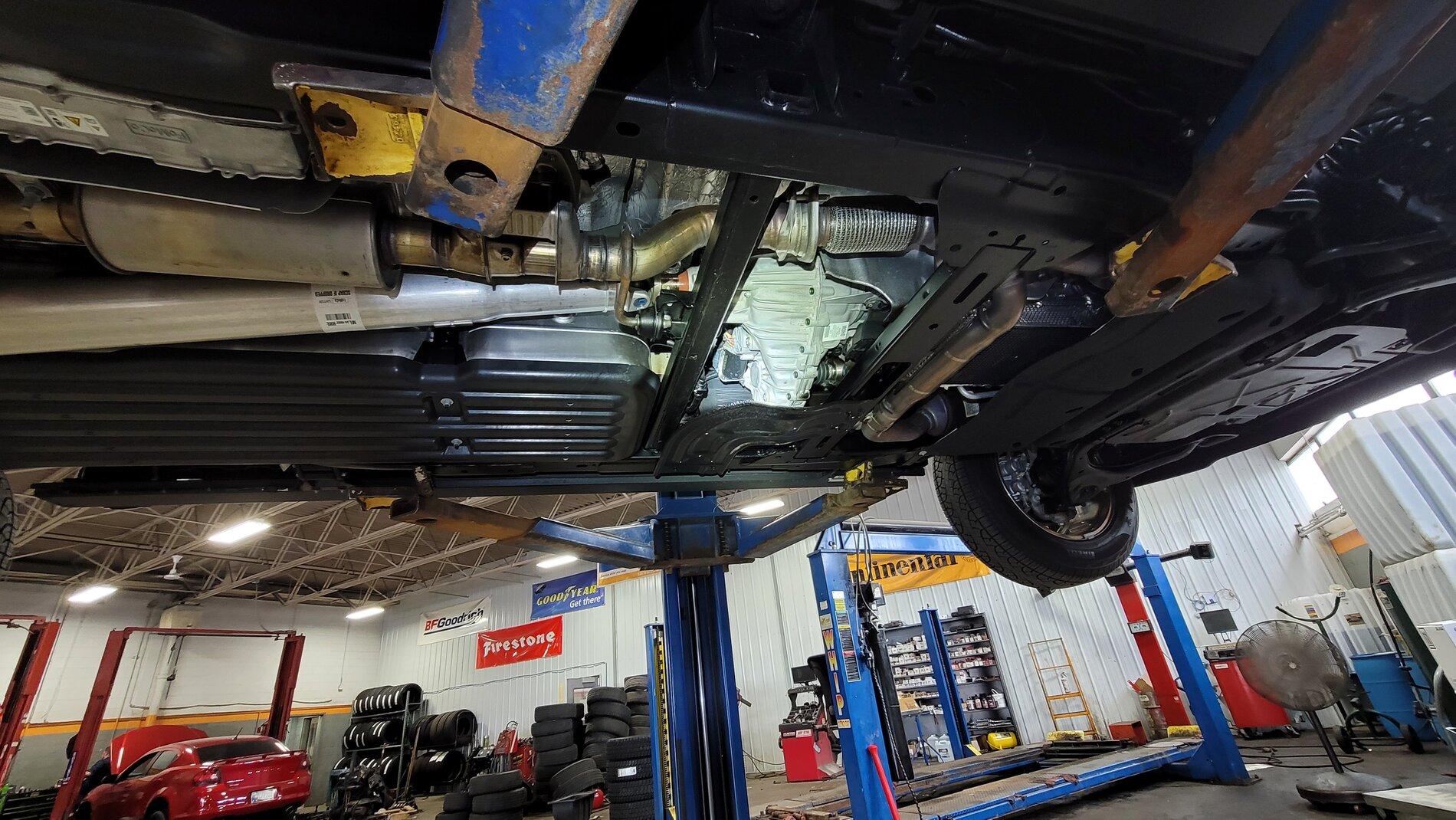

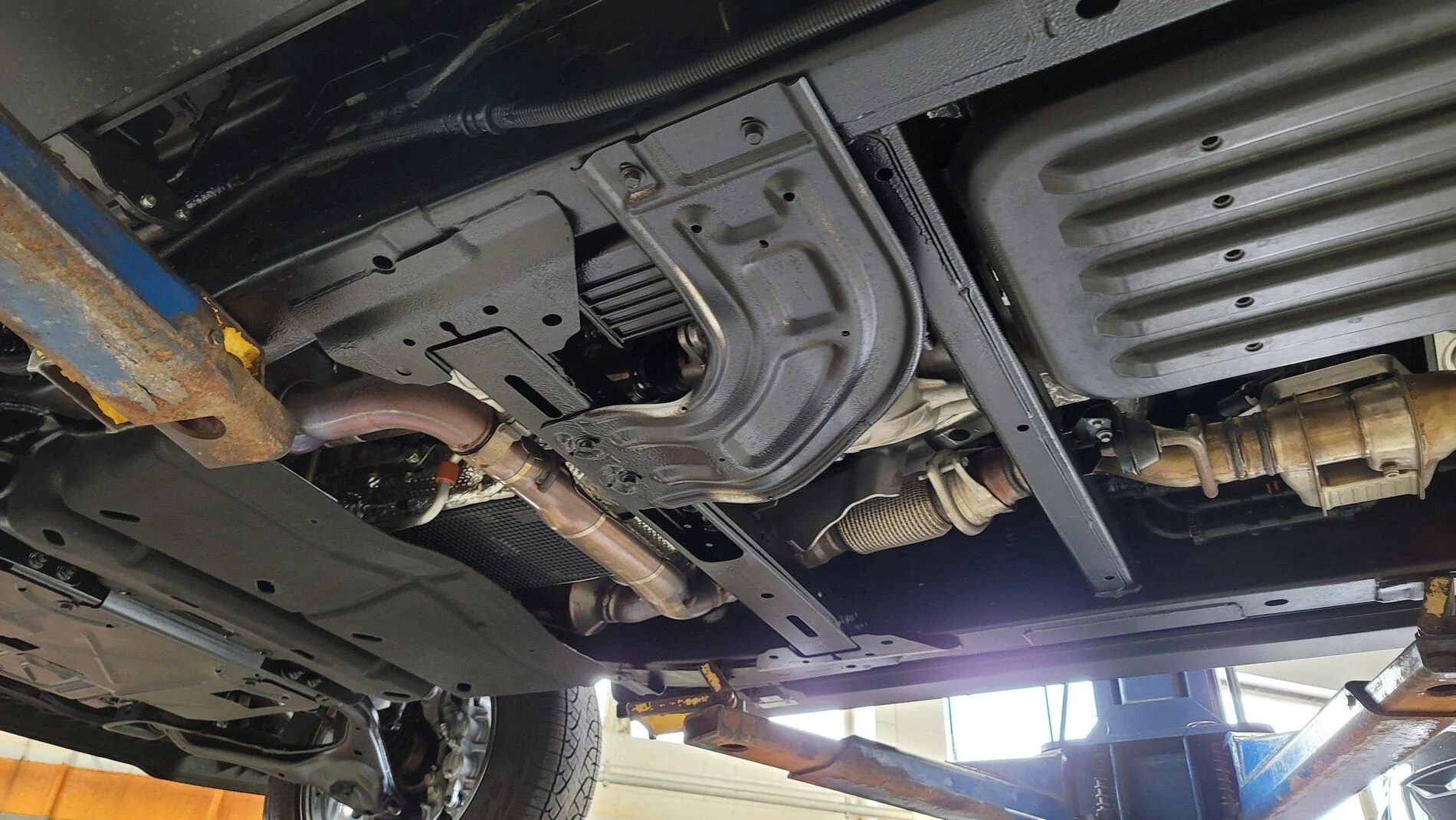

Here is my PowerBoost FX4 from the underside front to back.
Front
Ford F-150 Lightning Skid plates for Hybrid Powerboost 2021 f150? 2021 F150 Undercoating 2
Middle
Ford F-150 Lightning Skid plates for Hybrid Powerboost 2021 f150? 2021 F150 Undercoating 1
Back
Ford F-150 Lightning Skid plates for Hybrid Powerboost 2021 f150? 2021 F150 Undercoating 3

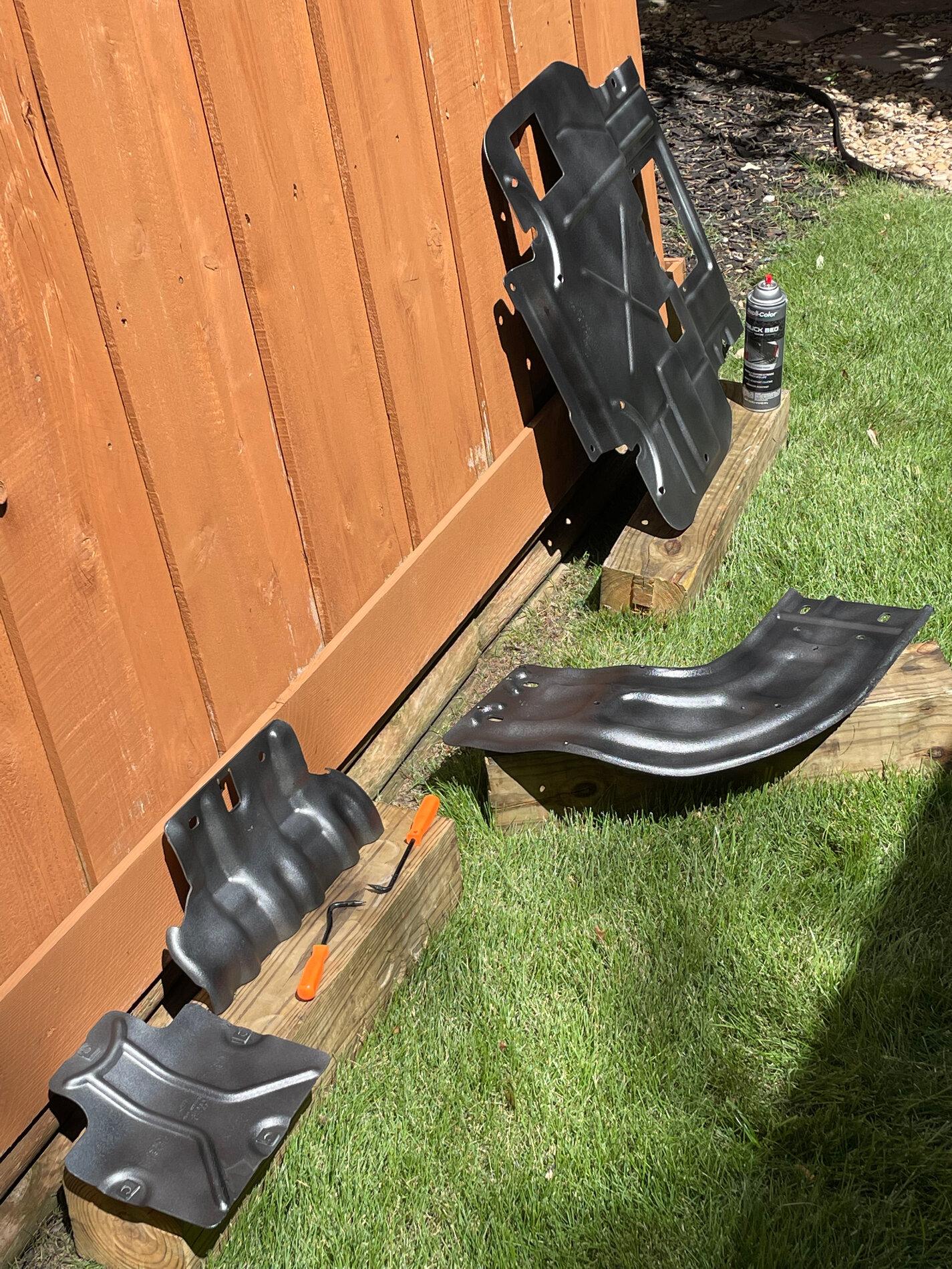

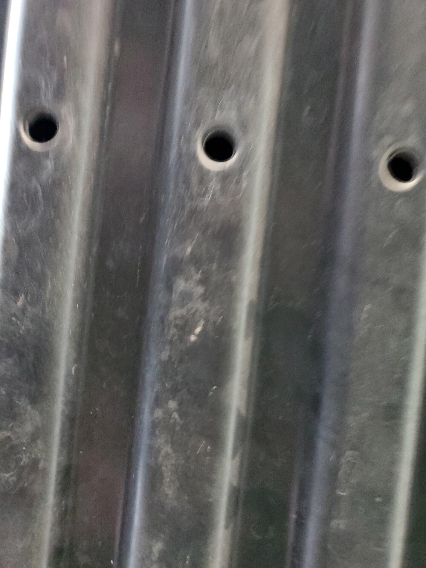

Thank you for the help with the part numbers and pics. This weekend installed the setup and here are a few hints...
1) Paint or in my case bed line the parts. I have 7500 miles and the front skid on the truck was already beat up. All come unpainted as they do installed from the factory (see pic)
2) Don't buy extra hardware like I did. Told him give me the full setup and he did, reality is you only need the bolts/nuts for the transfer case skid.
3) Don't rebut the front skid, I now have 2. No need to get ML3Z*5D032*A as already on and will discard.
4) The engine skid goes OVER the bolts on the Trans cover. Simply loosen the back engine skid bolts, slide the cover into the slots and tighten up. Very clever engineers not making you take the black mid cover off.
5) remove the capture nuts from the skid not used in the front and on top of rear attachment point for the original engine cover. If not, without a bolt in them they will rattle. Pry them off with a screwdriver.
Good addition. Easy install, only wish I had the hints so thought would post here.
