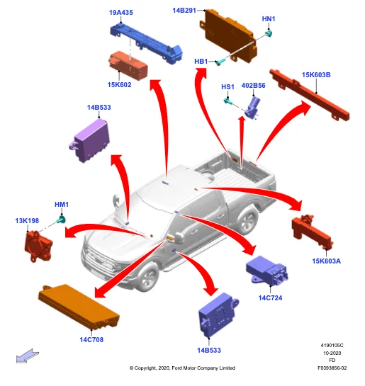

https://parts.ford.com/shop/en/us/electrical/switches/headlamp-levelling-control-act-13292675-1
Ford F-150 Lightning Swapping headlights from reflector to projector LED headlights? Screen Shot 2021-03-17 at 4.15.34 PM
Looks like there's a number of components required to make the LED "bending" headlamps work.

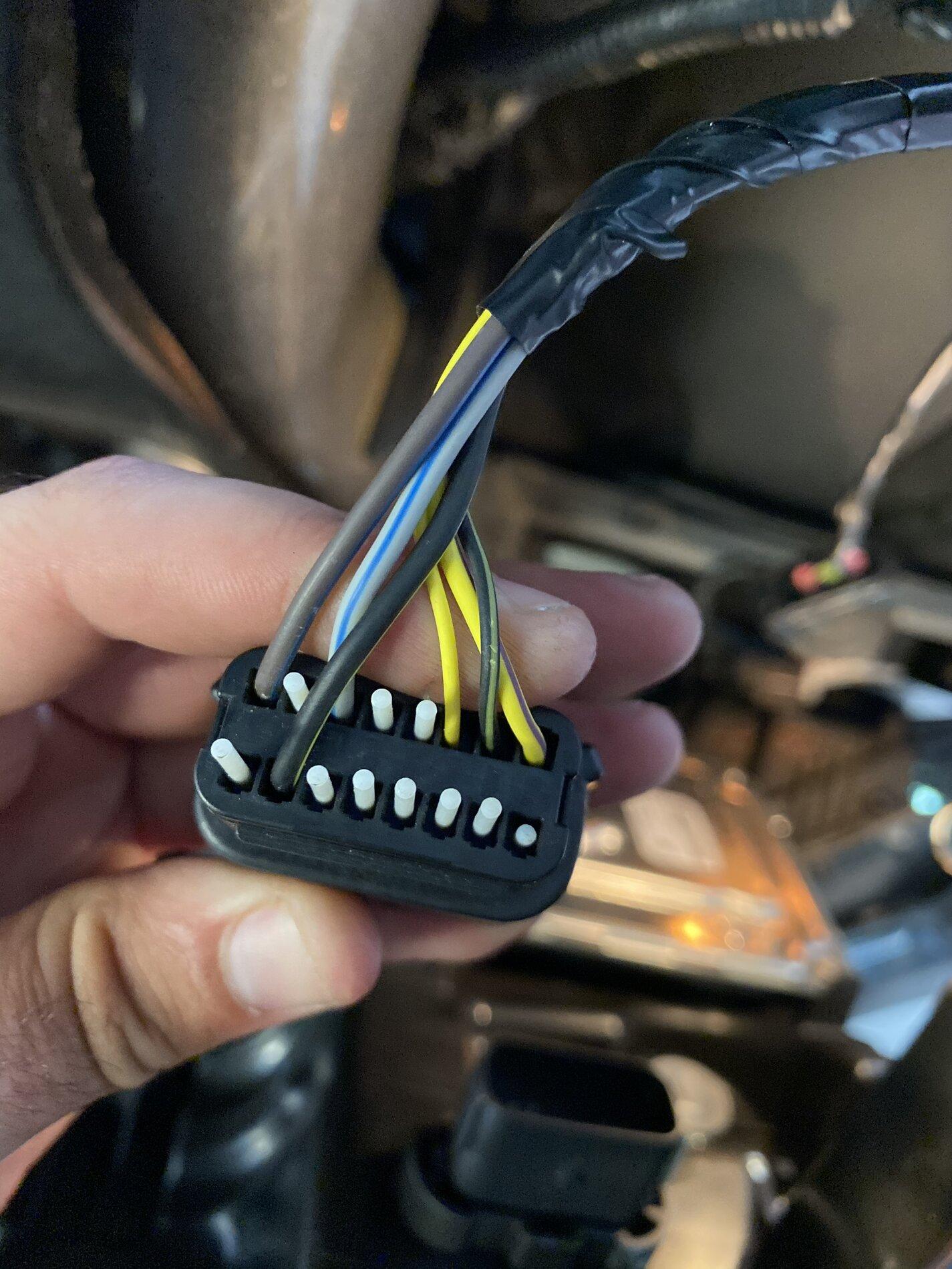

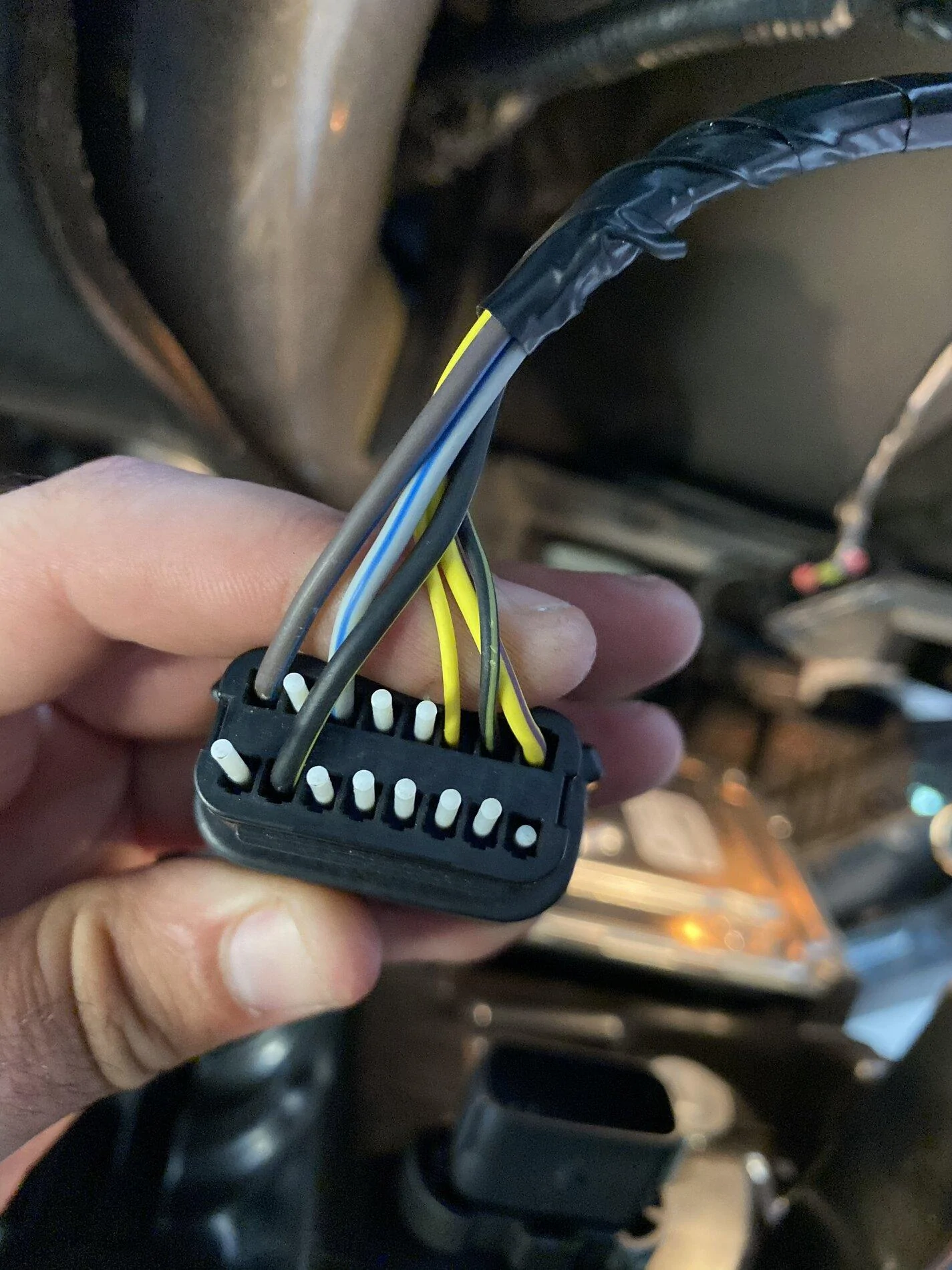

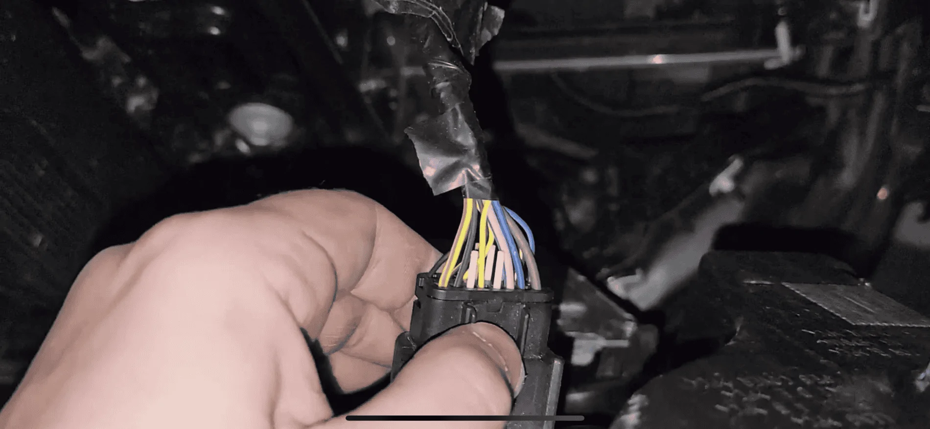

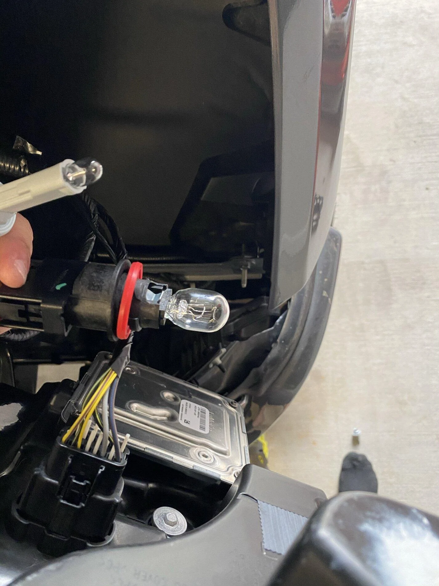

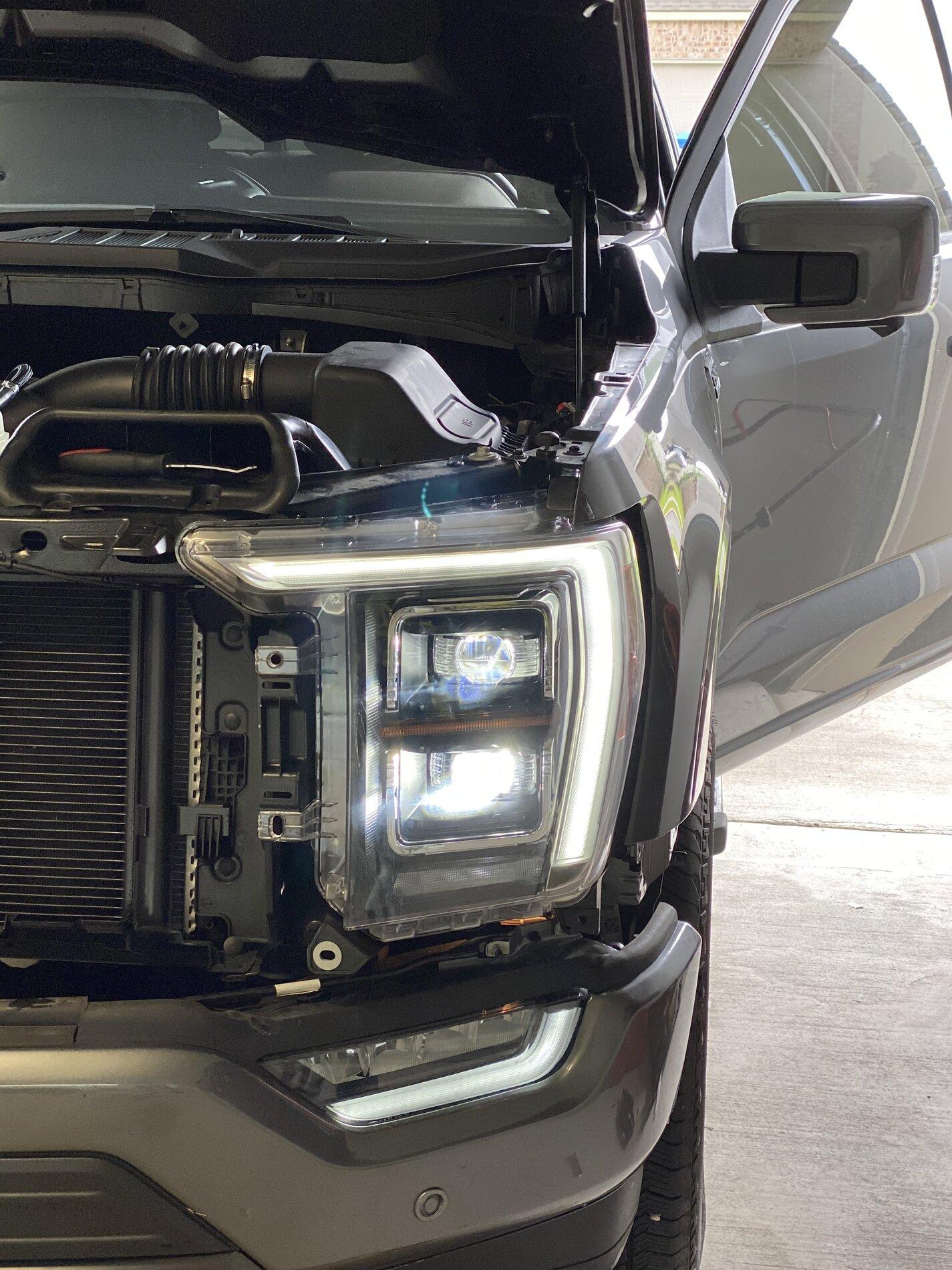

I tried this swap yesterday. I have LED reflectors want the projectors would even be fine without the bending feature just love the look better. Few things to note. Standard LED REFLECTORS have 3 plugs from the harness. As the LED projectors have one central plug on the back of the headlight. The pins are also different between that main plug. I can plug them up, headlights work and daytime running lights turn on. Side markers, turn signals and high beams don’t work. The photo of the connector with less wires coming out are the reflectors and one with more are the projectors. If anyone makes/can make a harness to make these work would be wonderful lol. I assume the turn signals and side markers don’t work because there’s no where to plug them in from the reflectors harness and pins are different/ missing on the harness for the reflectors to produce that ability in the headlight. Also there’s TONS of wires inside the actual headlight itself on the Projectors. (See photos). Didn’t want to short anything out so no way for me to text each wire to know what wire/pin location to add to my existing harness to give them power.
