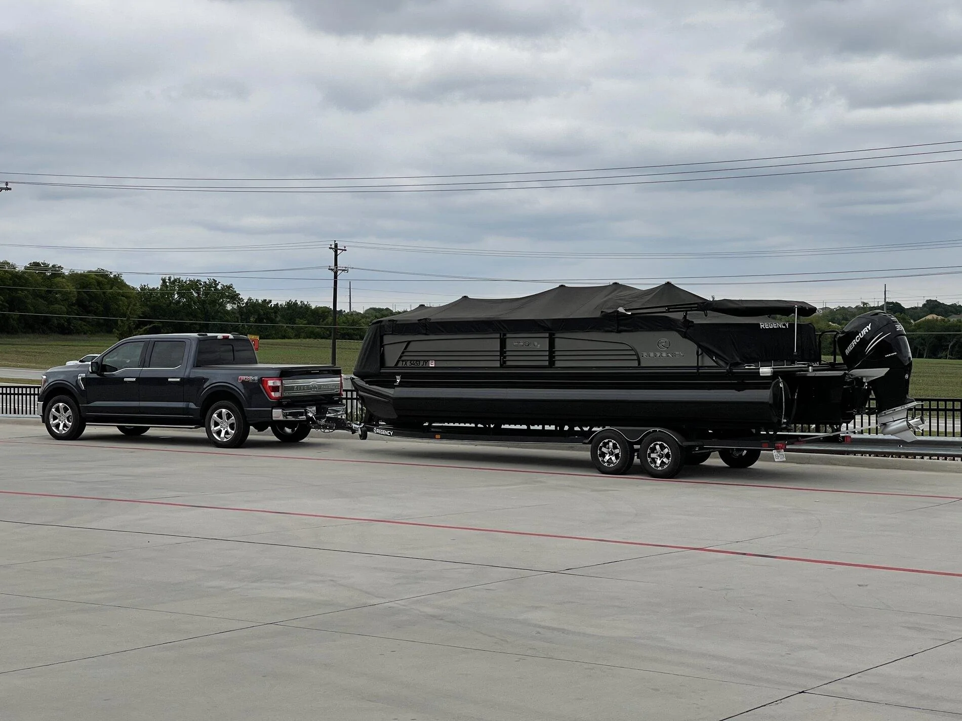

This truck handles my tritoon so much better than my 2017 Nissan Titan. The Titan Platinum Reserve rear suspension sagged. This truck sits level and feels so much better on the road.

Looks amazing! Would love to know what your setup is for hitch...
Shawn
Feb 14, 2021
2021 Ford F-150 King Ranch 4x4 Ecoboost 3.5L
@meyer_22 I’m using a ball mount with a 2” drop. Since this photo was taken I have flipped it which gives about a 1” rise to help the boat ride more level. The boat trailer has a surge brake so I haven’t bothered with a weight distributing hitch. I do have the Max Tow package.

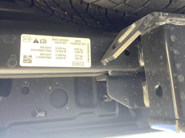

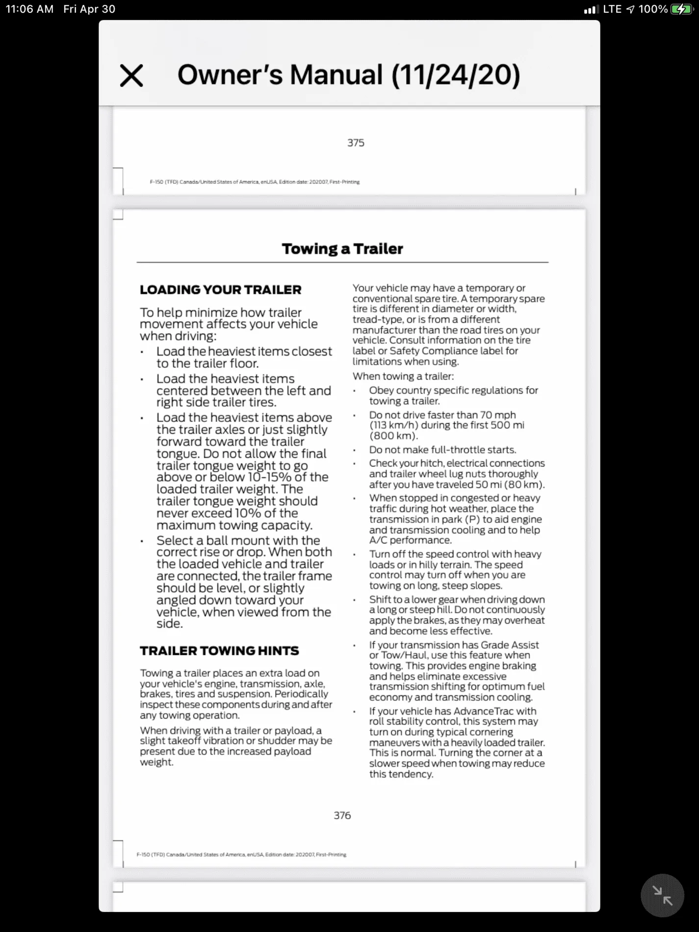

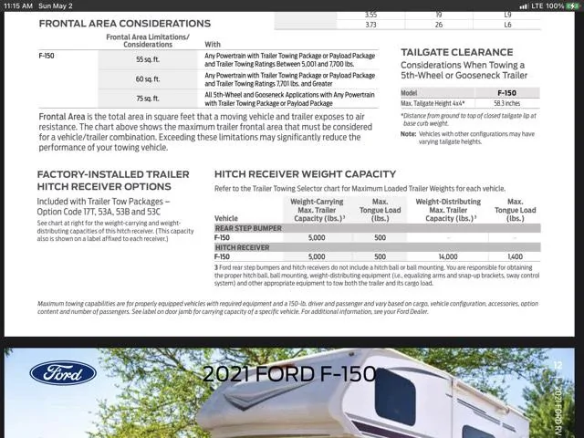

I’m currently looking into getting a double axle trailer for my truck. Reading the manual, I can’t find anything mentioning a weight distributing hitch being required, or even anything with a tongue weight limit other than on this page. With a class 4 hitch, some manufacturers allow up to 1,000lbs of tongue weight.
I know in some manuals and even stickered on some hitches is a 500lb limit, with 800lbs weight distributing but apparently that’s for what’s called a Class III/IV hitch.
I have the Max Tow and HDPP, so my GVWR is 7850lbs with a GCWR of 18300lbs, Ford’s tow chart lists 13,000lbs as the maximum loaded trailer weight for conventional towing. Then, at the bottom of the page, in the 2021 towing brochure, there is mention of a weight distribution hitch for all factory installed hitches, including the Max Tow option, which is supposed to be a class 4 hitch. Sure enough, there is a sticker on mine, though not exactly obvious unless you crawl underneath.

So does this mean that the factory installed Class IV hitch on Max Tow isn’t a true Class IV hitch but more of a Class III/IV? It kind of sucks that if you want to tow 6,000lbs, that you have to use a weight distributing hitch to stay kosher, especially since the WD hitch adds 100lbs on its own.

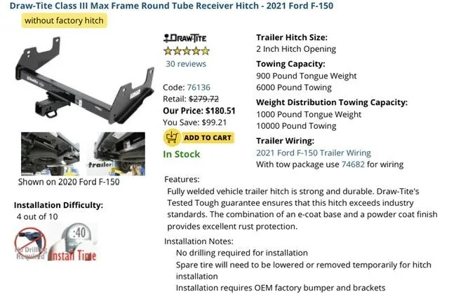

Meanwhile, an aftermarket Class III hitch has a better non WD capacity than the factory “Class IV” hitch:
Ford F-150 Lightning Towing ~7000lb Tritoon/trailer 9E6FFBC3-BE81-4CCE-8261-30EB93F9A352
Just another example of the shell game that is Ford’s payload and tow rating system.

Thanks much. I have a Powerboost Full Hybrid with Max Trailer Tow, and also will be pulling a 26ft Tri-Toon with a 300HP engine. Was interested in whether or not you had the weight distributing hitch or not. Have you used the pro trailer assist, and if so was it a pain to place the sensors on the trailer?
Im also trying to decide what ball mount I get, not sure if I want to go with one with multi positions or just a standard drop and flip like you did if needed...
That seems odd. I need to look at my truck now. My tacoma i just traded in had a 500 lb max tongue weight without WDH. Hard to believe this hitch is rated the same. Anything over 5000 lb for a TT i would use a WDH regardless just because of size. Anderson WDH only weighs 53 lbs and doesn't give you the bulk of the friction bar style as well.
