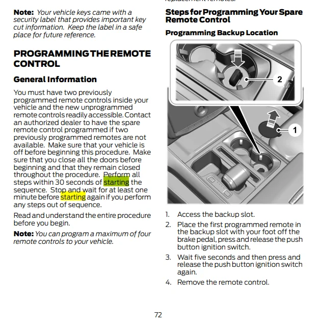

Hmm. Maybe you got a dud? I have done with with multiple AliExpress keys without issue. I also helped another forum member with his (making a 3d printed key card) and I don’t think he had any issues with programming his. I’ve never done a return to AliExpress, but you could try. I’d probably just order another with how cheap they are. Oh, did you make sure to get the right frequency? You can program the wrong frequency, and it will work in your cup holder spot to start the vehicle, but otherwise it will not. See if it starts the vehicle in the cup holder. If it does, this is likely the case. I did this, as well on accident, and I keep that as a backup hidden in the truck. I figure worst case if I lose my key, I can unlock the truck, find this fob, put it in the cup holder spot, and start the truck to get back home. I like this one being in there, because if it is found, it would seem like it is non functional any way. I also husked the pcb from the original fob case and put it in a 3d printed case, so it doesn’t look like a fob if found.
