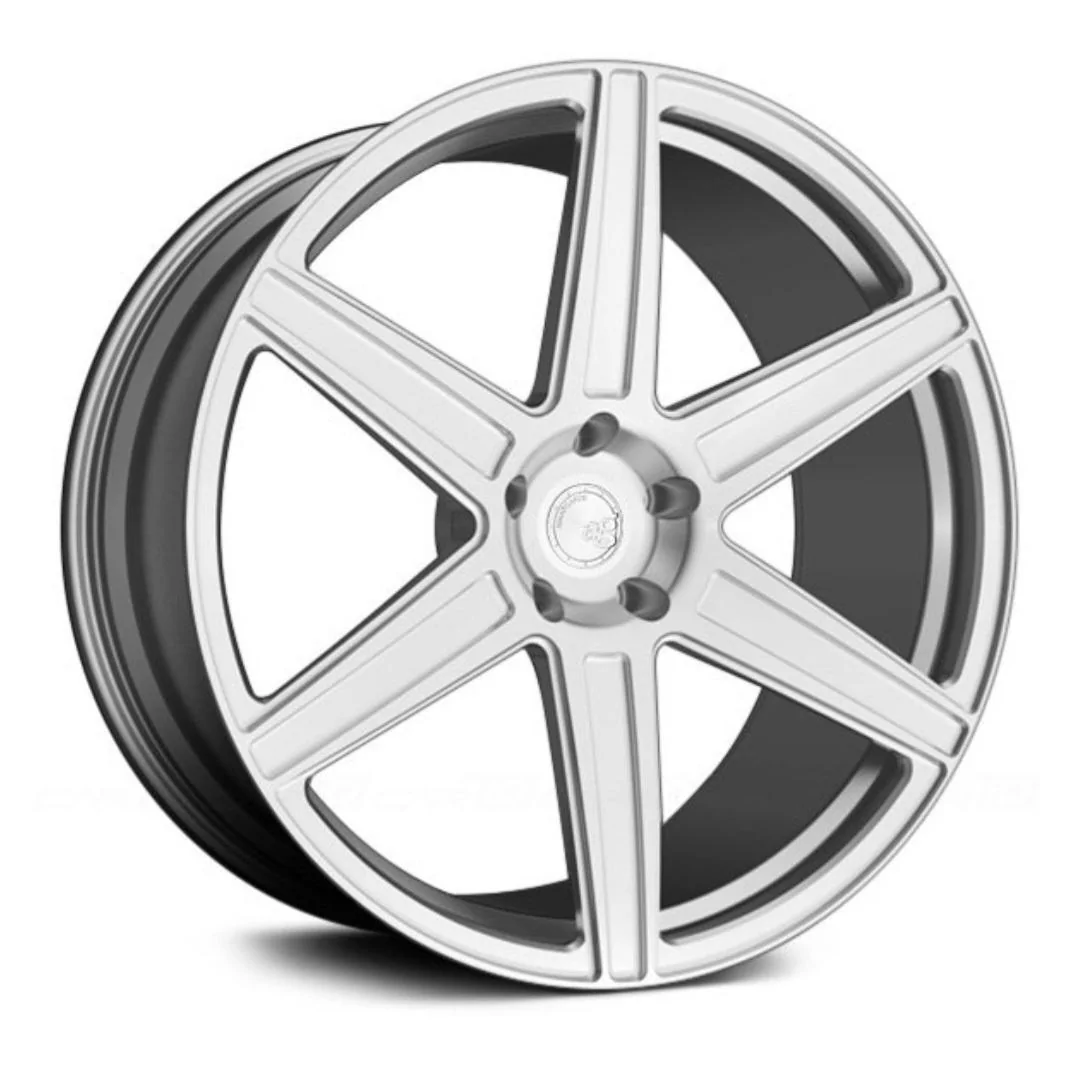

I have a set of wheels ordered for my new platinum Lightning that will hopefully be here in the next few weeks. Has anyone received theirs yet? I really need to get some measurements so I can them to the manufacturer. I'm not a fan of the stock wheels.
Be careful with aftermarket wheels. For one, you will reduce range by a fair amount with a style like that, and second the lightning weights more than an ICE truck so the rims need to be rated a lot higher (the truck is probably close to 2000lbs heavier) and would affect the GVWR of the Lightning.

ER has gawr front 4050, rear 4800, SR is 3750 front, 4900 rear. At least 1/2 gawr is appropriate for wheel load ratings. Aftermarket wheels with load capacity of at least 2450 pounds should be ok. I believe that standard offset is 44mm. Someone please correct me if I am wrong.
