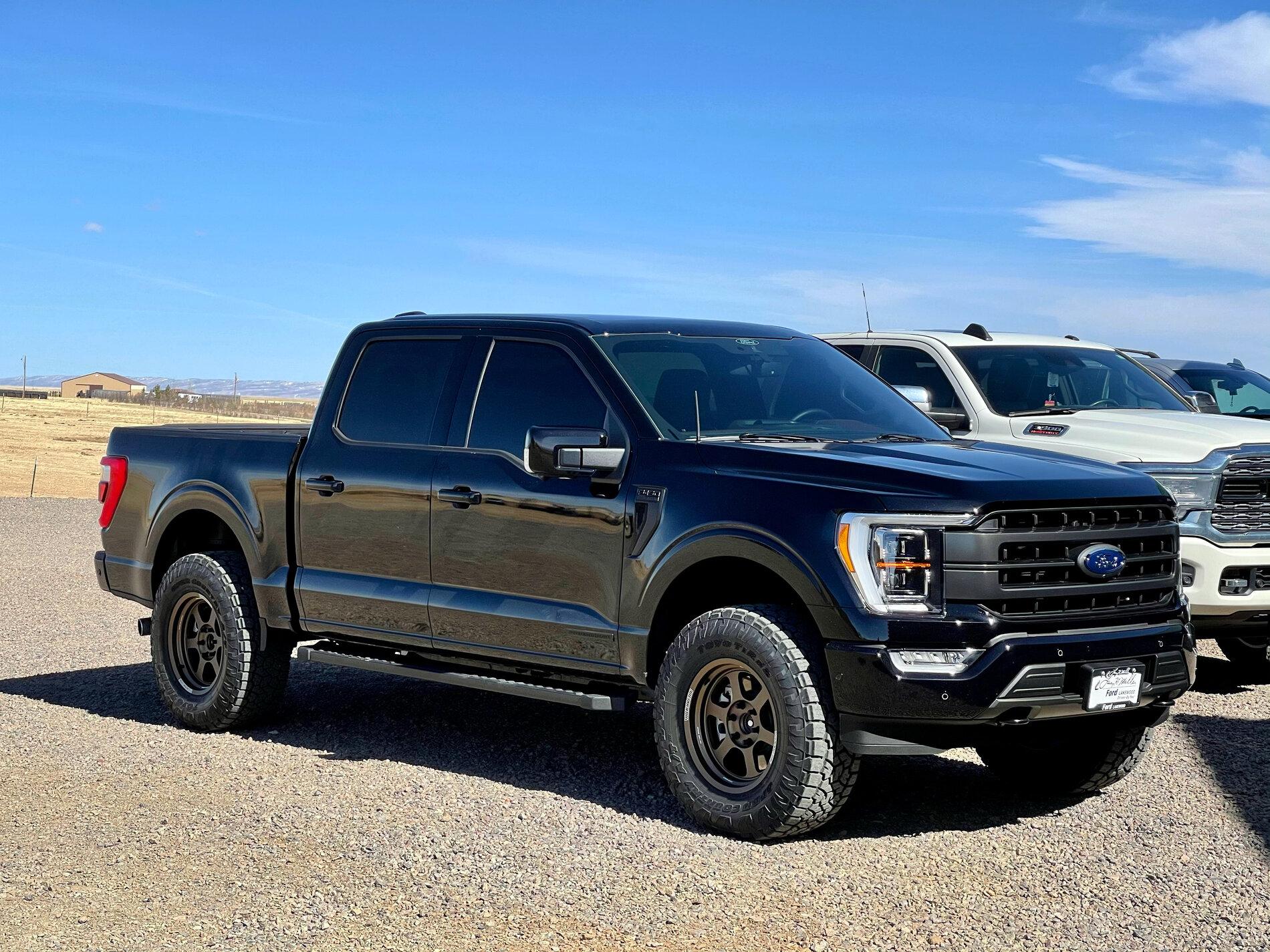

That looks amazing! Exactly what I’m looking for!! Any rubbing at all? Did you have to do any modifications to make it work?
35x12.5 open country a/t III, with a 2” level no crash bar removal.

the tiniest bit of rub nothing bad and it’s only when I have the wheel cranked all the way to the left and I’m in reverse but it’s not bad enough to bother me.
