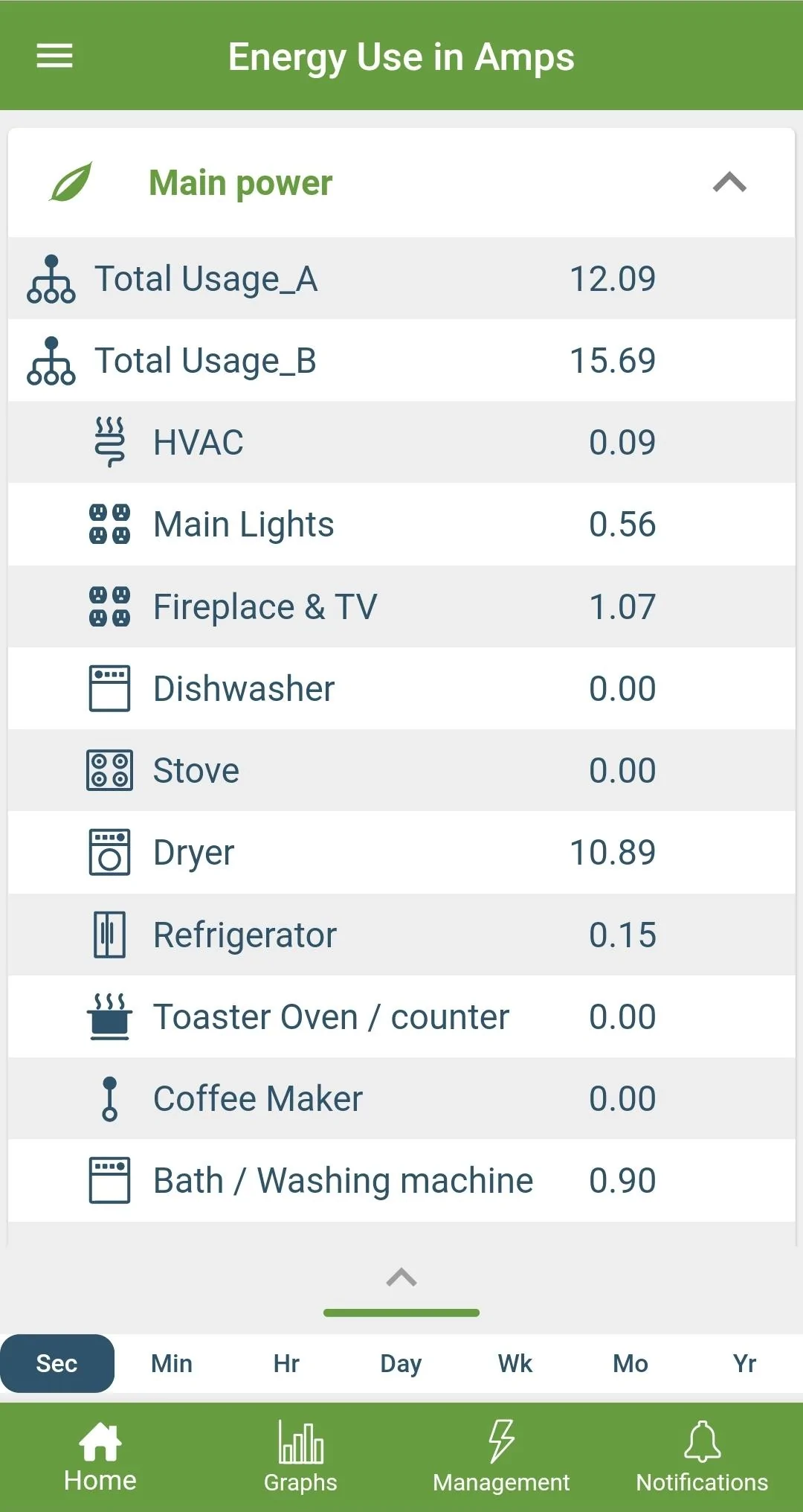

Will it monitor while house useage? I’m talking about what you would use in a day/wk/month. I see it clamps on the main lines, but wasn’t sure if it will do the total useage.
I have one as well and yes it can monitor both total usage (whole house) while also monitoring individual circuits at the same time.
Yes total usage of both incoming lines are at the top then each individual circuit displayed below . At the bottom you can select Per Second (in real time ) , per hour ,day , week and year . You can also select what value to display such as Amperage (as seen in my screenshot) , watts , dollar amount used etc . Lots of other features such as alerts if certain limits are exceeded or if a circuit is using more energy than normal etc .
