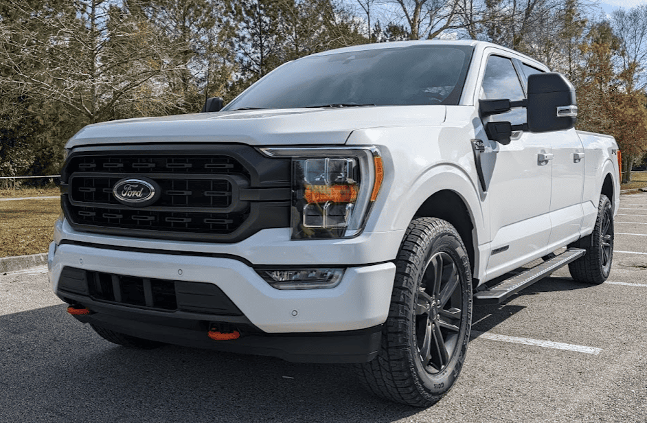

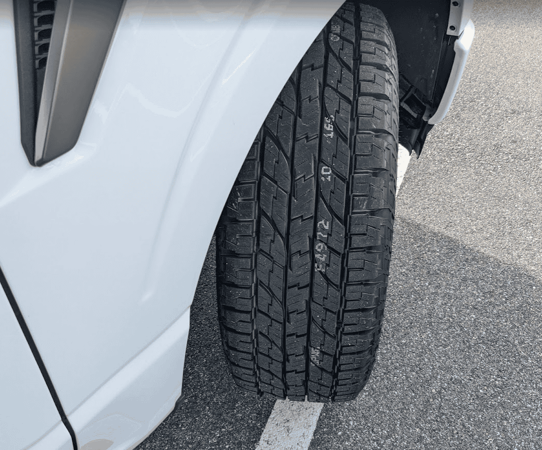

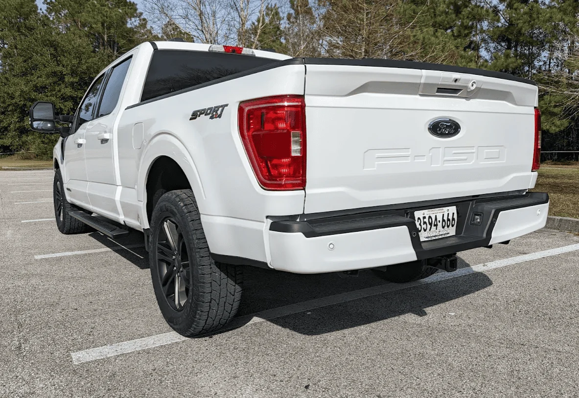

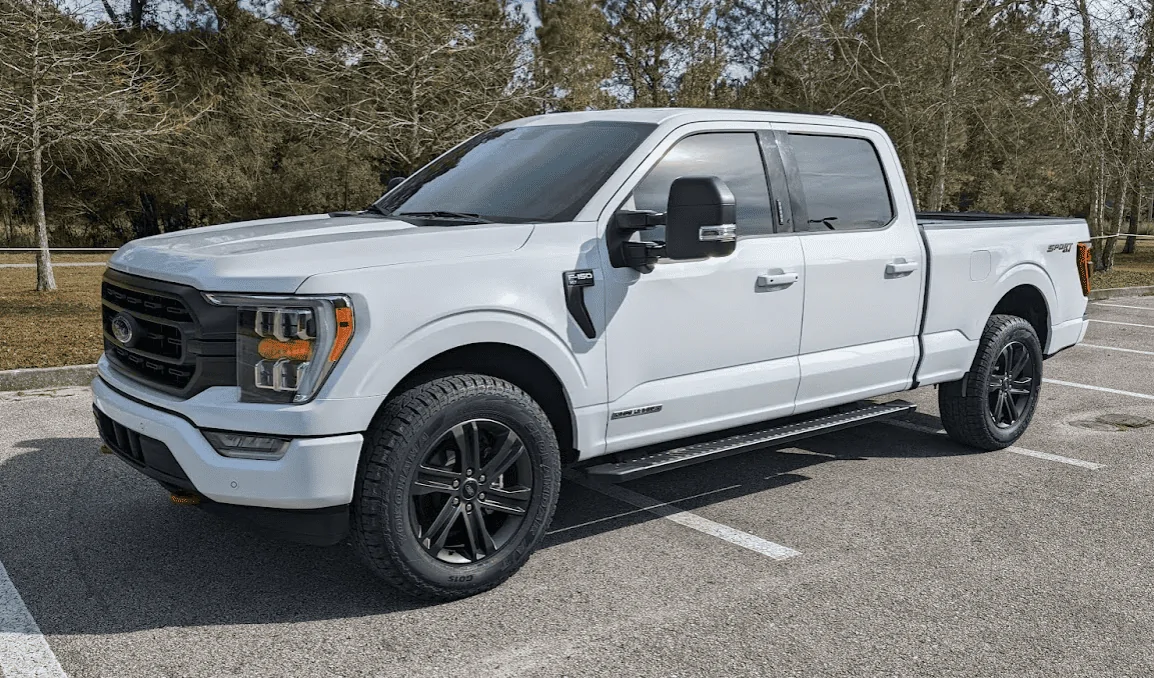

With only 1,291 miles, removed the Hankook OEMs and got Yokohama Geolandar G015 LT285/60R20 installed today at Discount Tire.
The reason I went with these was this truck will be on pavement 95% of the time except for camping on fire/dirt roads or towing a 6k lb TT half dozen or so times a year. Wanted to keep a smooth on road experience, but LT for towing. Also wanted a slightly AT look and not a street looking tire nor super aggressive tire either.

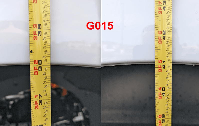

These tires are 1" taller and 3/4" wider than the stock tires. They raised the truck 1/2". GPS speeds (via Waze) at both 40 and 50mph match speedo exact. They set the air at 45psi and ride just as smooth and quiet as the OEMs. Still running in electric and mileage around town in the 21-22 range, pretty close, but hard to truly tell the impact so far on day one.

Looks great...and like a good choice!

Looks great. I think that’s the perfect size for these trucks. I’m assuming no level kit? I was looking at 275/65/20 but the extra width on these look great.

Correct, no level. Only 3" rake with a PB and I will be towing, so don't plan to level. I think the pics make it look worse. Hard to tell in person when walking around.
The 285/60 and 275/65 weight about the same, I wanted a little more sidewall, but didn't want to go up to 34.5" and sacrifice MPGs too much more. I thought the 275 looked a little slim. I think the 285/60s are the XXL to the 275/60s XL if that makes sense. They are a little larger proportionally.

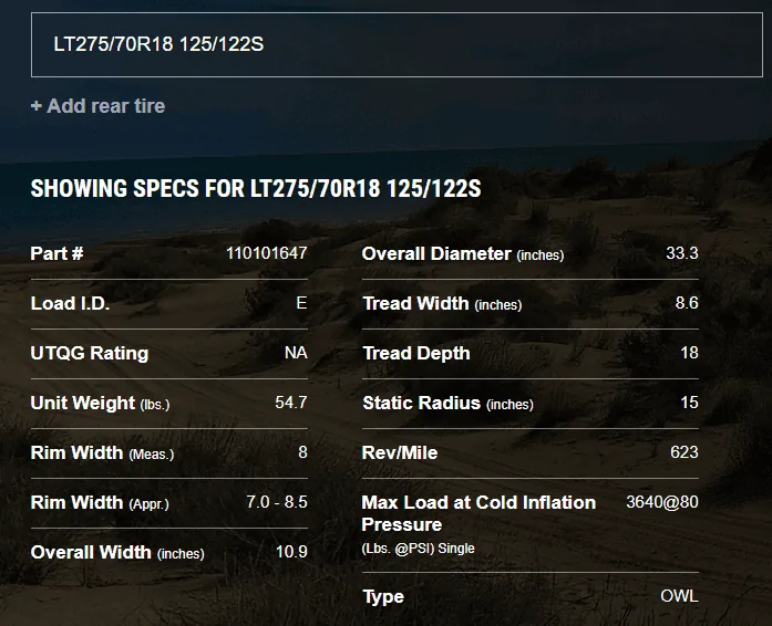

I’m just thinking of going the 18” wheel route and I like that the Defenders are 33 in diameter. I do like the looks of those Yokes those!!

You can get these as 33s on 18s if you wanted. If you prefer the Defenders, you have to go with what you like. :)
