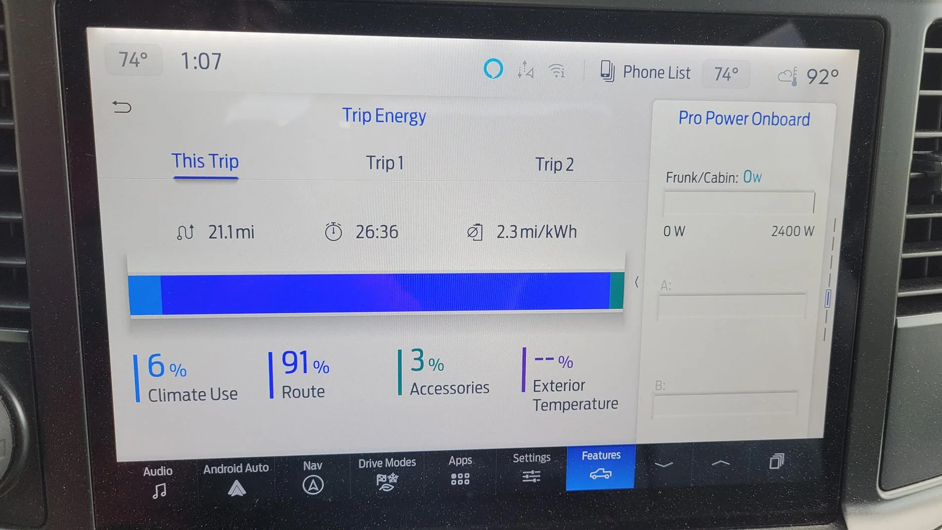

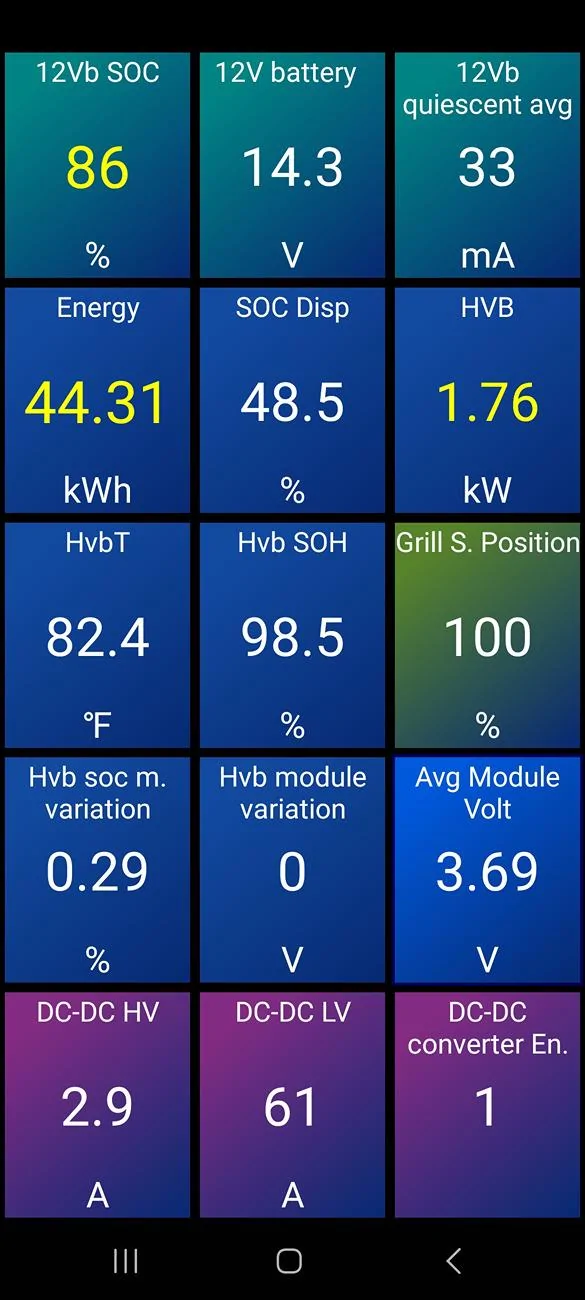

New issue happening, soc % dropping upon departure, anyone else have this?
Maxx
Jul 15, 2021
2,363
2,921
This is definitely new for me. It either must have been in the last software update (in my signature) or there was an unpublished update.
I just took a trip. Charged to 60% two hours before the trip. Immediately after leaving driveway, I was at 58%. Looking at OBD2 and energy. Efficiency calculation was accurate assuming that 2% never existed.
Battery temp remained the same during trip but what was surprising is that no energy went to exterior temp being in 90s F.
This is from my return trip. I took a shorter slower route. Look at energy and SOC. The truck was parked from 1PM to 4PM. SOC displayed remained the same at 48.5 but energy went up from 44.31 Kwh to 45.78 Kwh while it was parked. Then in 3 minutes energy dropped but SOC went UP by 0.5%. as screwed up as this sound, the upshot is for this trip I got some energy show for exterior temp.
If you have any theories on what the truck is thinking please do share.
p.s. I did not record the energy when initial charging to 60% was done to see if that 2% loss shows in terms of energy as well or it is just SOC calculation. If any of you do that, please share.
