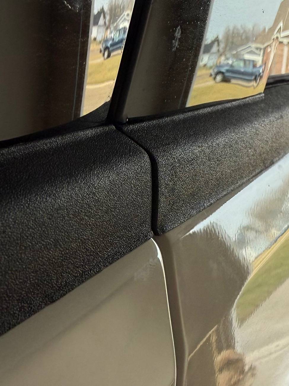

OK, it looks like this did it. Such a quick and easy fix to this significant door vibration. The door moved around a millimeter and that did it. Unreal how a small amount of movement made that much of a difference. I also see where another owner tried this today too!
I added an image of the movement amount. Before the fix, the black trim was even. Not even concerned about moving the rear door to line up. You can barely see it. Can’t wait to call the dealership and cancel the service appointment :) !
