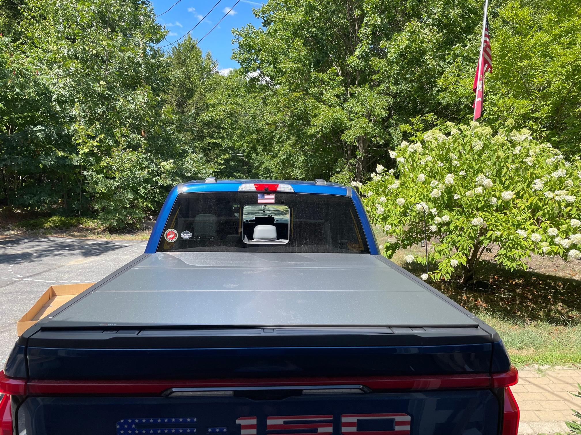

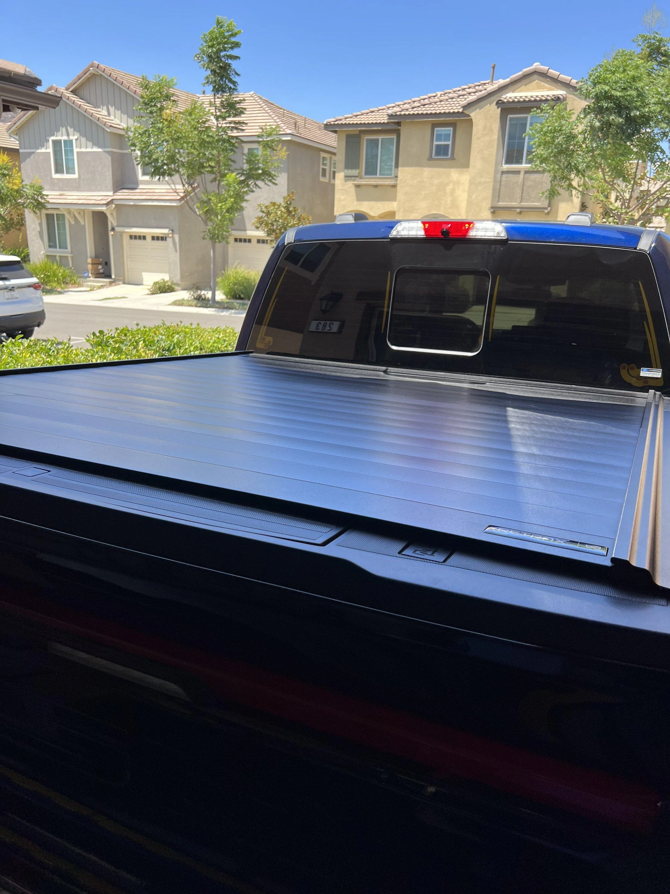

Finally got the tonneau cover today, installed in 25 minutes with the help of the 9 year old on the socket.
LOMAX Tonneau Cover I bought the matte black version. If I won the PowerBall a couple weeks back I'd have gotten the $2,300 carbon fiber version.

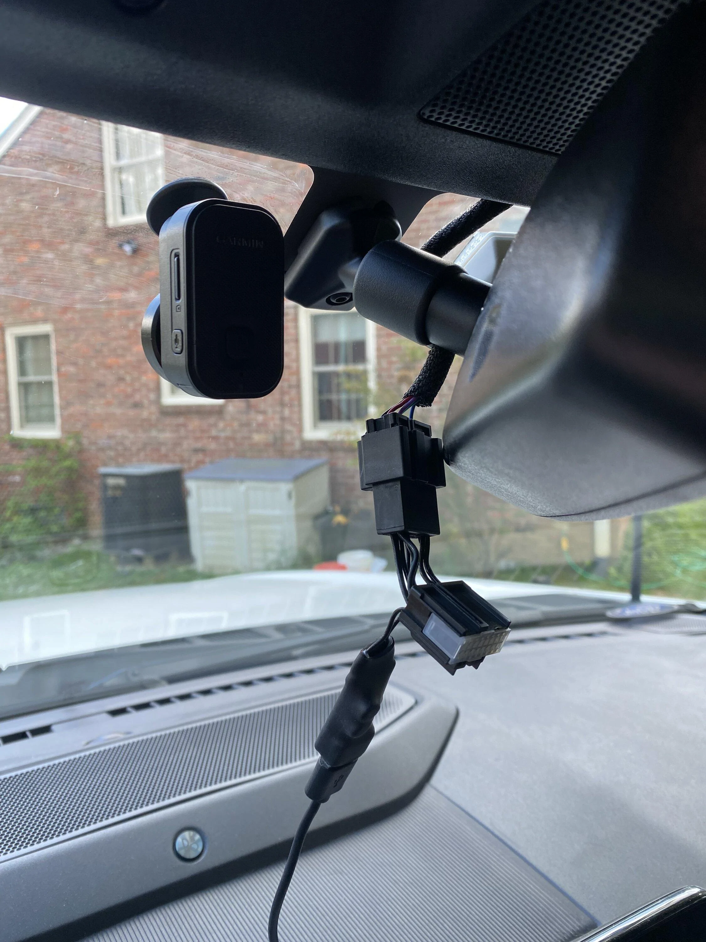

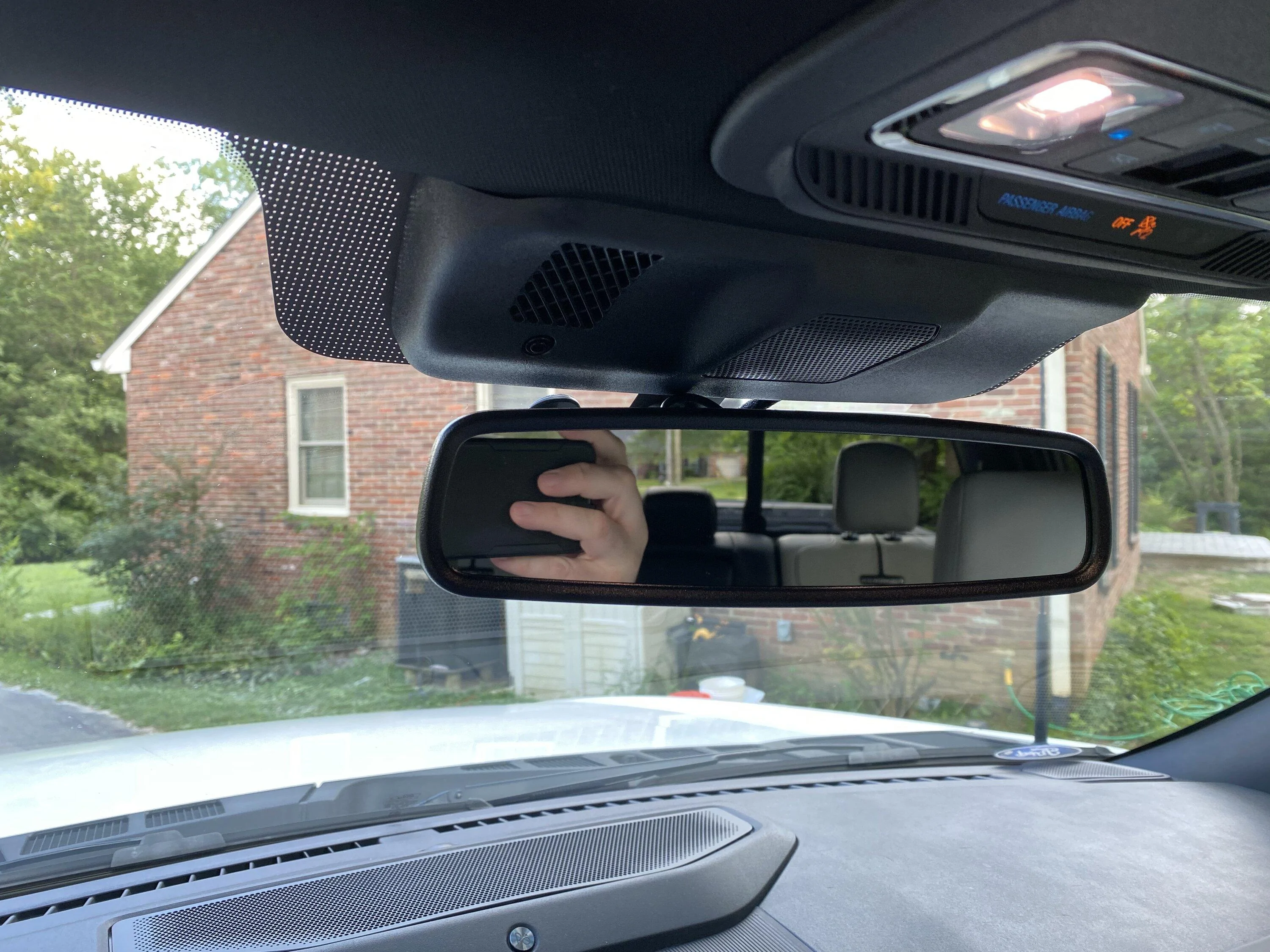

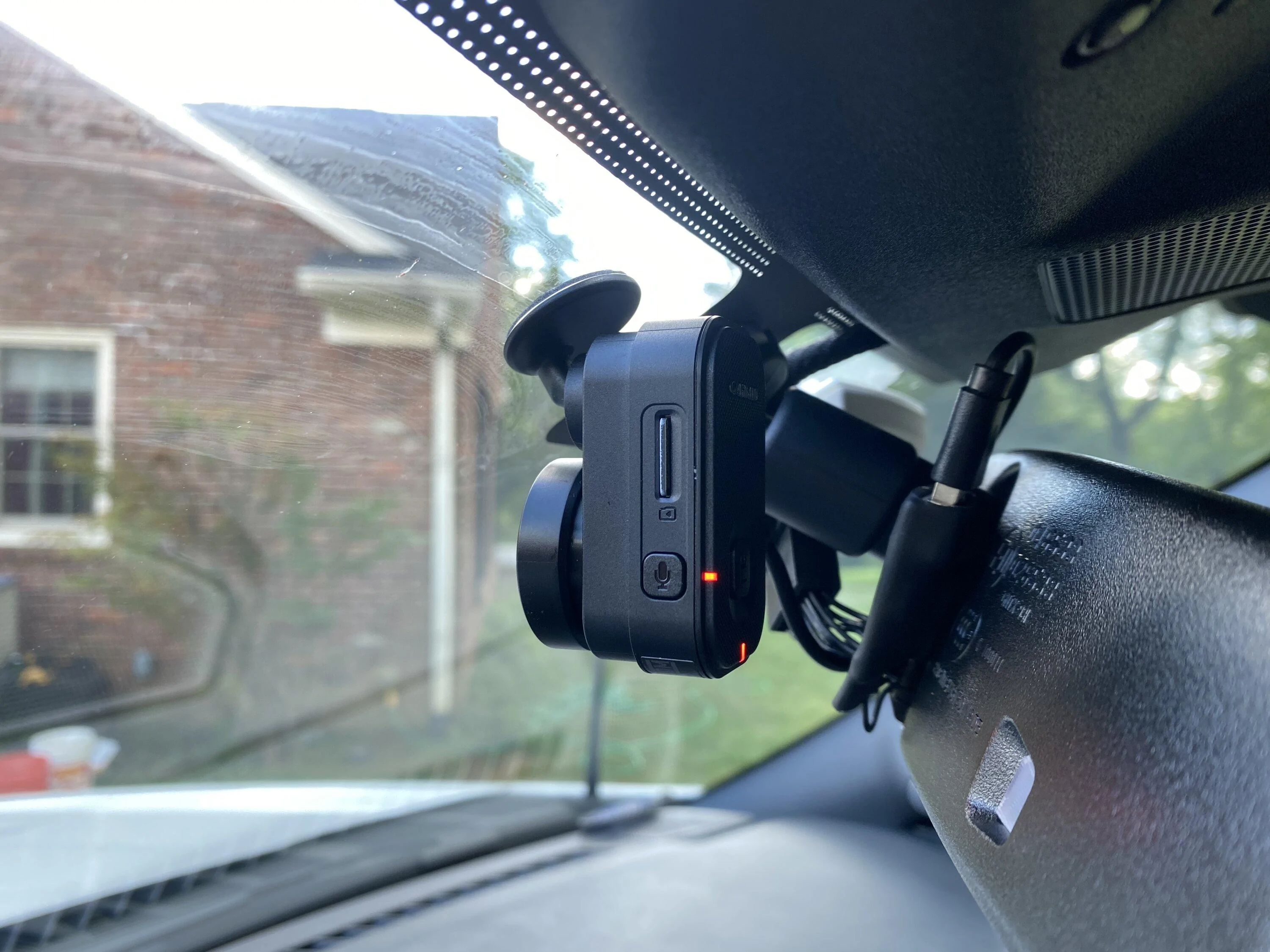

I got my Gamin Dash Cam Mini 2 installed today with the Dongar mirror adapter. You can't even see the camera or adapter when I got everything in place!
For those thinking of installing the adapter, it is easier to plug the adapter into the mirror first, then plug the rest of it together second.
Can you link a site to get the adapter? And did you do yourself? Looks pretty straightforward.
