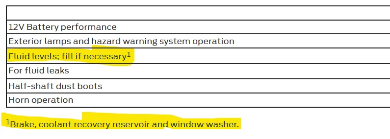

Good summary - there is certainly more that a couple of things. One comment though - in my owners manual under multi-point inspection, it says:
Ford F-150 Lightning 10k mile service/check up... 1692834744152
I read this as no need to check the gearbox fluid during the multi-point, just brake, coolant, and washer fluid.

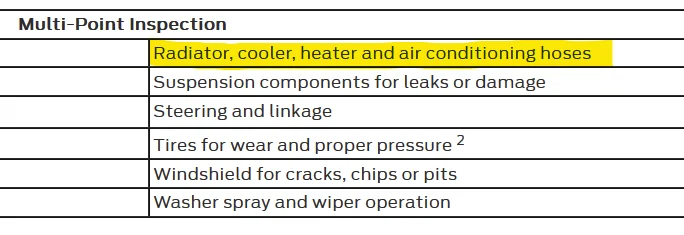

The only mention of the gearbox fluid I can find is

In my mind it is a closed system and I would think opening it up is a good way to introduce contamination. Just check for leaks like it says. If no leaks then level likely good. Not sure what it takes to check for leaks there - does skid plate still need to be removed?
EDIT: Also would this require Frunk removal? That would take a while as well. Or can you see these from underneath?
