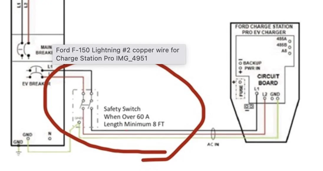

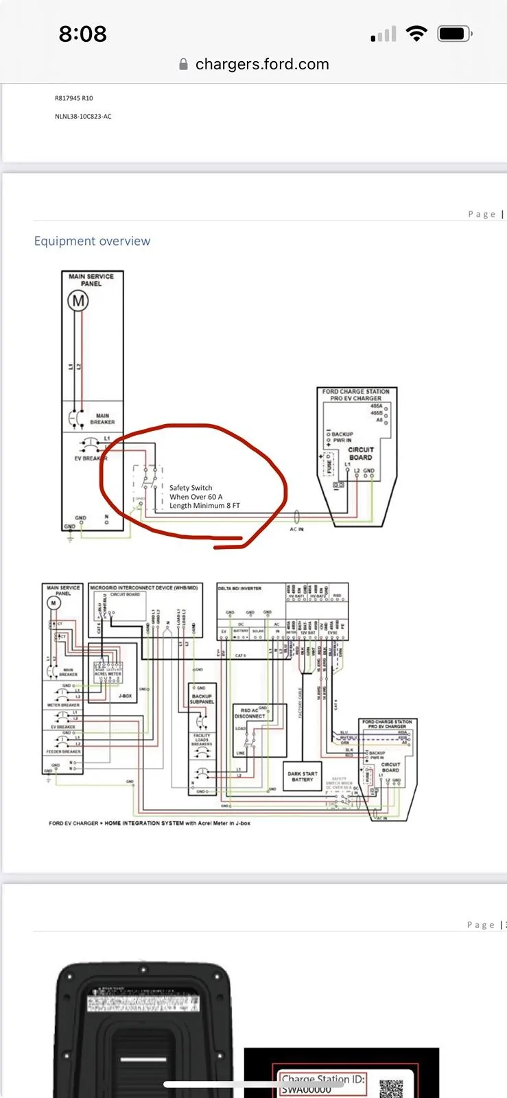

I was about to go insane trying to find this because I could not find my install manual and had to search a pdf. It’s in a diagram, not a written note.

Maybe the "Minimum 8 FT" refers to how far the safety switch (if needed) should be from the Charge Station Pro.
Wow, that’s bizarre. As an electrical engineer, I can’t come up with a reason for that. I have about 18” of wire between my disconnect and the FCSP.
ETA - that diagram isn’t in my manual nor did it come with my unit. I wonder what its origin is?

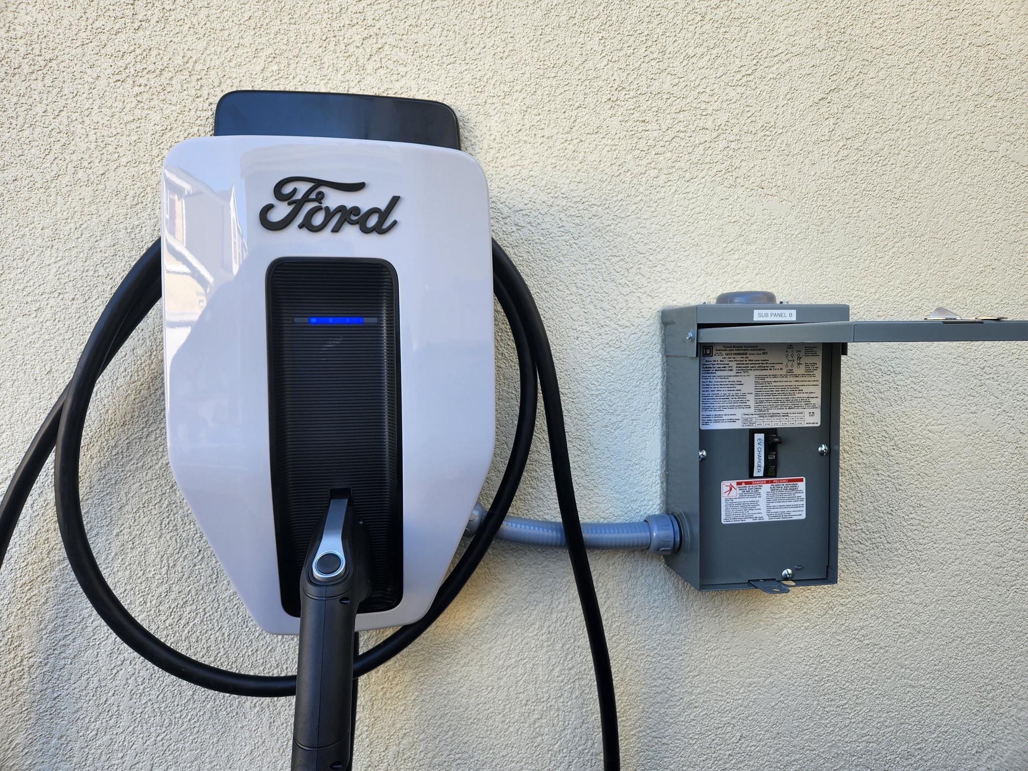

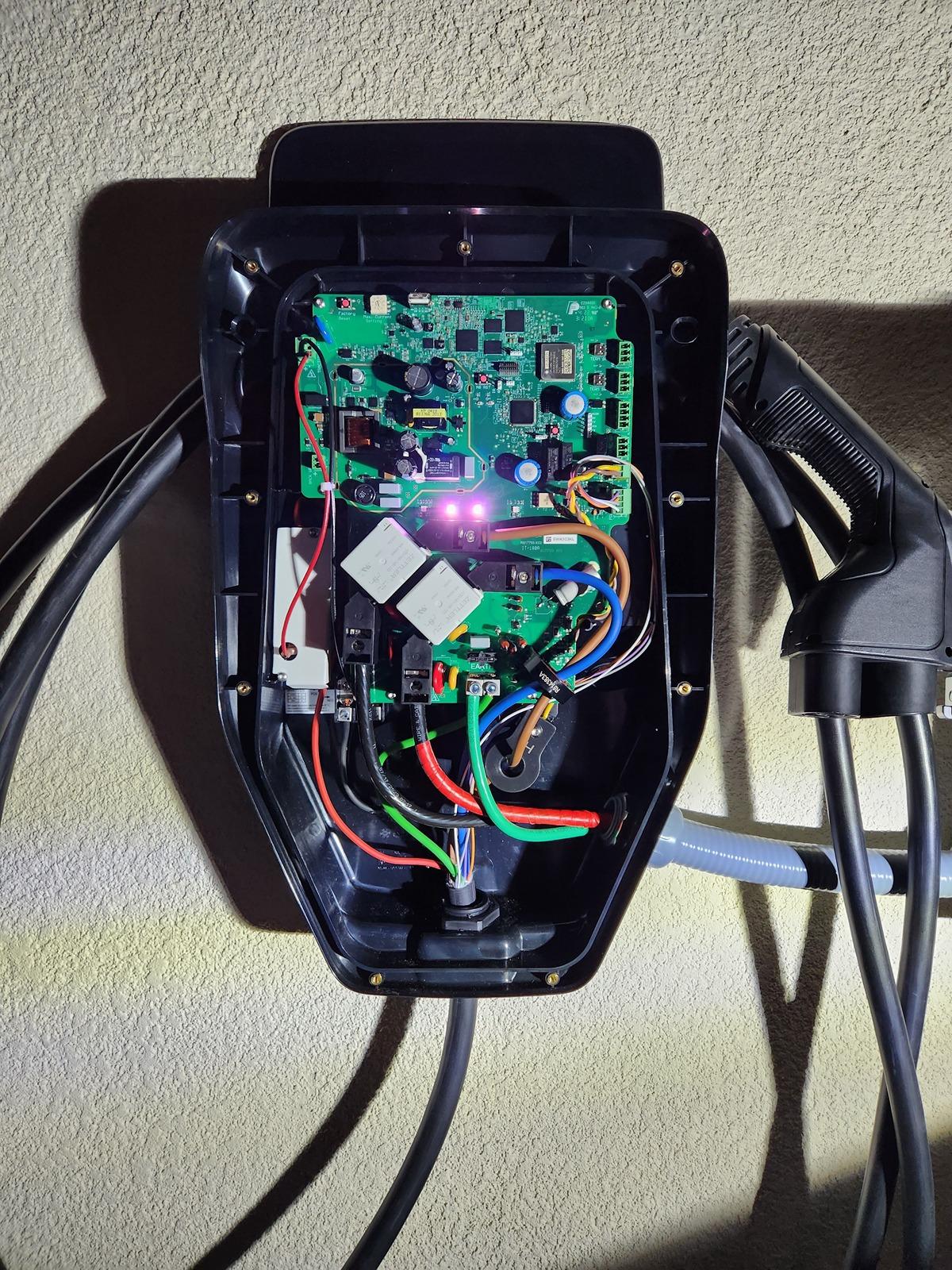

Will #2 copper wire fit in the Charge station pro? My charger is due to arrive on Monday 5/6/2024. I have a line on the #2 for a good price.
work
Ford F-150 Lightning #2 copper wire for Charge Station Pro 20231028_205527
Ford F-150 Lightning #2 copper wire for Charge Station Pro 20231029_151431
Reactions: dww

Yeah, I don’t know why either. The “disconnect distance” comment above makes some sense, but 8 ft? It was in my manual but this is where I took the screen shot.
https://chargers.ford.com/gcs/B2C/chargers/InstallationGuide/NLNL38-10C823-AC.pdf
I noticed the Ford part number on that manual ends in “AC”. Mine is “AB”.
If I was going specify a spacing between equipment, I wouldn’t use the word “length.”
