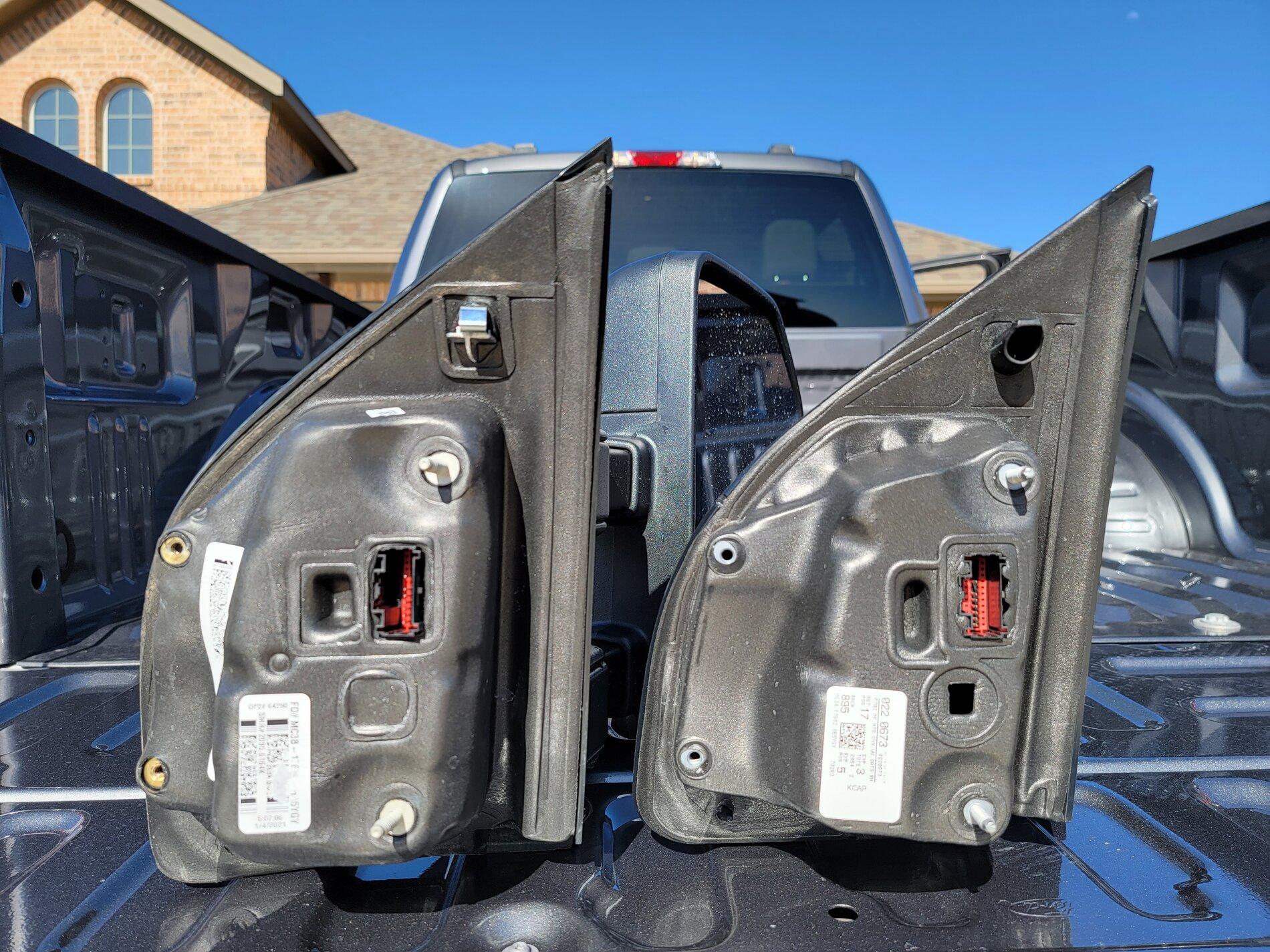

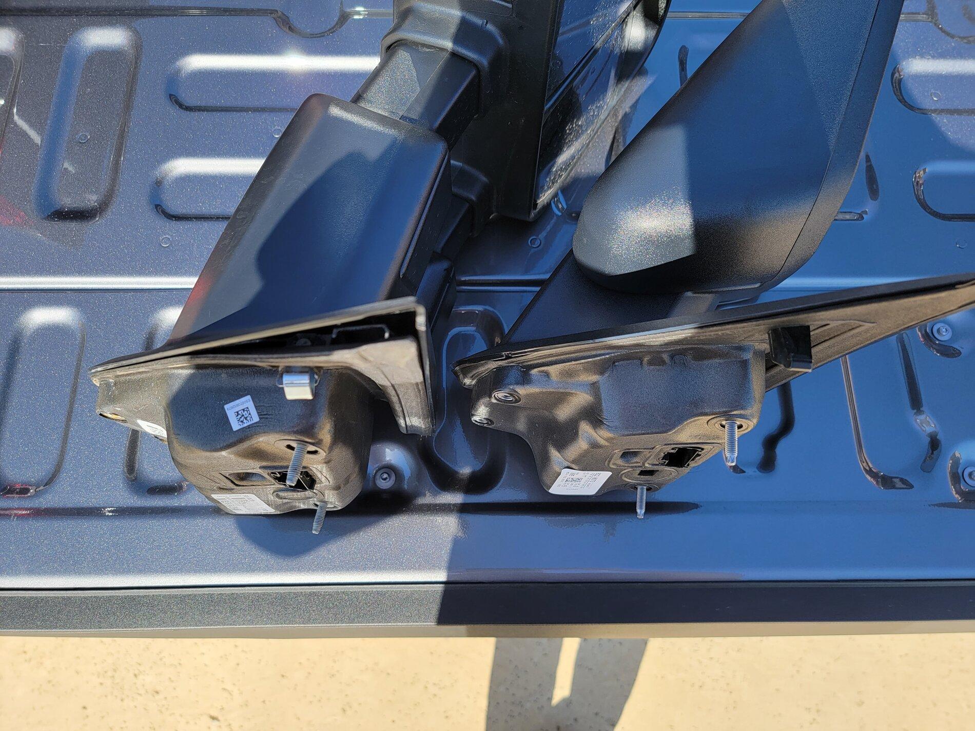

Will a 2020 or older trailer tow mirror fit on a 2021. I don't think the 2020 had BLIS otherwise they are the same just not sure about the fit. I have a leased 2018 that is going back soon with the tow mirrors and love them, hard to find a 2021 on the lot with tow mirrors and nothing aftermarket available yet.

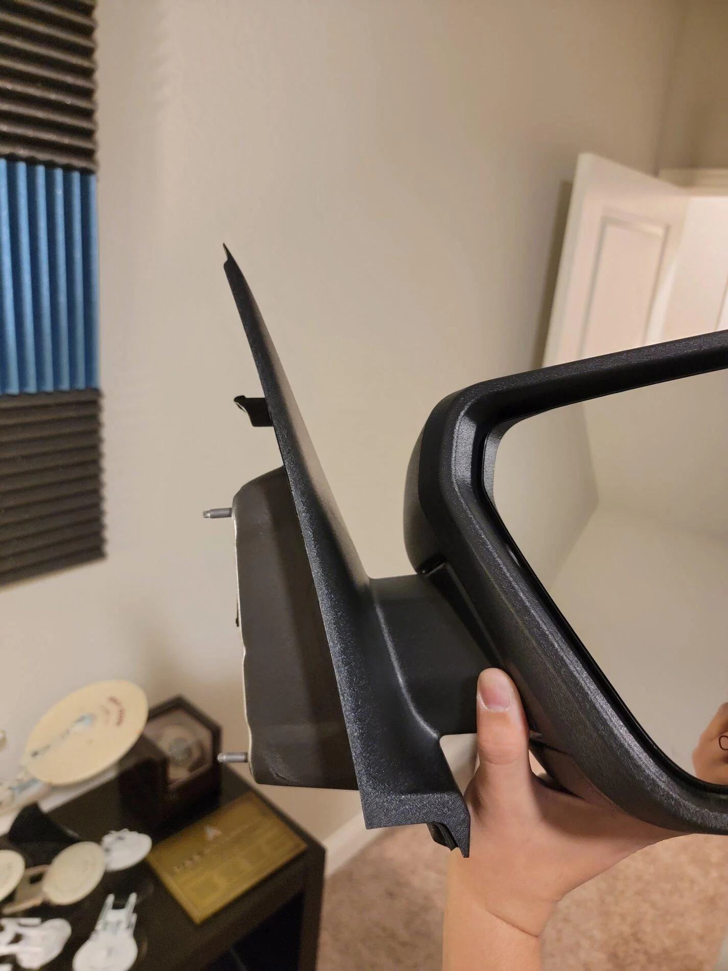

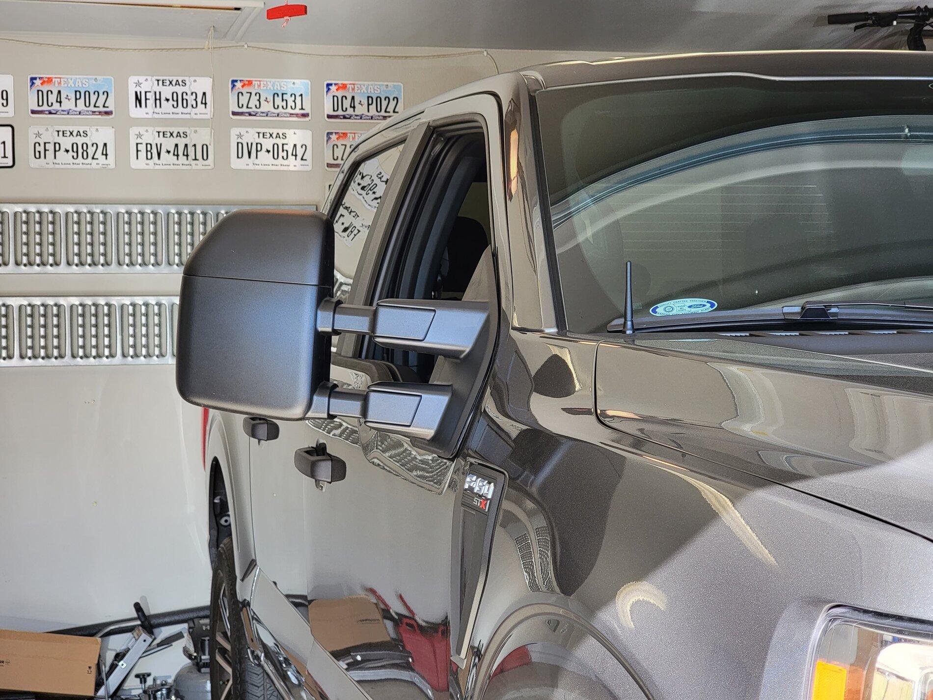

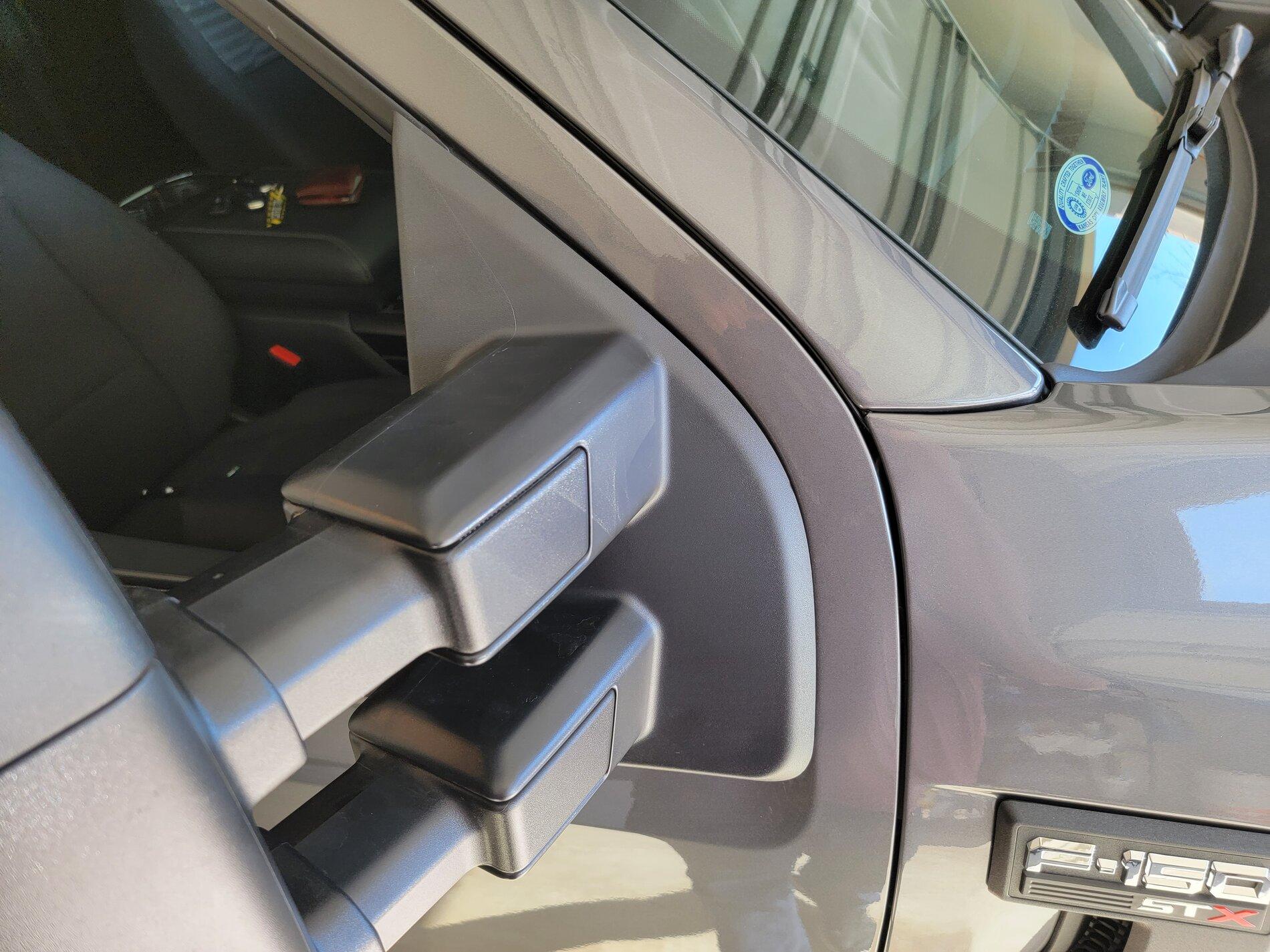

Look near the end of page 1 of this thread, I managed to fit one but you will have to trim a few areas of the plastic mounting surface around the window seal to make it work. But I think it can be done in a pinch.

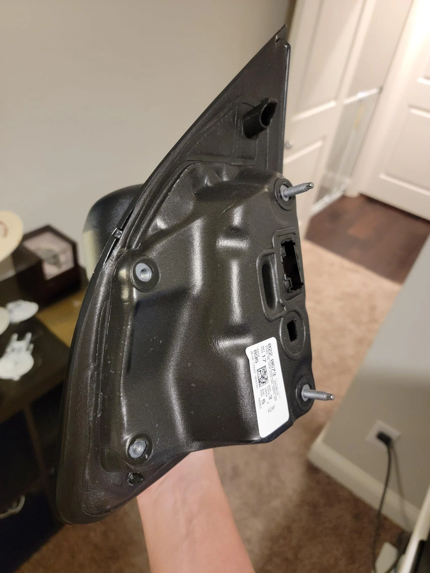

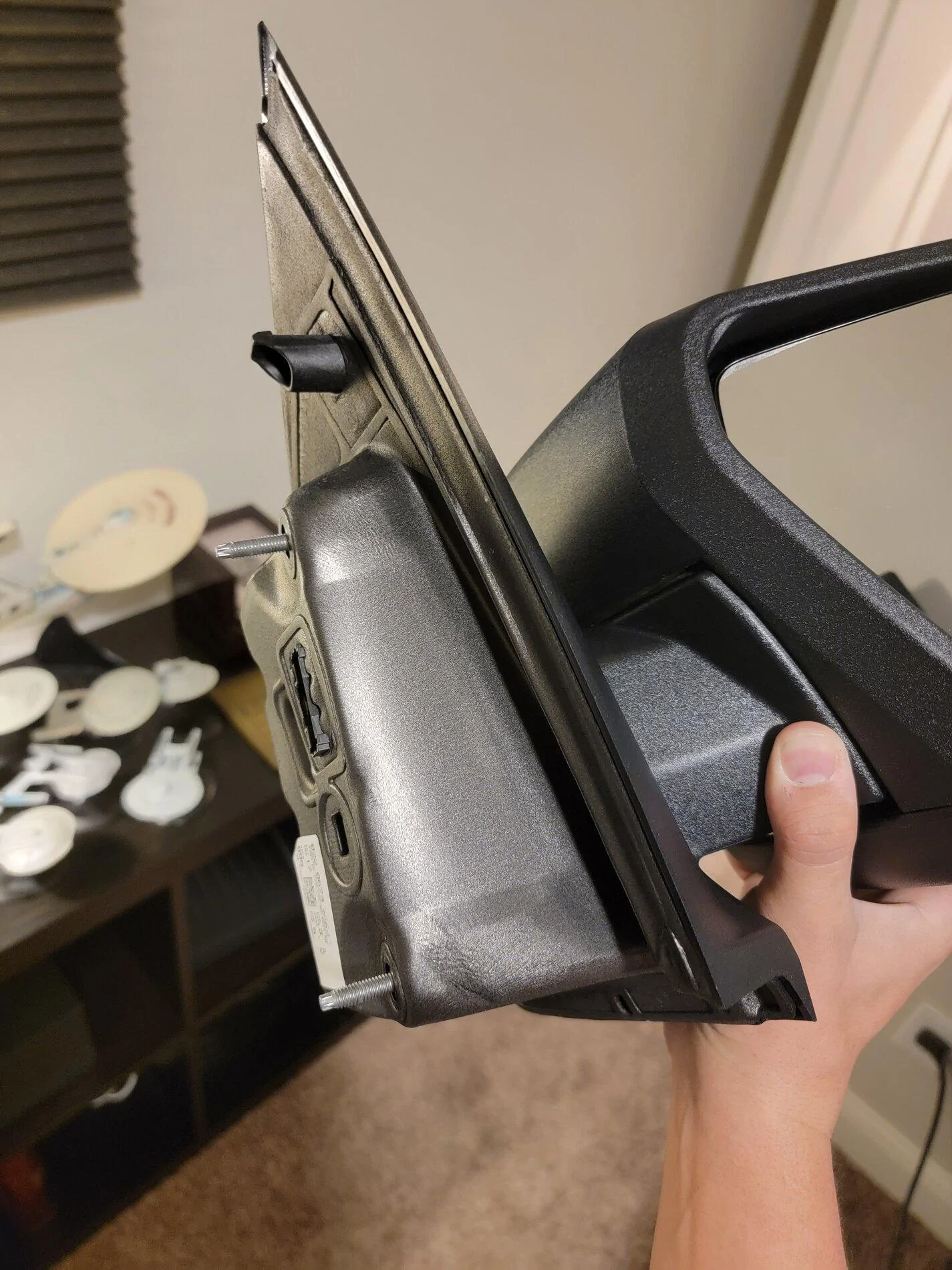

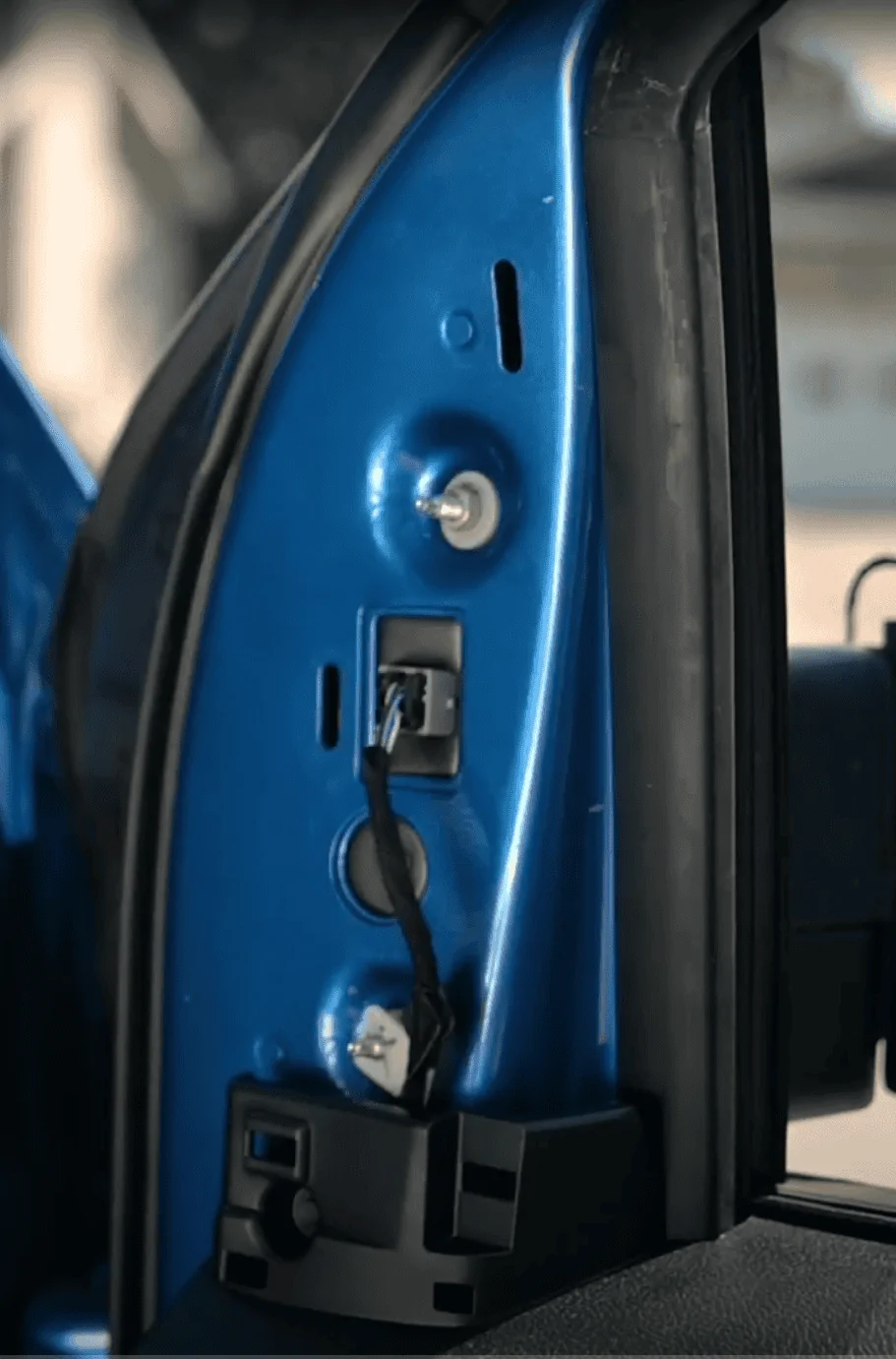

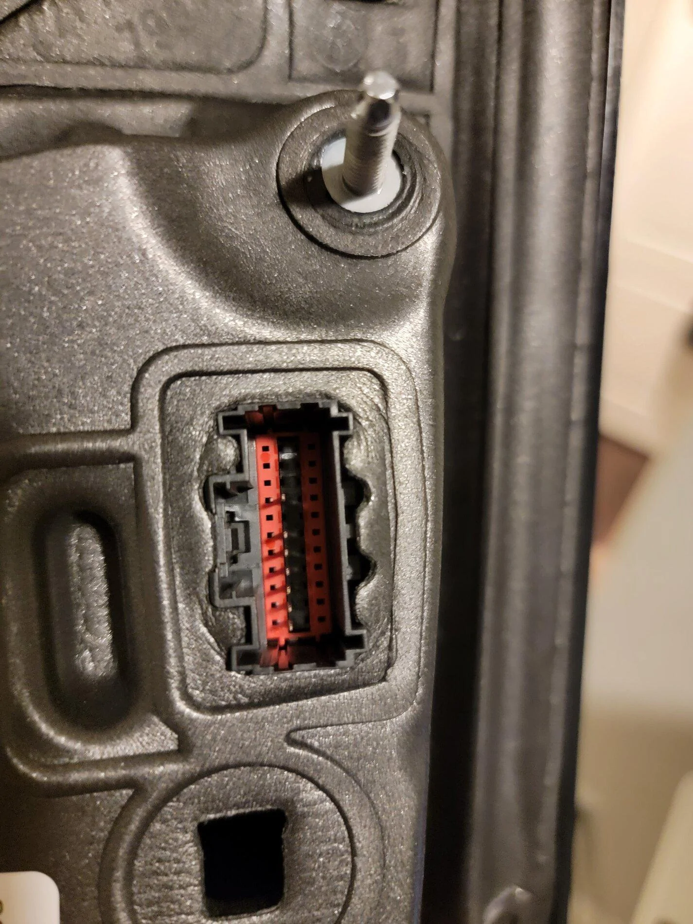

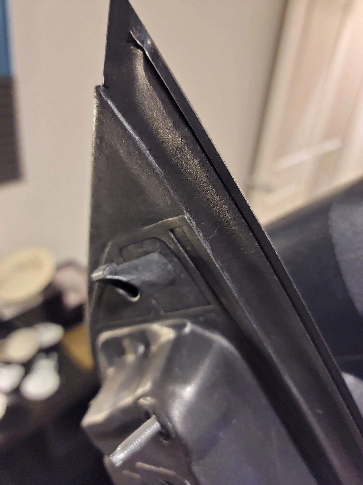

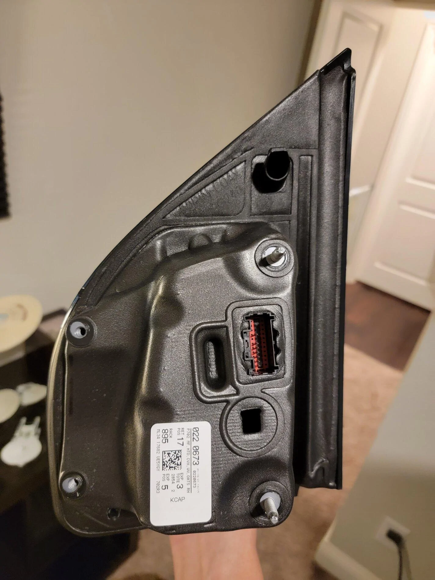

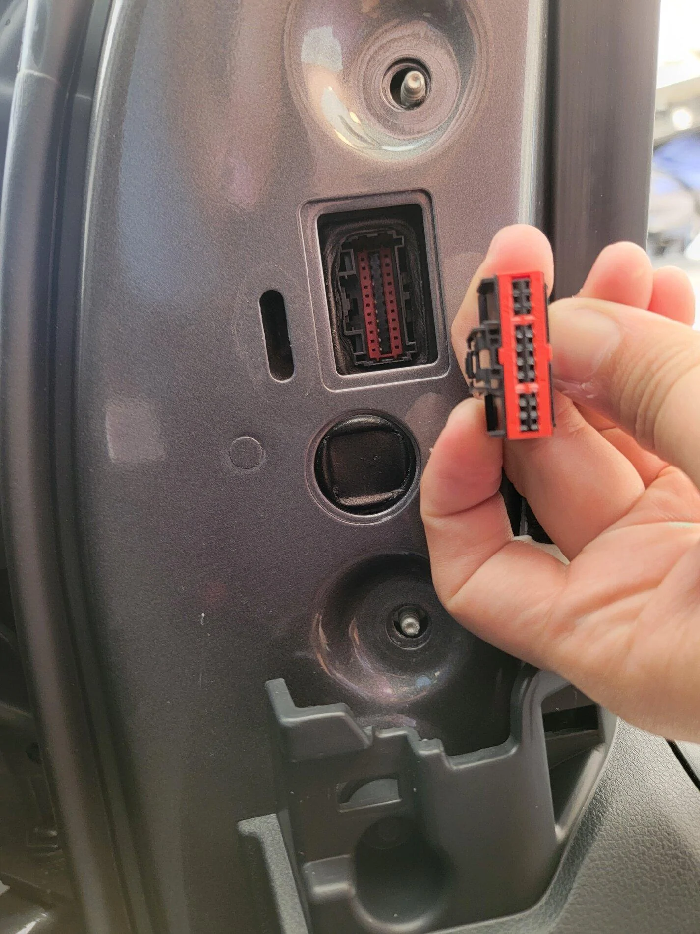

I have a set of tow mirrors I bought for my 2017 just before I traded in for a 2021, if anyone is interested. They are OE mirrors with the adapter to plug into the 8 plug. I live in central Florida.

Do these not fit on the 2021 f150?

They won't without some minor trimming of the mounting surface (mirror side) near the window's weather strip (see my earlier replies).
