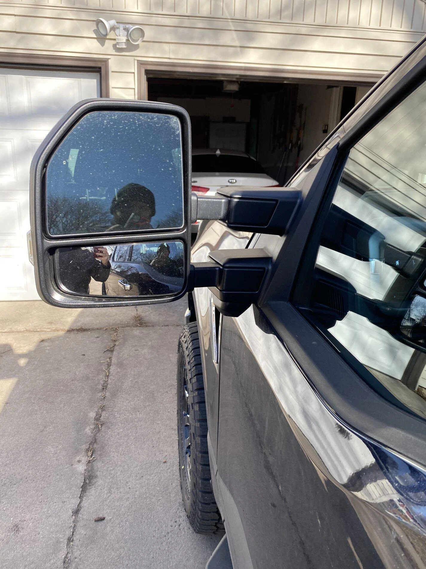

I installed 22 pin Ford tow mirrors on my 2015 F150 XLT 8 pin truck.

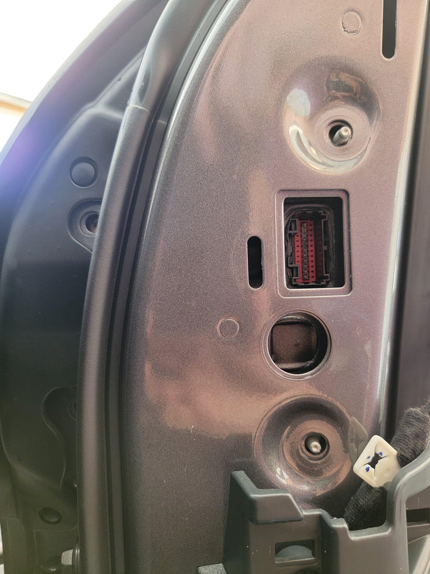

Ok guys today I removed the tow mirrors from my superduty (2021) and confirmed that they DO indeed fit the F150 and as long as you get the 22 pin connector on the Superduty mirror side (2020-2021 for sure, but possibly as far back as 2017ish) I believe you will be in business.

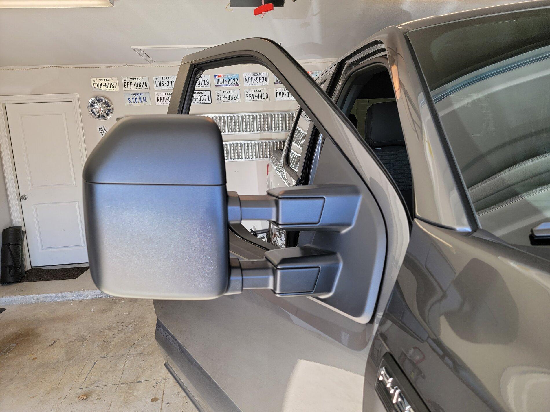

I got the mirrors installed, I had a check engine light for air temp sensor for a bit. Shut the truck off and initiated a remote start and it cleared the CEL right up.
the issue I am trying to solve is the truck that got my normal size mirrors (platinum) cannot move the mirrors inward or down. Not sure why that is. Pins and everything matched and they worked perfectly before they where installed. Just really confusing.

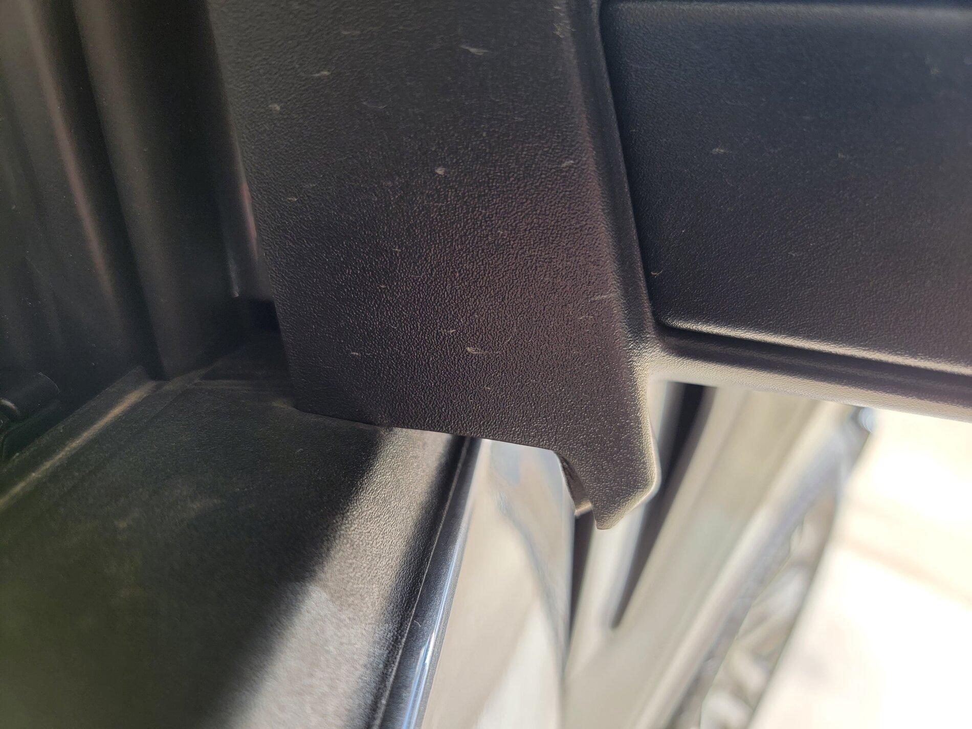

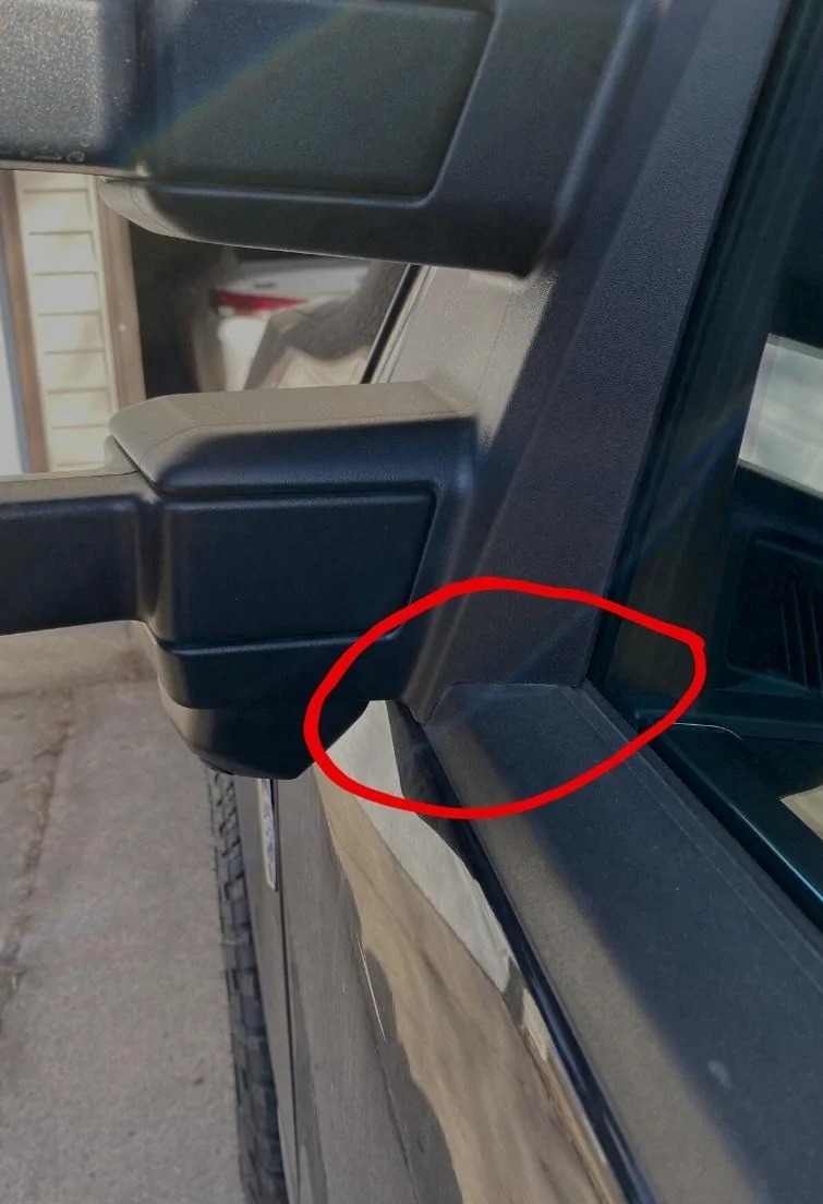

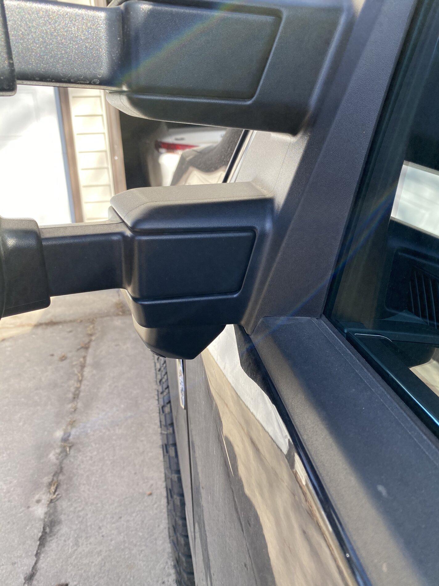

Do your mirrors move normally inward and down?
Also can you snap a photo of the mirror mounting surface as seen from inside the cab looking at the base where it meets up with the window seal?

Thank you.
As I suspected the mounting surface was redesigned to fit the door contours. The prior years will not fit without some slight modification (trimming of the mounting surface near the inner window seal).

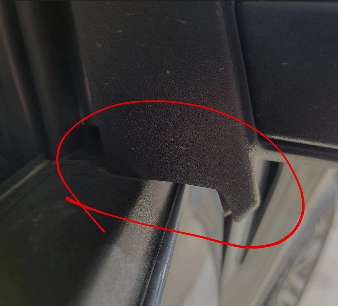

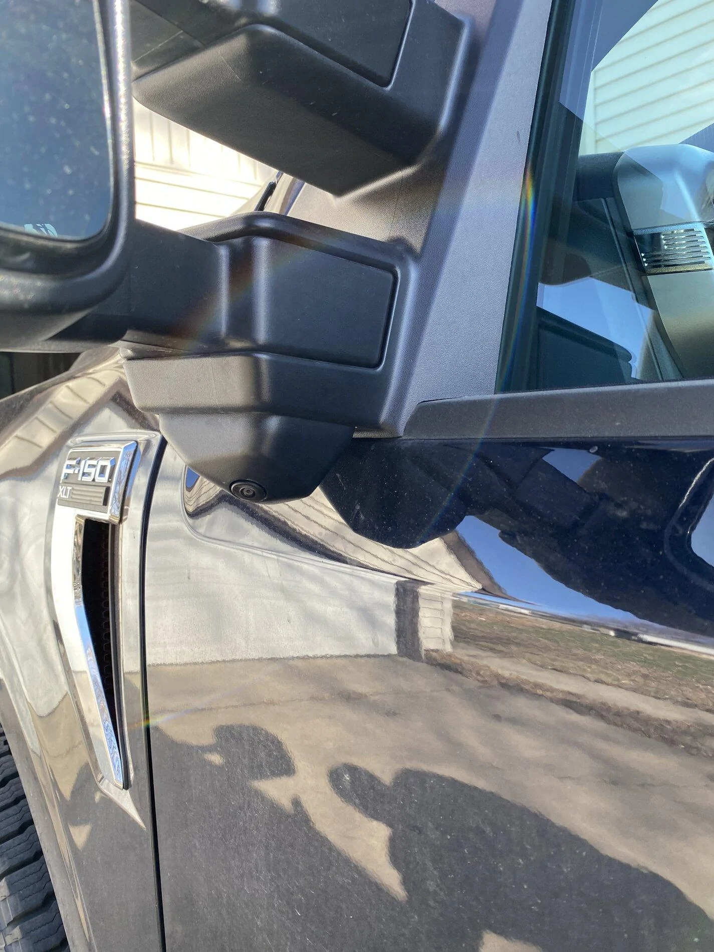

Here is that mounting surface on the old mirrors:
Ford F-150 Lightning 2018-2020 Tow Mirrors fit? Screenshot_20210330-182905_Samsung Internet
Vs the slightly trimmed one:
Ford F-150 Lightning 2018-2020 Tow Mirrors fit? Screenshot_20210330-182806_Samsung Internet

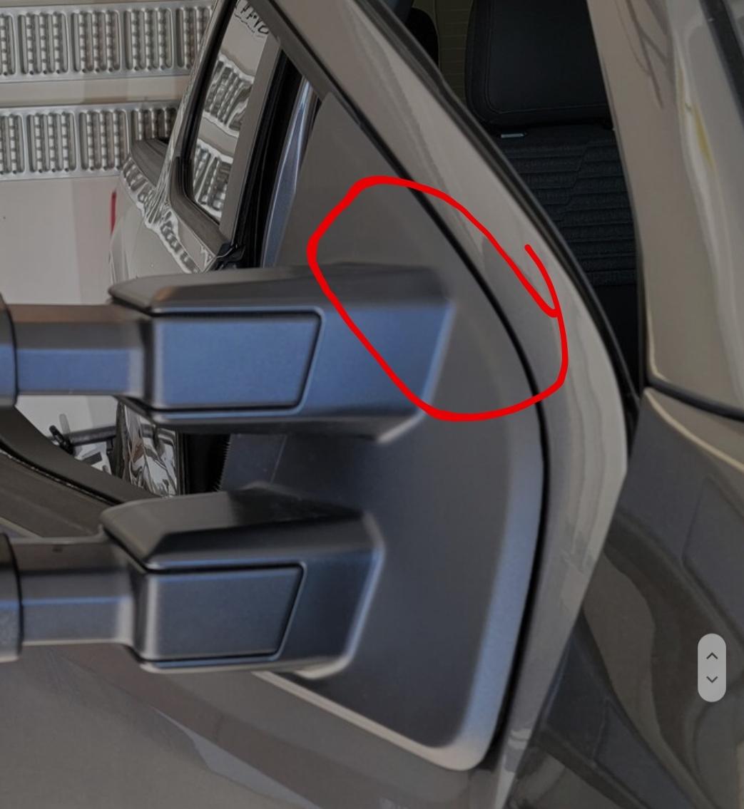

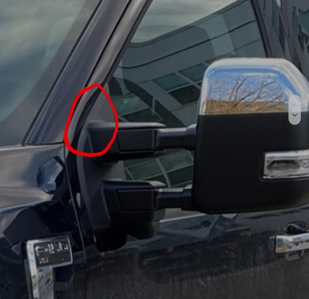

In addition to this difference, the overall trim surface that backs the mirror seems to have been reduced in size about 2-5% as evidenced by the area around the mirror arms:
Ford F-150 Lightning 2018-2020 Tow Mirrors fit? Screenshot_20210330-182947_Samsung Internet
Vs the old ones:
Ford F-150 Lightning 2018-2020 Tow Mirrors fit? Screenshot_20210330-182921_Samsung Internet
The arm bleeds into the chamfer a bit on the new mirrors. I'm wondering if this will affect the seal or just the visual appearance.
It's looking more and more convenient to just use the new 2021 F150 tow mirrors.
I'm still gonna use the old style mirrors on mine at least for a while since I'm about to have an extra set sitting around anyways.
I'll keep you guys posted when I eventually modify/mount them.
