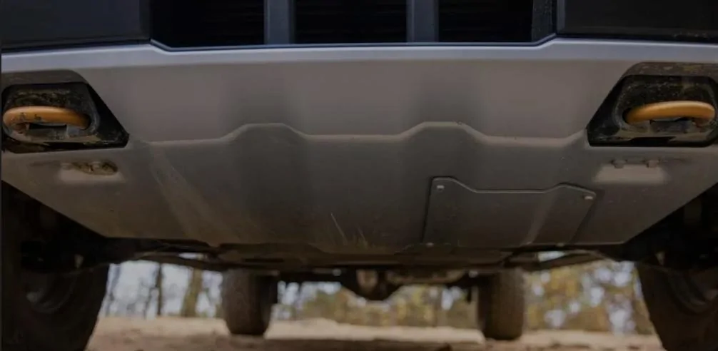

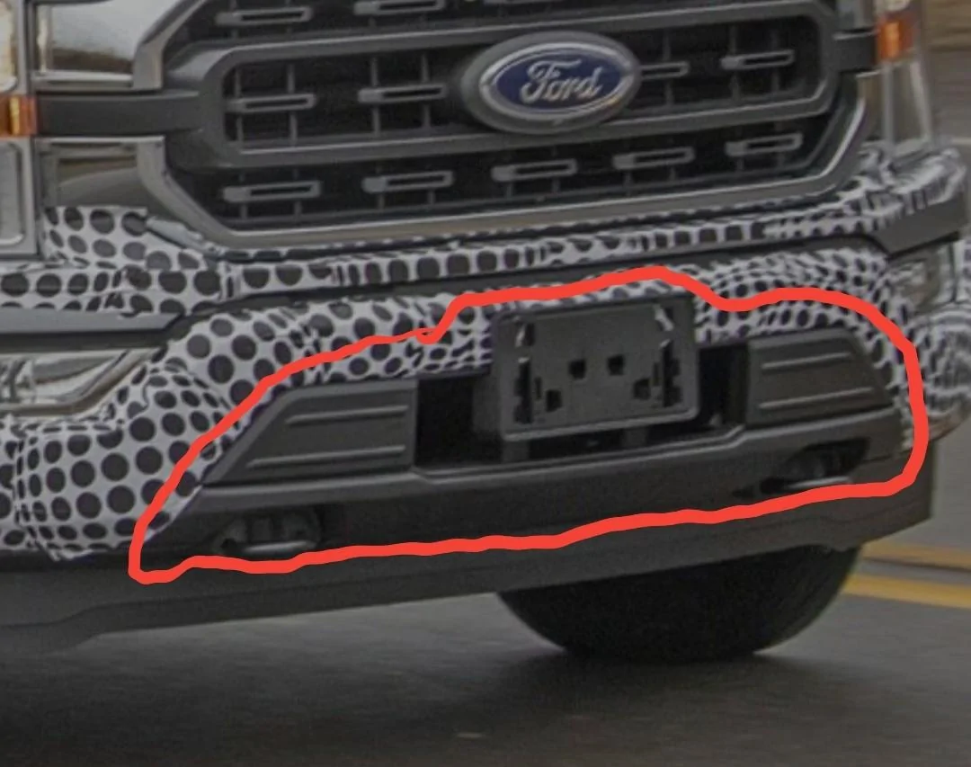

Here is what the tremor skid plate coverage around the towhook bottoms looks like btw (I believe the upper silver portion above the towhooks is part of the bumper/fascia:

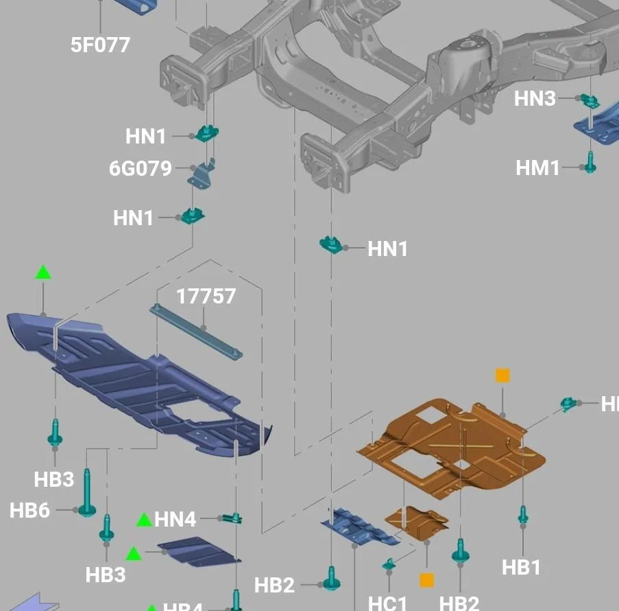

Ford F-150 Lightning Removed Active Air Dam From my F-150 - DIY Writeup Screenshot_20210308-104542_Samsung Internet
In addition to the plate, service panel, and a few brackets that mount near the towhooks and possibly one that mounts near the crossmember (might already be on the truck for the engine skid plate),
The Tremor appears to use a different bumper panel as well (the part below on a regular F150 vs tremor:

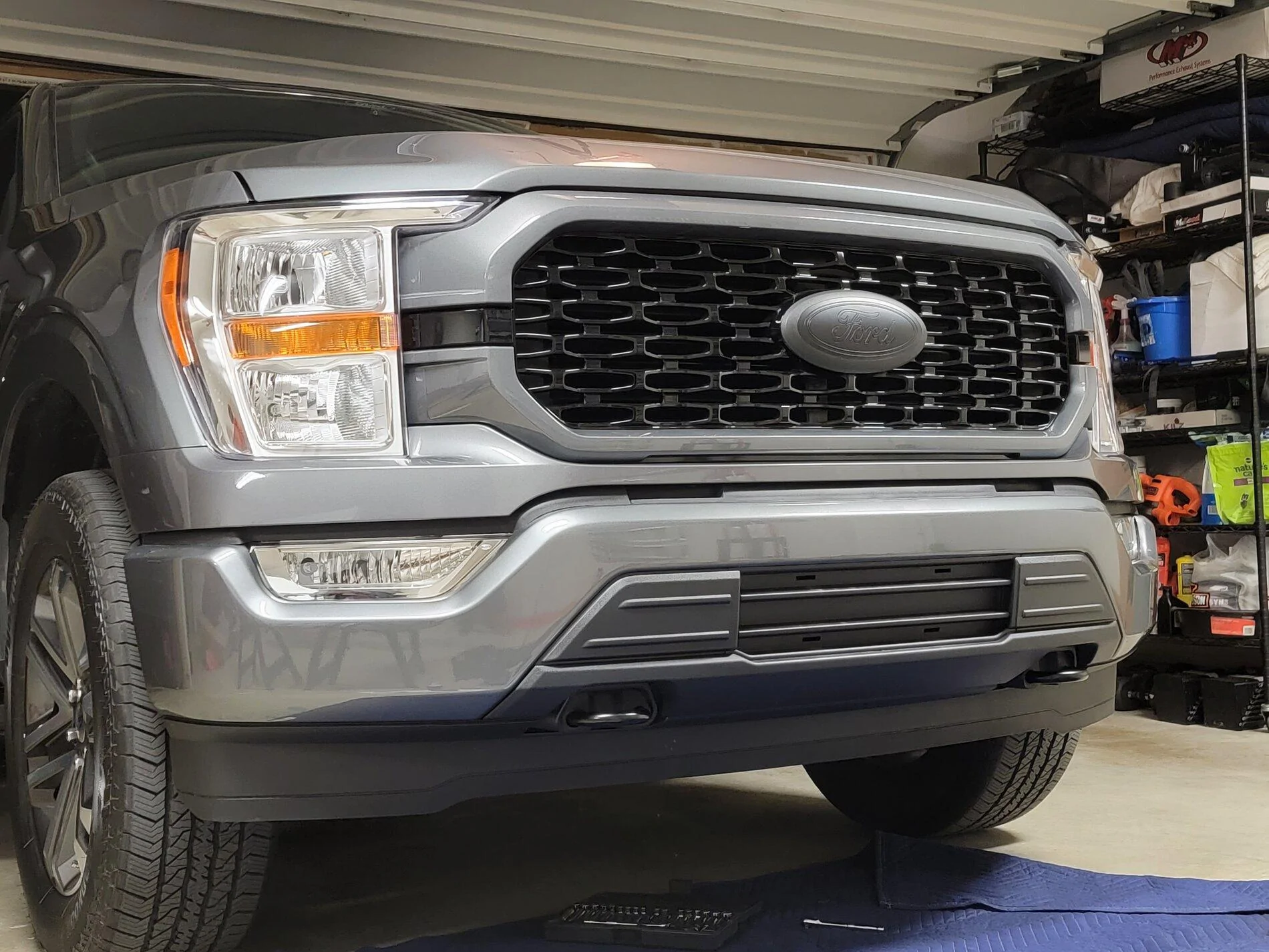

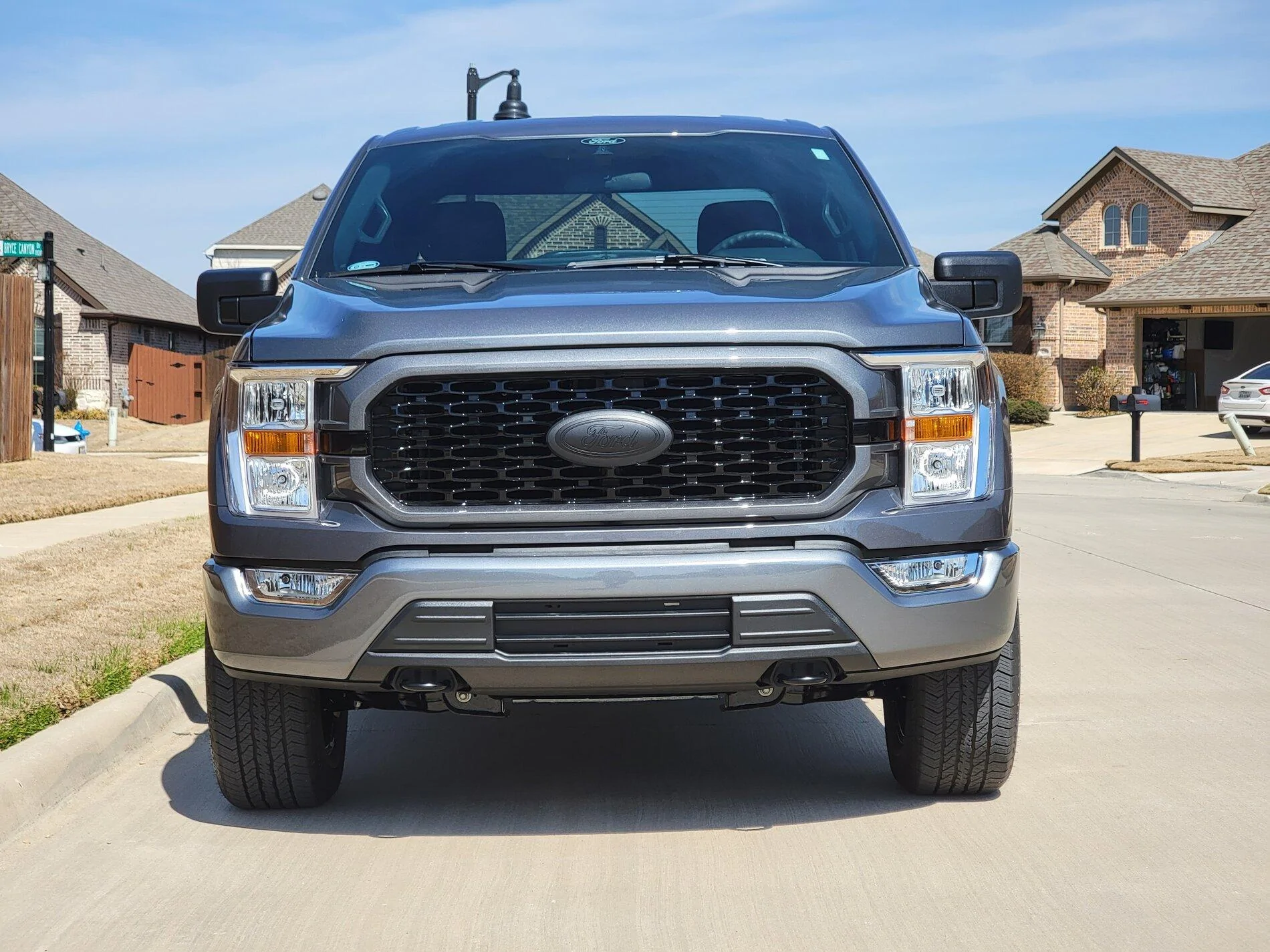

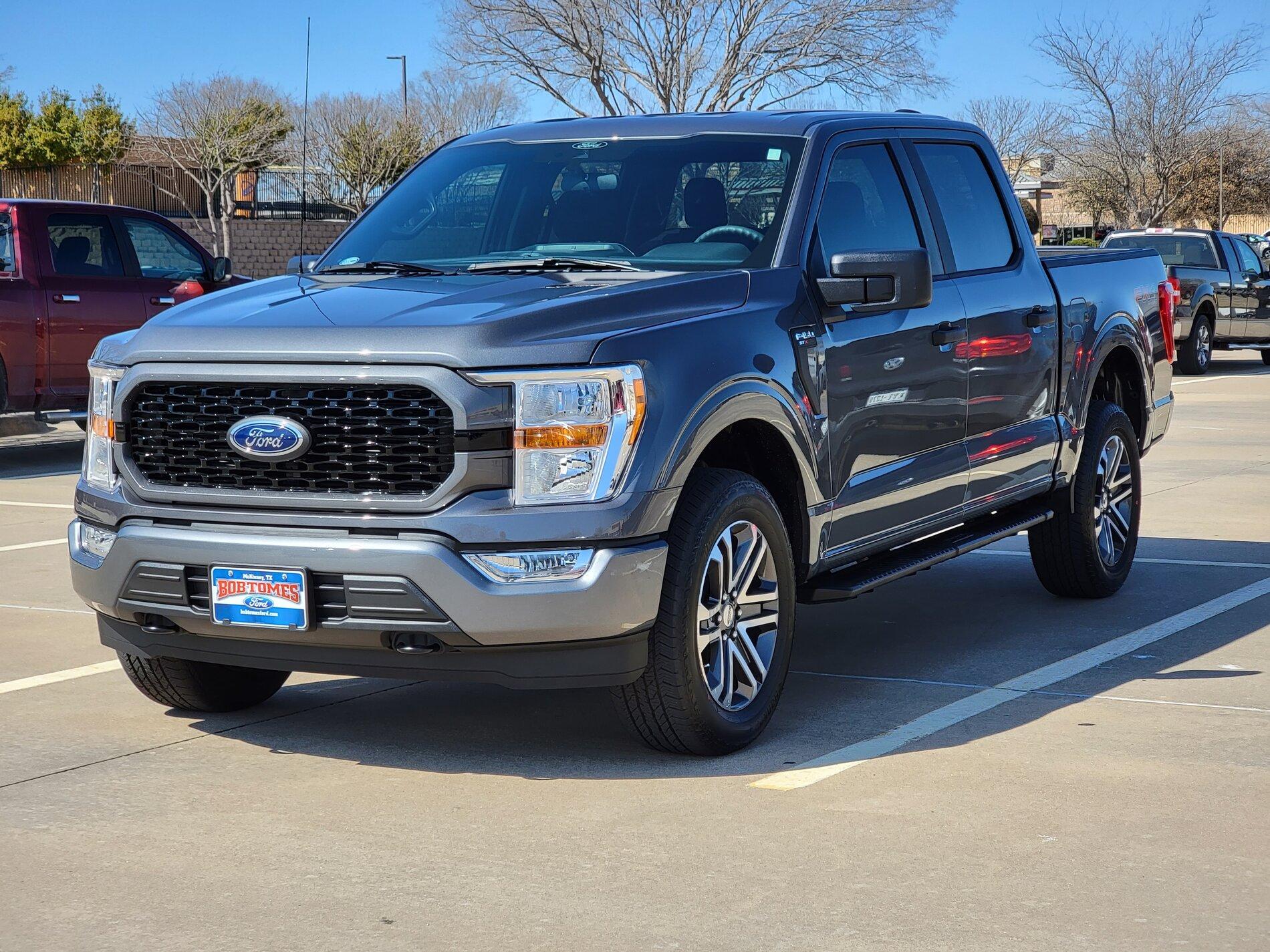

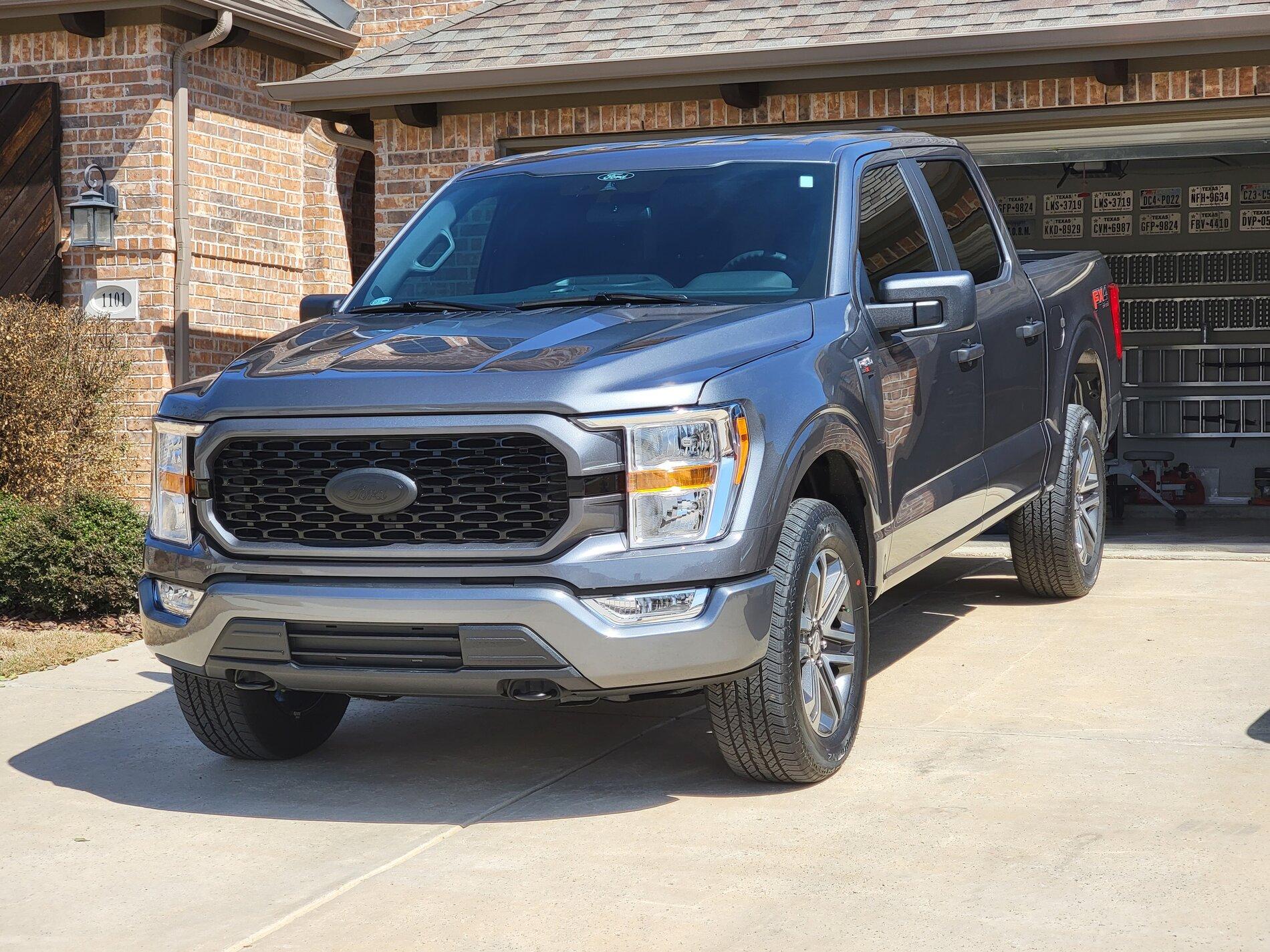

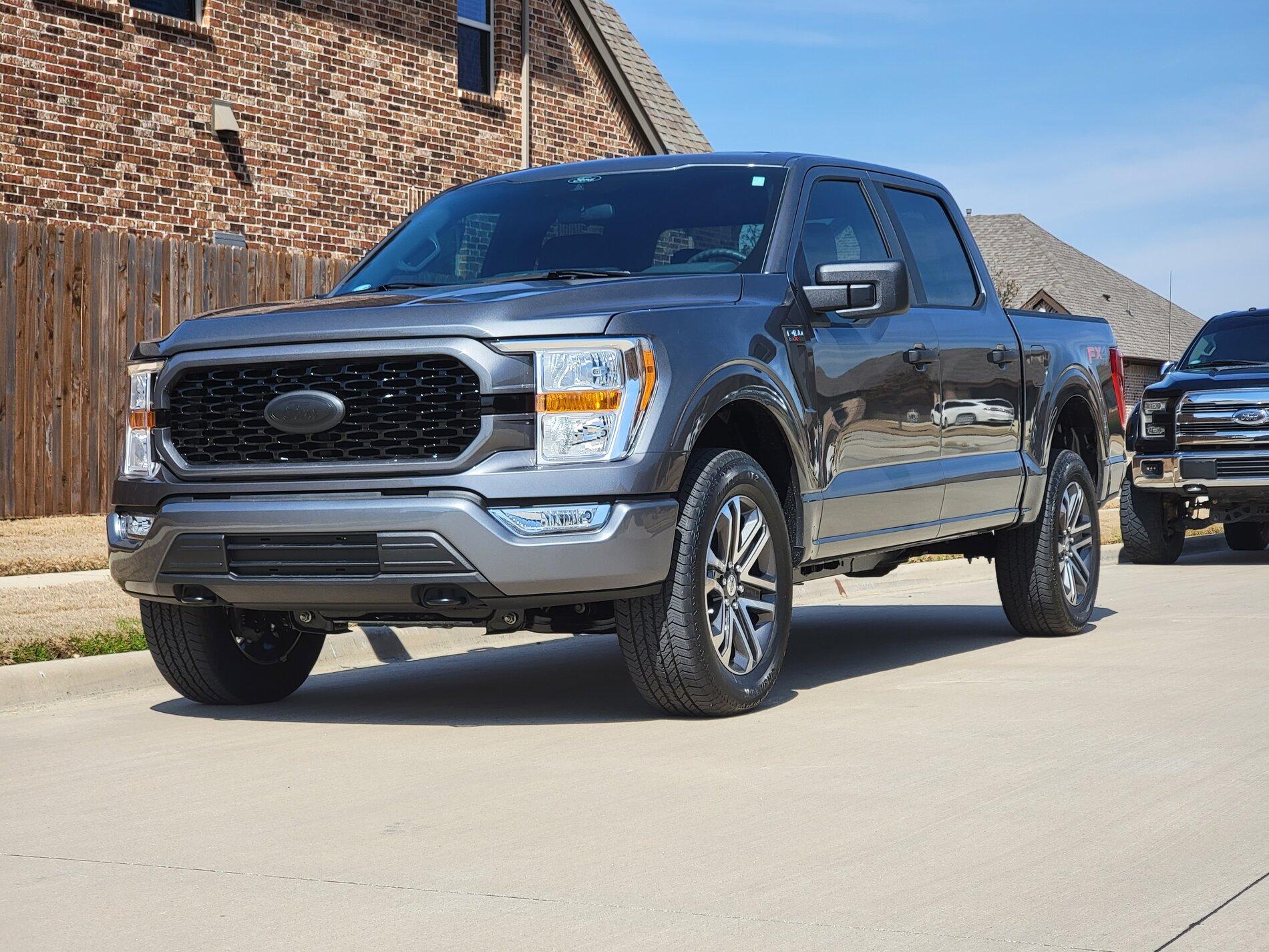

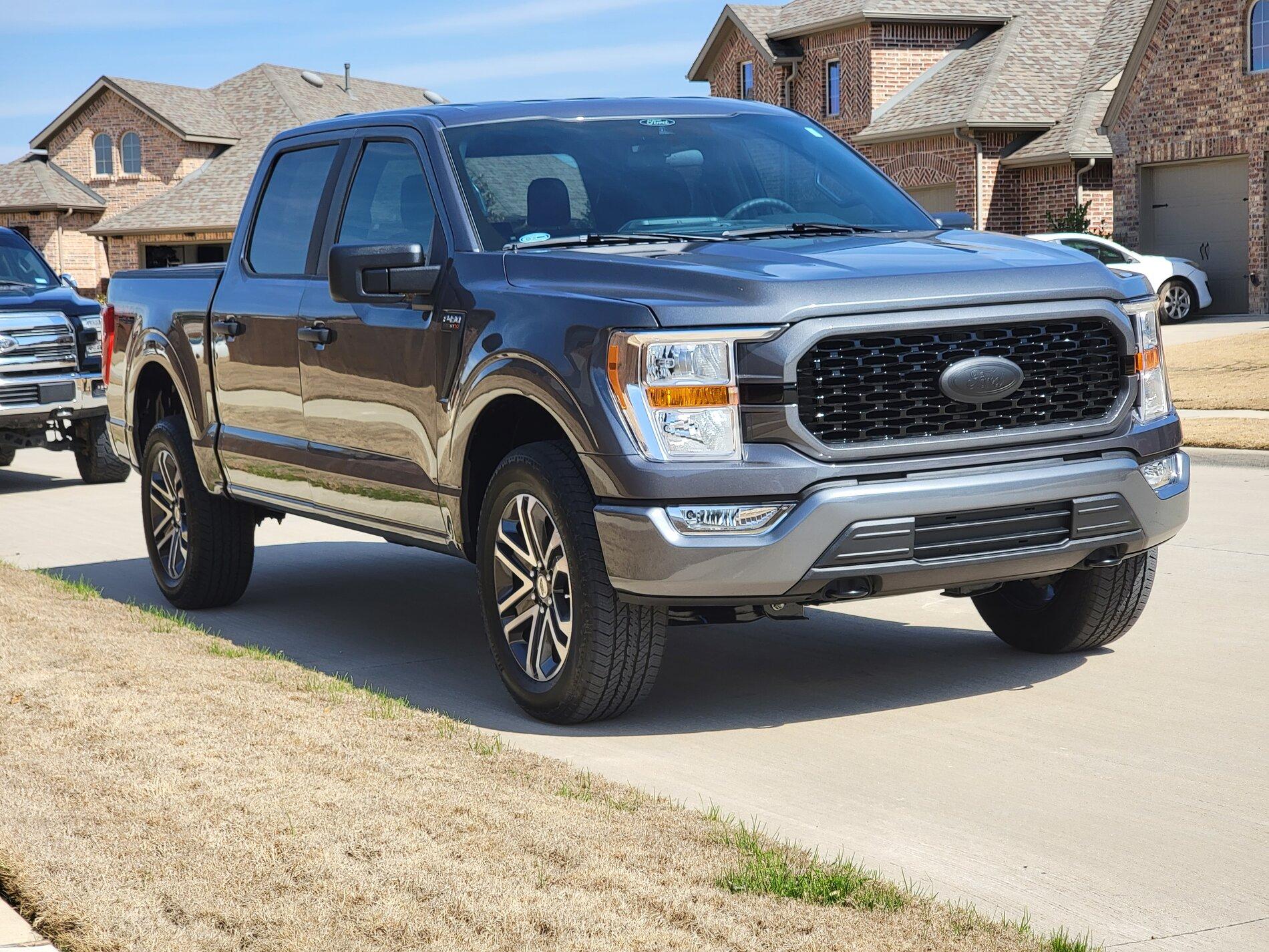

Daylight photos.
Before:
Ford F-150 Lightning Removed Active Air Dam From my F-150 - DIY Writeup 20210307_140206
After:
Ford F-150 Lightning Removed Active Air Dam From my F-150 - DIY Writeup 20210308_115125
Few more:
Ford F-150 Lightning Removed Active Air Dam From my F-150 - DIY Writeup 20210308_115135
Ford F-150 Lightning Removed Active Air Dam From my F-150 - DIY Writeup 20210308_115304
Ford F-150 Lightning Removed Active Air Dam From my F-150 - DIY Writeup 20210308_115510
Also removed the wind deflectors on the front of the rear wheel wells (as they would just get ripped off too.) They leave an unsightly hole in the side of the fender. Will need to find or fab a trim piece for that.
And I also removed the running boards because I'll be putting some low profile rock rails on as soon as they are available or fabbing my own.

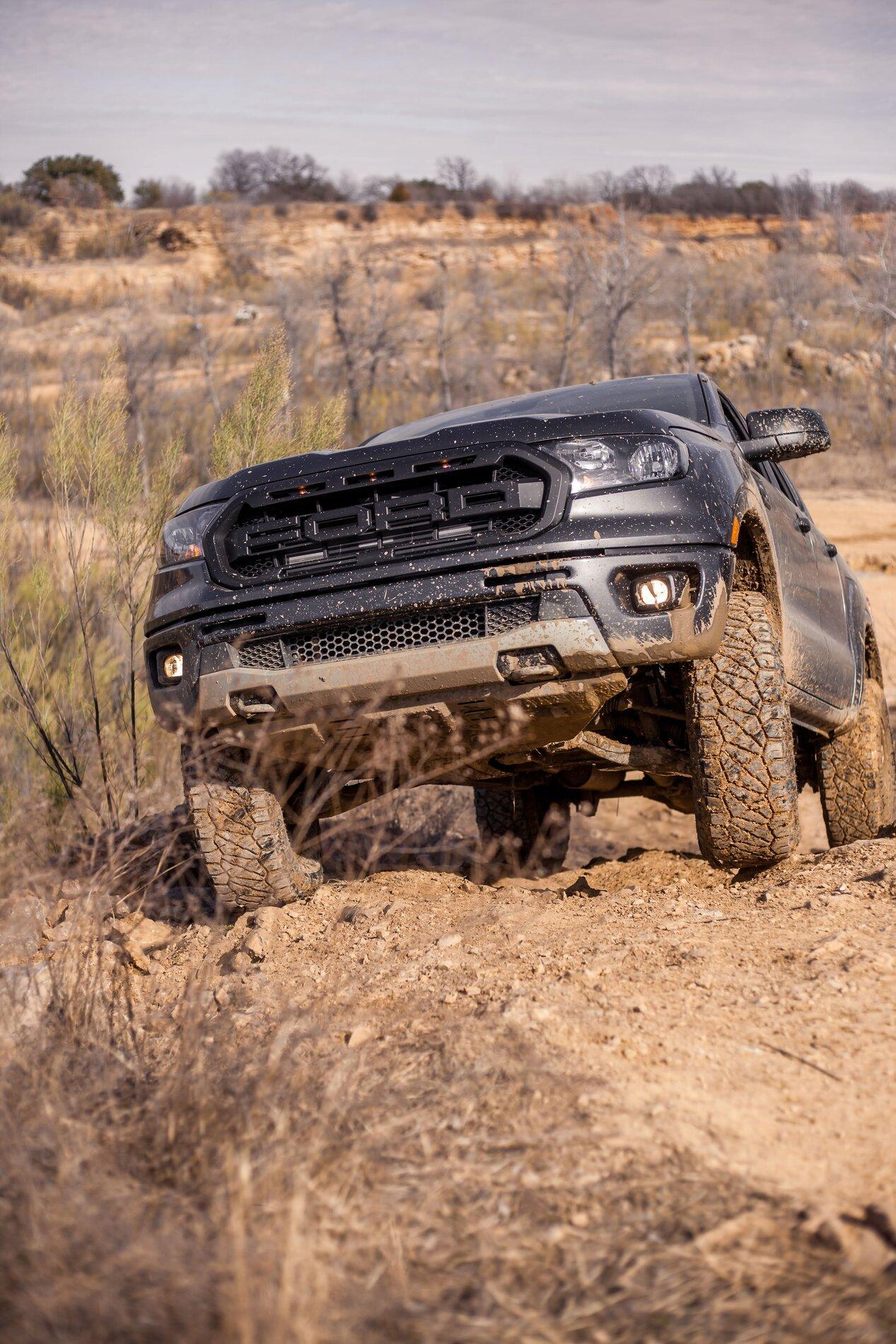

Nice job - looks good to me. One thing I am wondering about is what extra protection does the Tremor skid plate provide that the FX-4 skid plate doesn't. Is there other equipment that tremor skid plate protects, or is it just for looks?

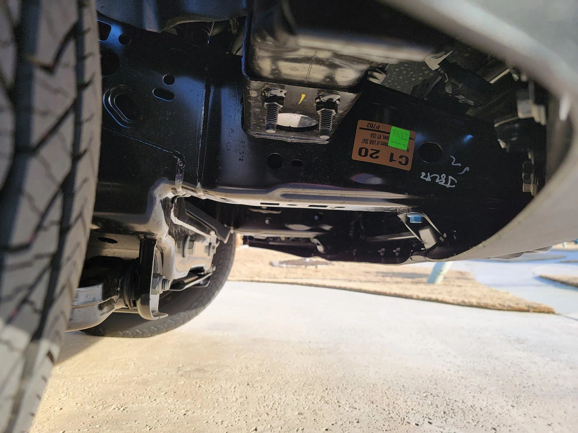

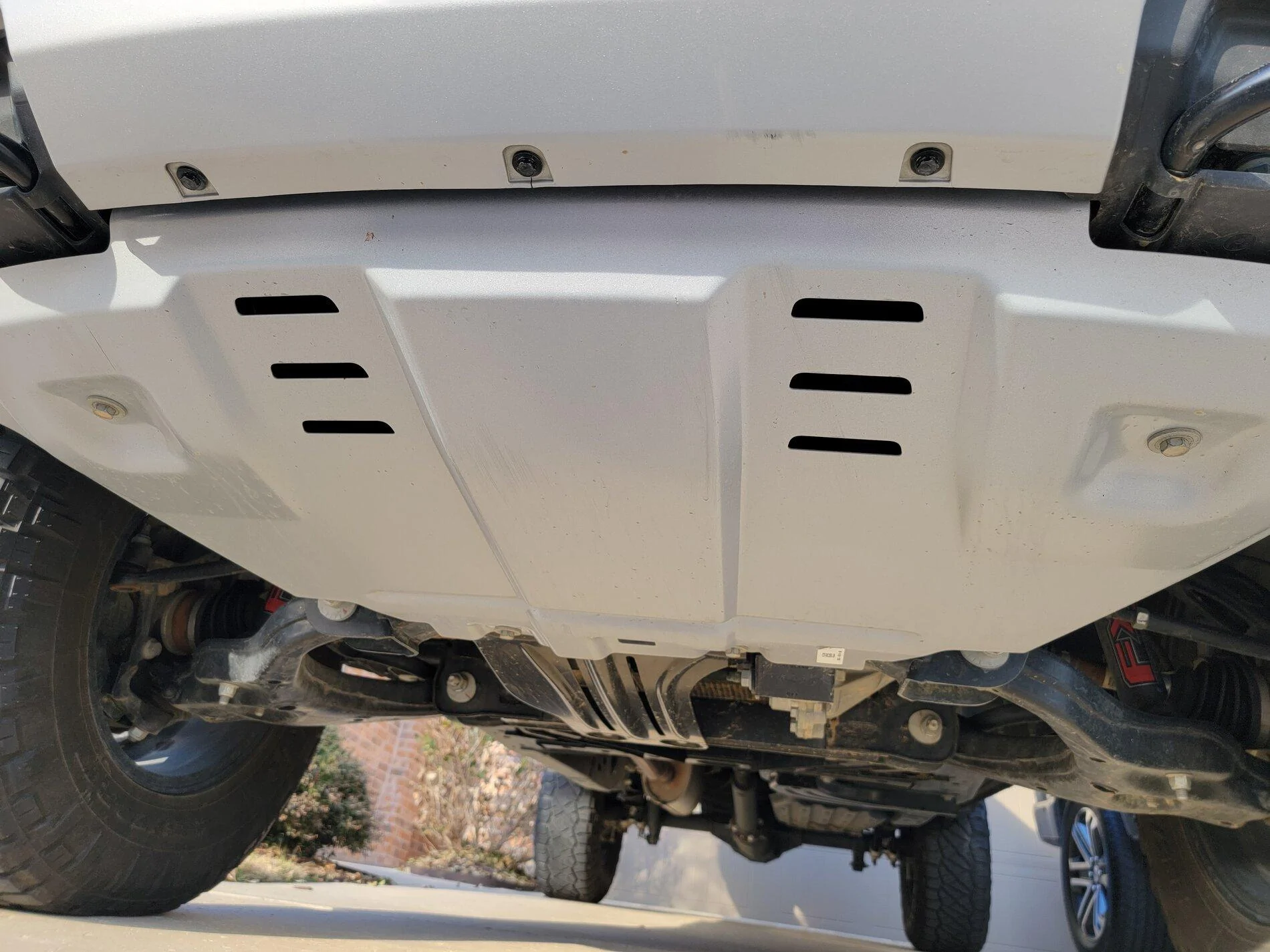

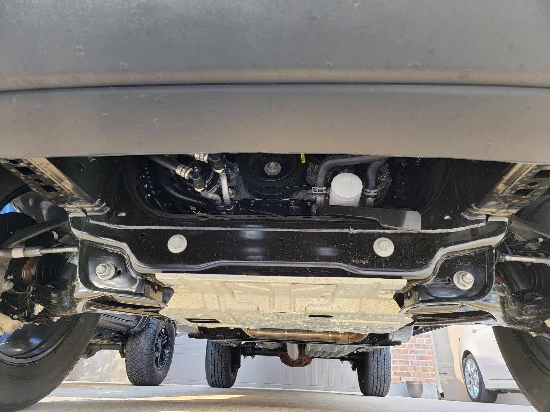

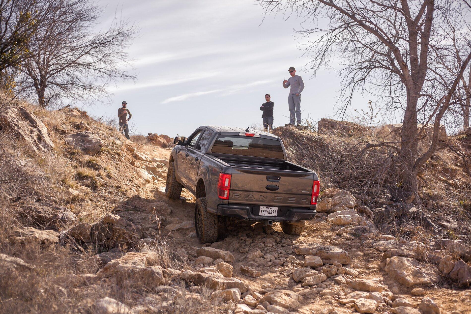

It does a few things. It provides a path for terrain/obstacles to follow so they are not caught on the K-Member which will help you slide over certain obstacles.
My Ranger:
Ford F-150 Lightning Removed Active Air Dam From my F-150 - DIY Writeup 20210308_171139
The F-150:
Ford F-150 Lightning Removed Active Air Dam From my F-150 - DIY Writeup 20210308_171150
It also protects the underside of the bumper to an extent if you hit an incline that exceeds your approach angle.
Ranger:
Ford F-150 Lightning Removed Active Air Dam From my F-150 - DIY Writeup 20210308_171527

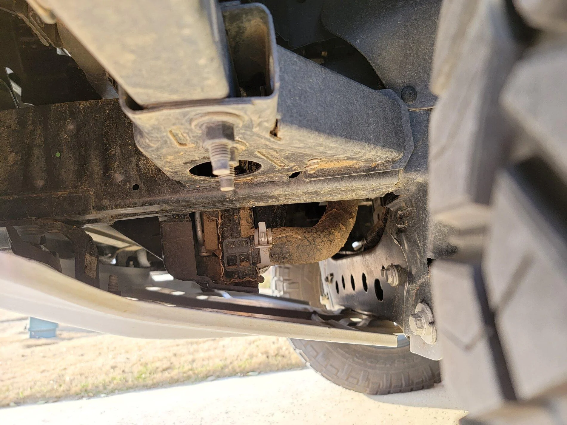

On my Ranger it also protects one of the radiators/heat exchangers:
Ford F-150 Lightning Removed Active Air Dam From my F-150 - DIY Writeup 20210308_171400
I have the Coyote on the F-150 so there is no extra baggage underneath, but its possible some of the *boost/stroke engine options have something hanging down there:

And finally, yes there is an aesthetic quality as well. I like the look.

Your truck looks great! Where are you finding the parts diagrams? Are you able to determine the thickness of the skid plates? Just curious if it is a "skid plate" or actually a skid plate.
Also, a little curious if you are able to see what the differences in the suspension components are? Just curious if you could easily slap the knuckles and control arms for the extra 1" of travel or is it more indepth.
