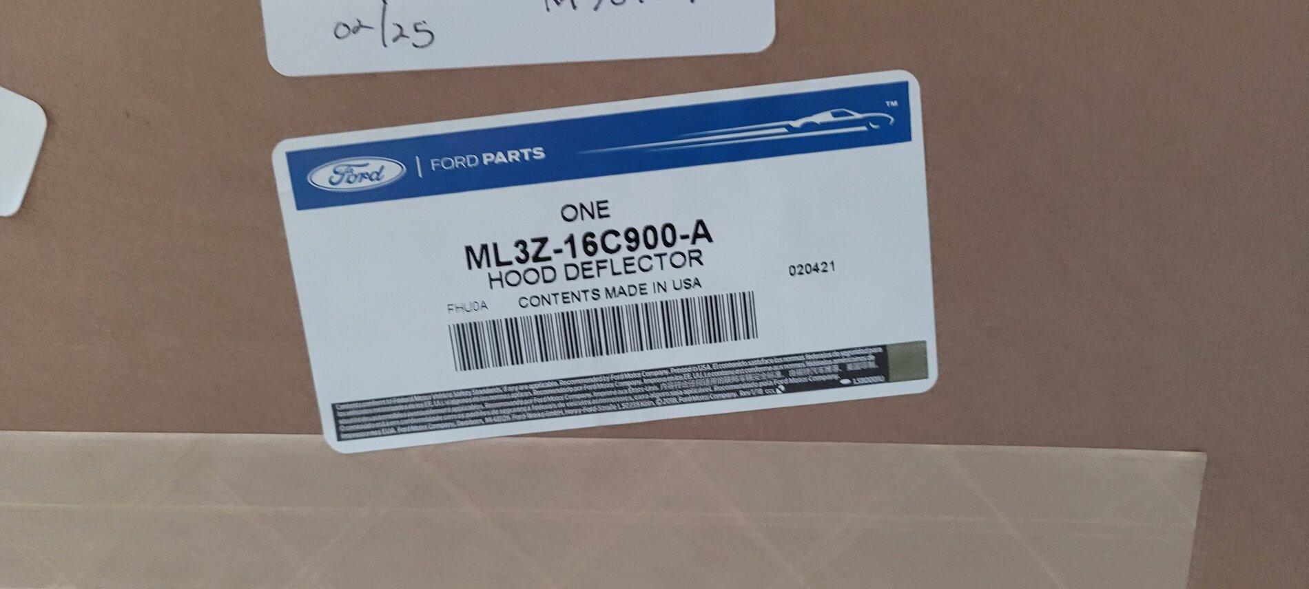

Here is the part #:
Ford F-150 Lightning Hood Deflector Installation - DIY Writeup 20210226_174002

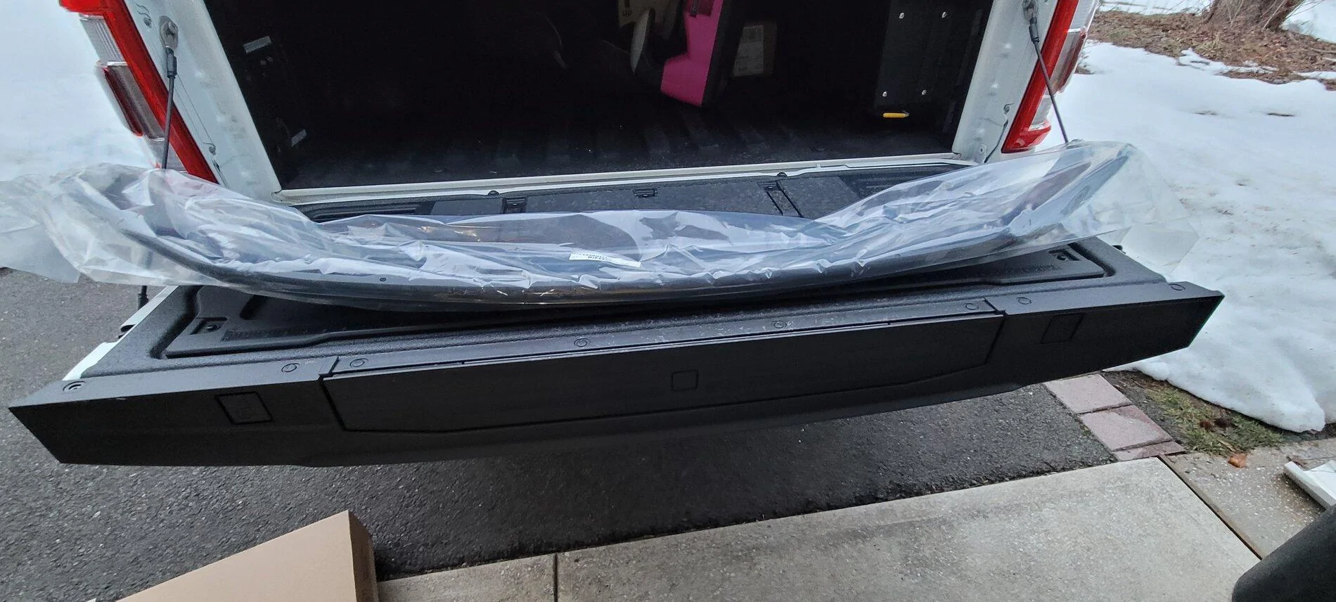

Package comes with protective wrapping and hardware:
Ford F-150 Lightning Hood Deflector Installation - DIY Writeup 20210226_174110

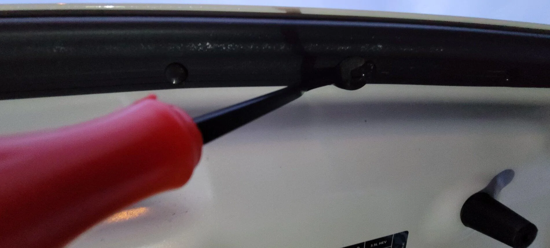

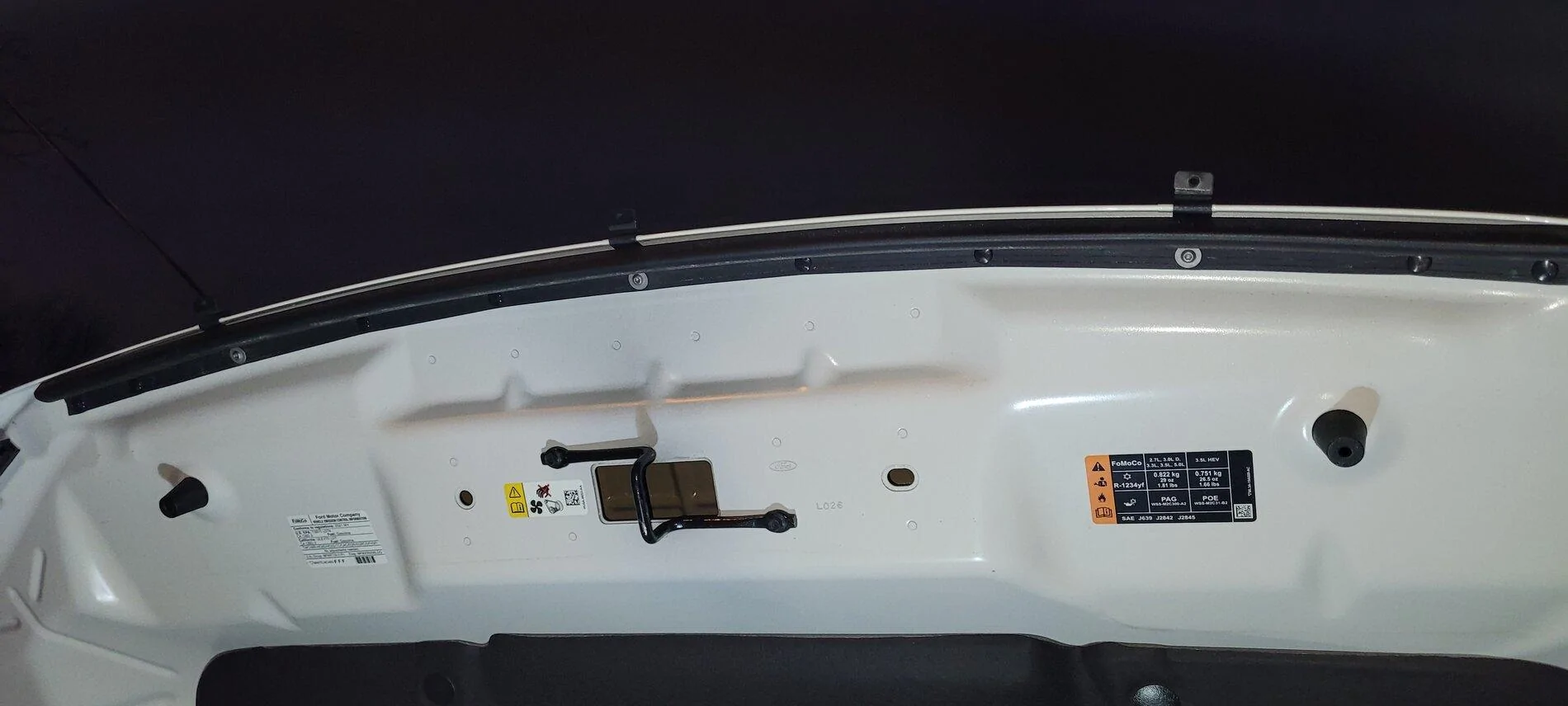

Open the hood and remove three fasteners on the weather stripping hood seal per instruction:
You will need a quality removing tool such as this one. The fasteners are locked in tight, I tried to remove it with the plastic tool and no go.
Ford F-150 Lightning Hood Deflector Installation - DIY Writeup 20210226_180015
Fasteners removed:
Ford F-150 Lightning Hood Deflector Installation - DIY Writeup 20210226_175952

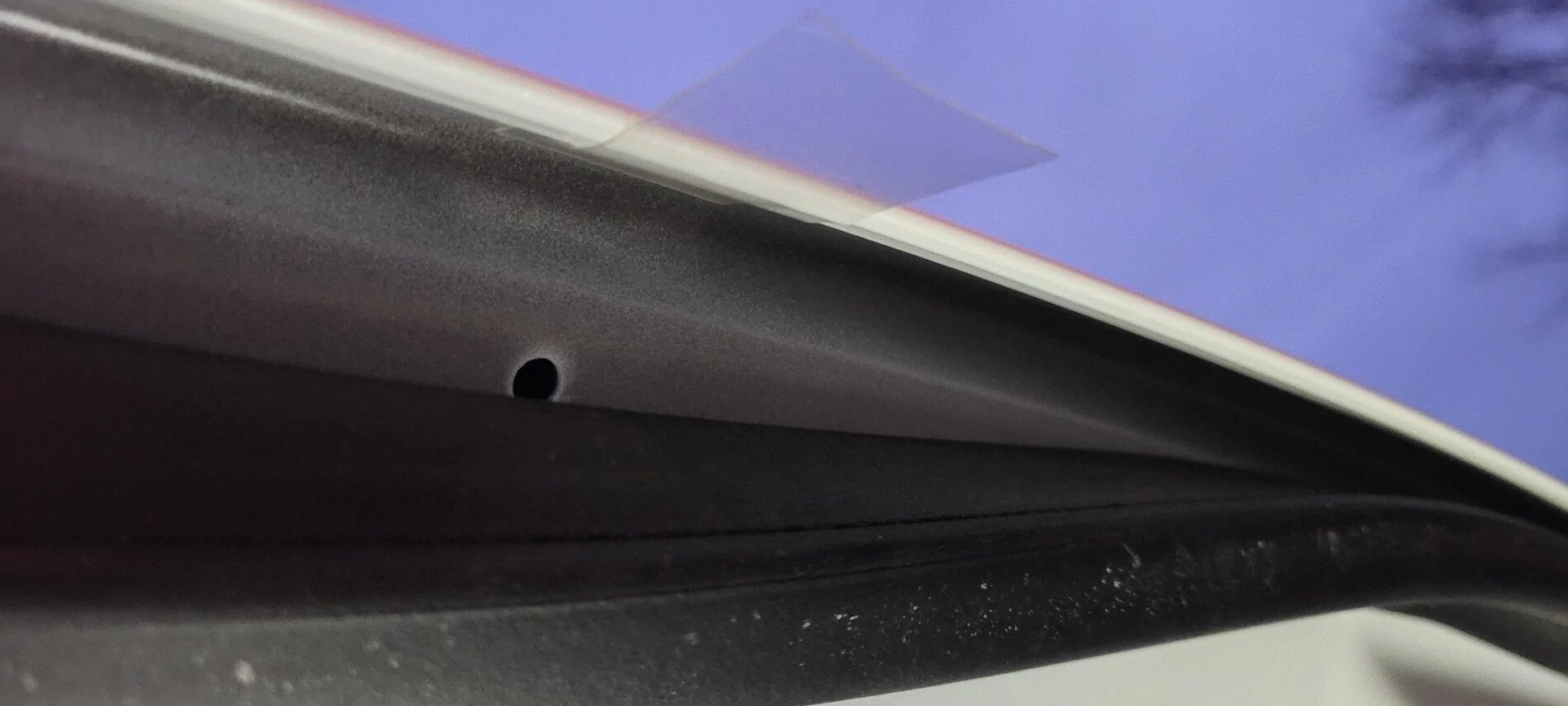

Clean the area with alcohol wipe (come with the package) and put on the protective sticker which should align with the hole as shown:
Ford F-150 Lightning Hood Deflector Installation - DIY Writeup 20210226_181047

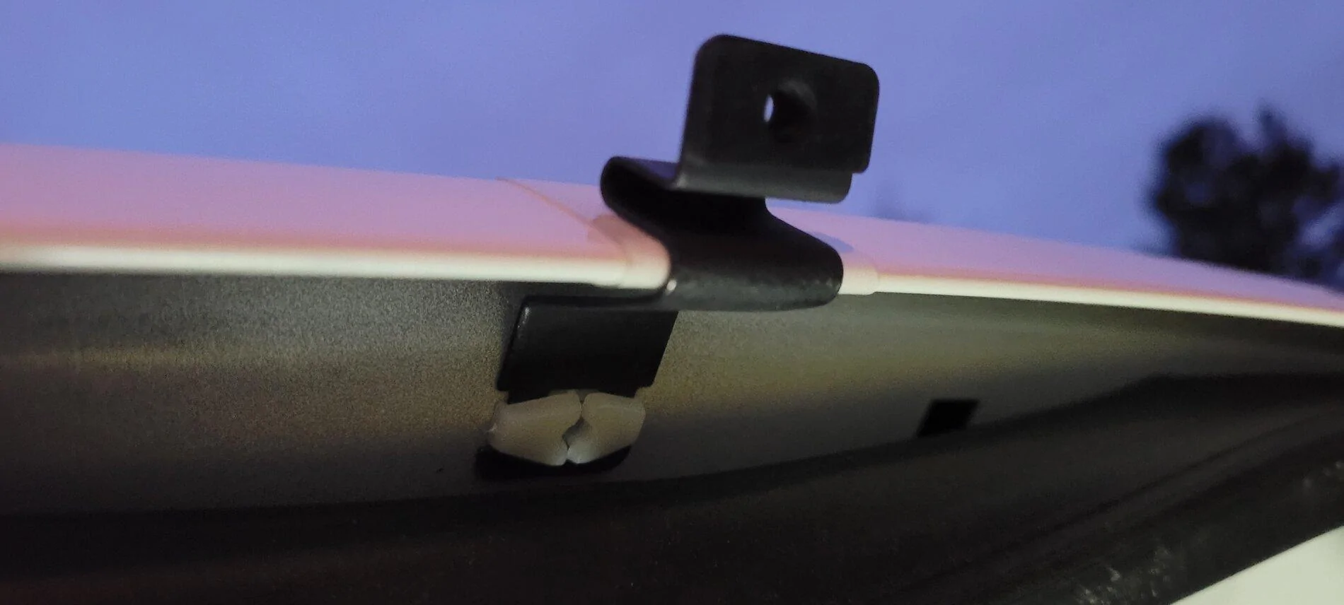

There are four additional clip-on brackets on the hood, two on each side right above the headlights:
Ford F-150 Lightning Hood Deflector Installation - DIY Writeup 20210227_100411

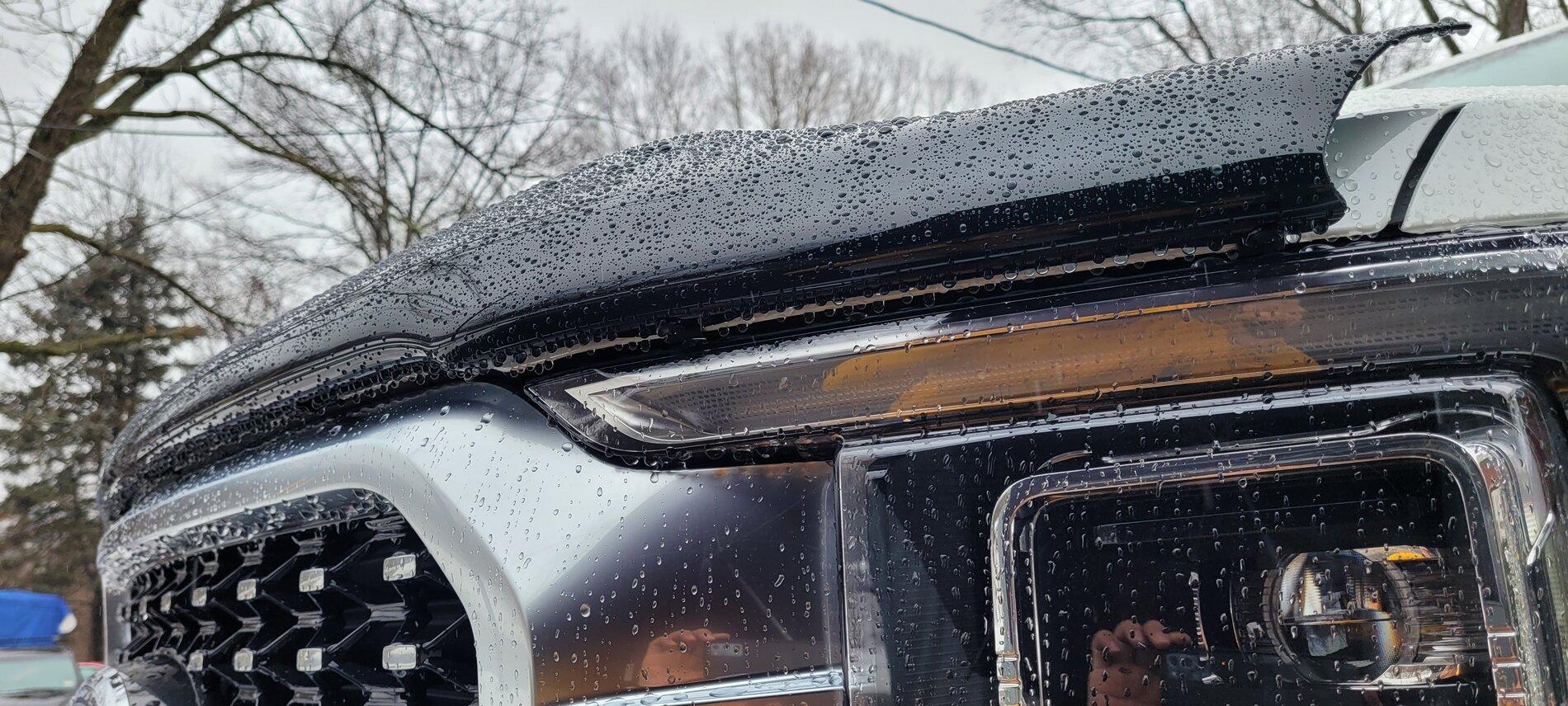

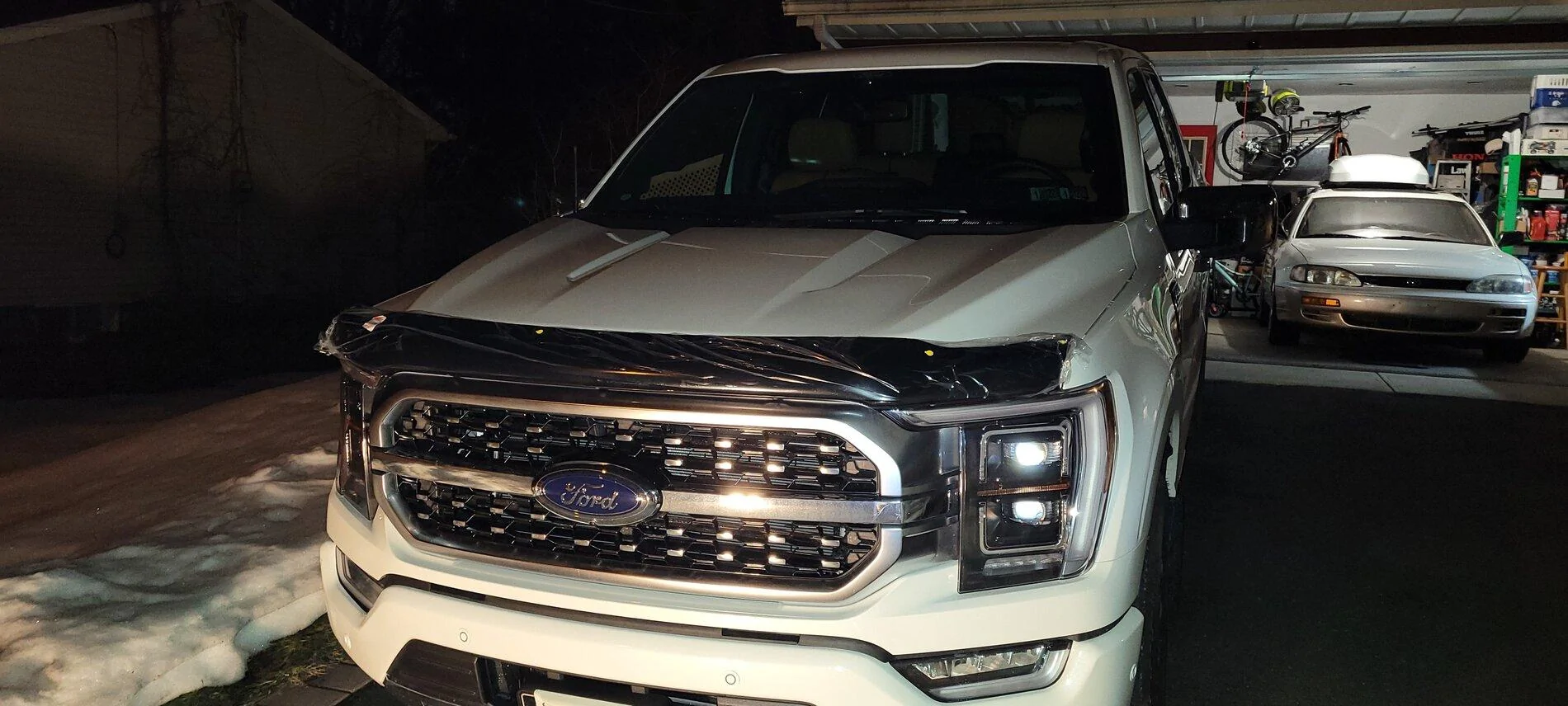

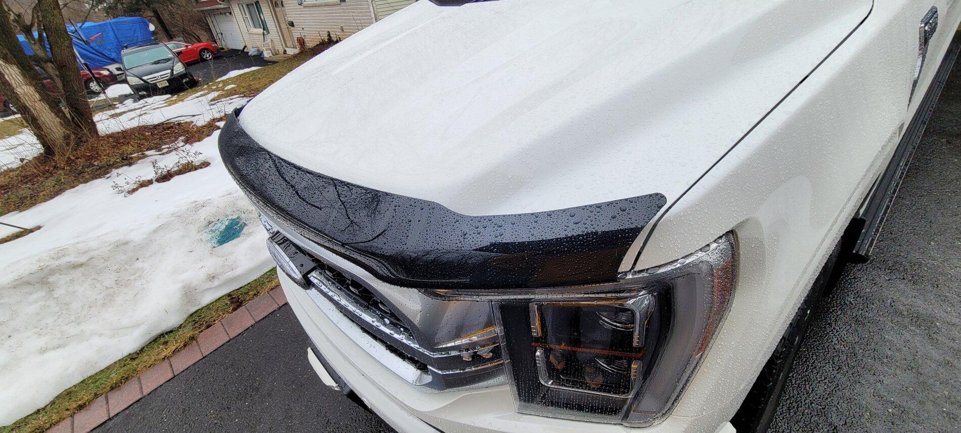

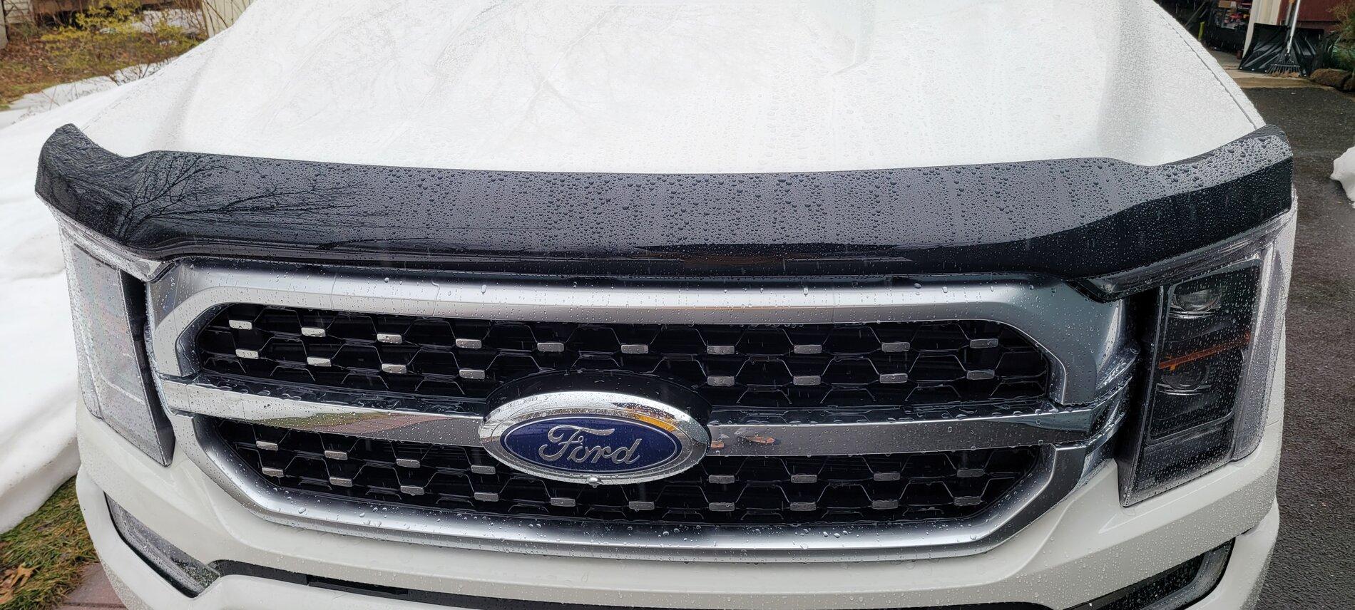

Installation complete:
Ford F-150 Lightning Hood Deflector Installation - DIY Writeup 20210227_100448
Enjoy!
Ford F-150 Lightning Hood Deflector Installation - DIY Writeup 20210227_100509
