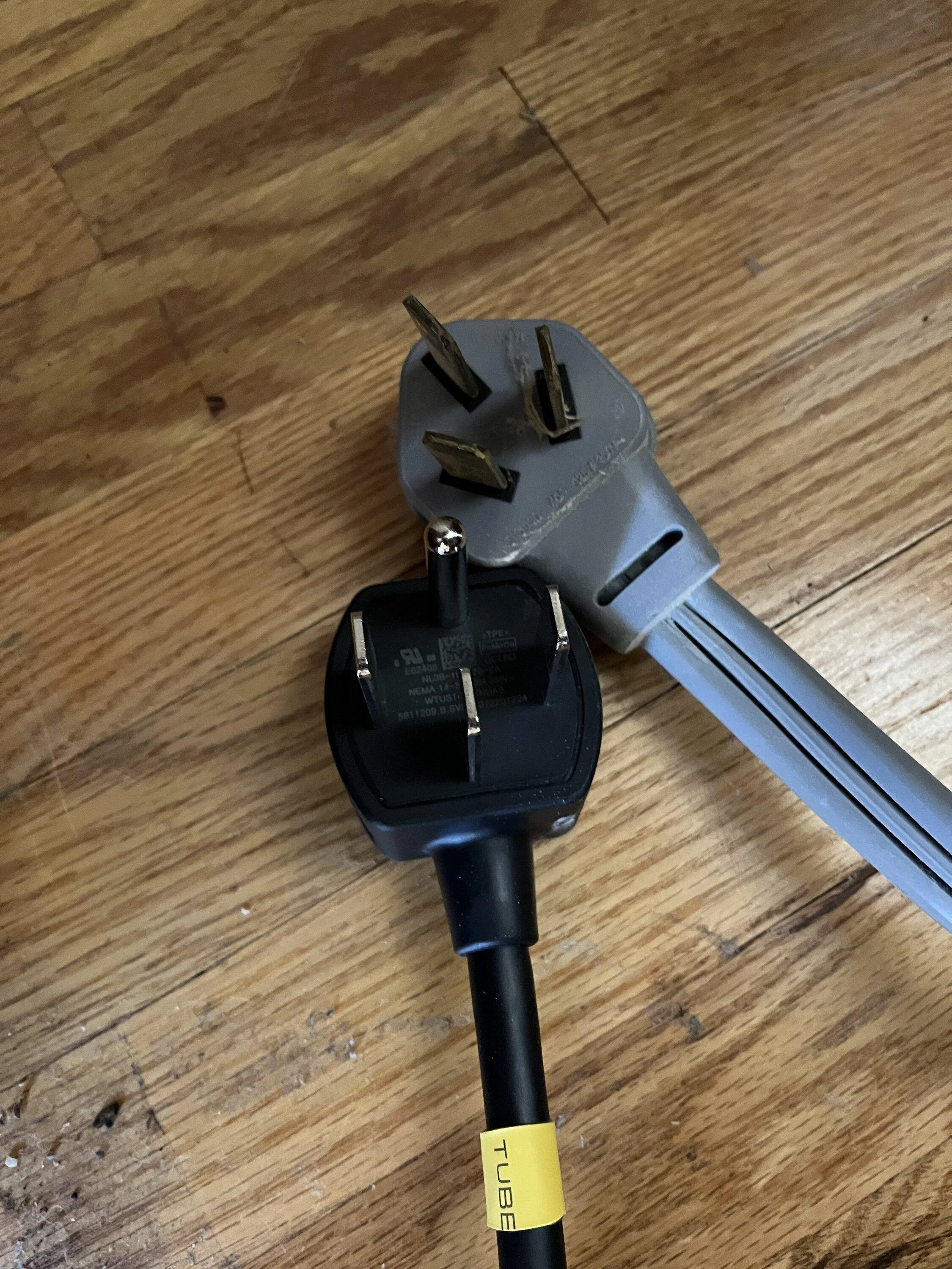

Adapter to use 240v Stove outlet for charging?

Nice! Been there. It's kind of a hassle but still satisfying to make it work.
Indeed….
And
yeah, my wife’s not happy with this EV life so far!
just temporary, I swear! You’ll get your kitchen back by midnight 🤣
