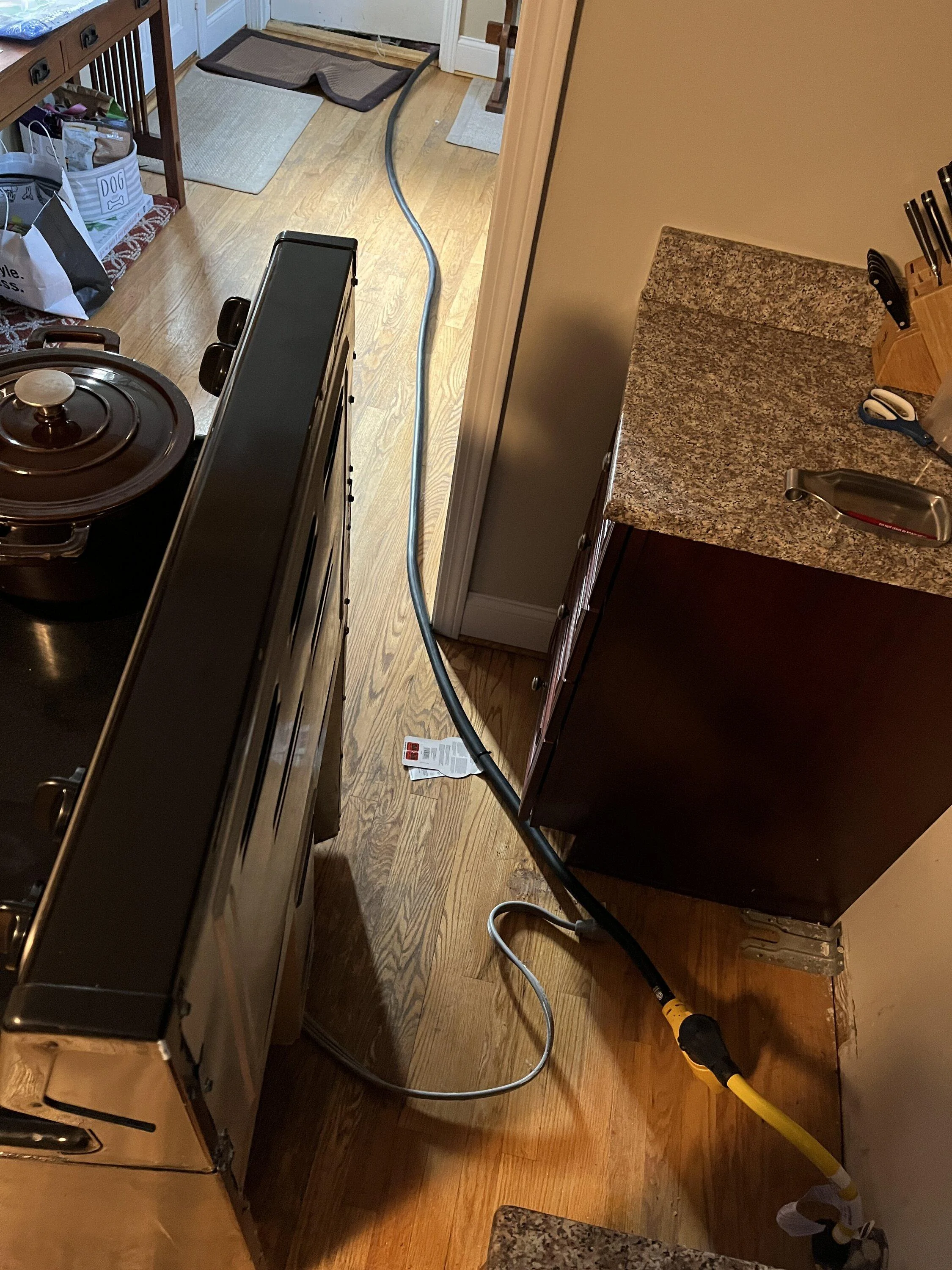

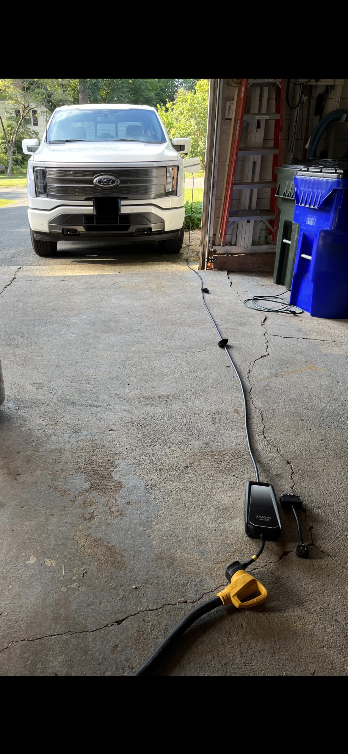

Thanks again for the help everyone. I got the setup working now, and it’s a piece of cake.
I went from charging 2 miles per hour from the standard wall outlet,
to 12 miles per hour off the stove outlet.
What a difference!! No wonder this cord is so thick.
I can see this coming in handy someday again if I’m somewhere without good local charging options, and I can use this to either hookup to a friend’s stove or dryer, or find an RV site perhaps.
This will work great Until the Charge Station Pro shows up, and I get all the permits needed, and then get it installed by a local electrician. And this avoids spending all the time finding, driving to and waiting for the charge at a Fast Charging site.
