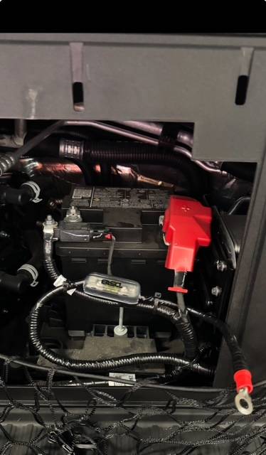

The 12v Power source is the 12v battery. The amp will be mounted in the back and the power is in the front trunk. As bad as that sounds installing the Power Cable was pretty straight forward. I used a piece of solid wire to fish the wire along the drivers side under the door trim. The front and rear door trim pop right out (straight up). That will give you access. I fed the wire from the rear door to the front, and then from the rear door to the back. Why did I choose to do the drivers side when others did the passenger side? The amp is located on the drivers side, the battery you will connect to is in the center of the trunk. Which brings up how do you get through the firewall? I used a audio grommet and drilled a hole.
Ford F-150 Lightning Add a Subwoofer to your Lightning 1743909295251-v
Installed looks like this:
Ford F-150 Lightning Add a Subwoofer to your Lightning 1743962713029-dl

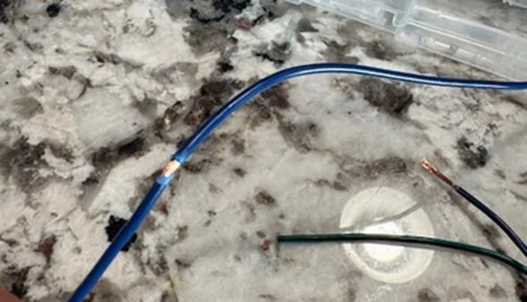

(ALWAYS INSTALL A FUSE CLOSEST to the power source, not the far end).
Ford F-150 Lightning Add a Subwoofer to your Lightning 1743963131033-l7
Notice the new wire in split loom and the fuse ziptied on the ground wire so it doesn't go anywhere. The wire lug goes on the battery with a 10m nut.
This gave me the straightest path of the wire. The wire was passed through the grommet with a little help from some dish soap. Where the wire comes out under the hood, I put it some protector (slit loom). This was pretty easy, but remember to measure before you drill. I did not drill anywhere. I knew exactly where the wire would come out. I choose a location just to the right of the main harness.

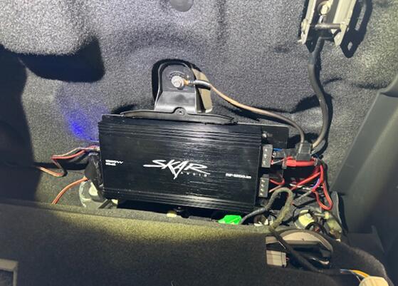

I used the old SUBWOOFER mount as a AMP rack for the AMP. The RP-1200.1D just happens to be the width of the 6x9 subwoofer. So it fits in that cage. It is thicker (taller) (and longer) so that subwoofer mount
needs to be adjusted. But good news is it’s all plastic. So a some Dremel later it all fit perfectly. I used a thin board (painted black) adhered to the mount for the sub to sit on. It sits at the same angle as the subwoofer. I used the bolt on one of the legs as a ground for the amp (and the ground on the Kicker keylok).

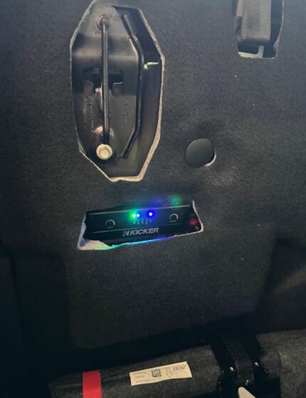

KEYLOC
You could probably use a cheap line out unit for just the Subwooder, BUT the Keyloc provides AMP ON signal for your SUB as well. I mounted the keyloc above the factory amplifier behind the passenger rear seat on the back of the cab. (I 3d printed a mount) there are some factory bolts that just needed 10 mm nuts, So I used those as a place to mount it. The Keyloc can be used with a Pac APH-FD02 cable to provide full range sound as the input, but I simply used the factory subwoofer as a source and it sounds real good. Gave the system what it was missing. (See Wiring for more on the Pac APH-FD02)

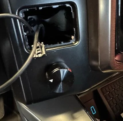

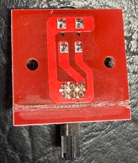

BASS KNOB

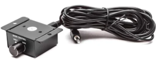

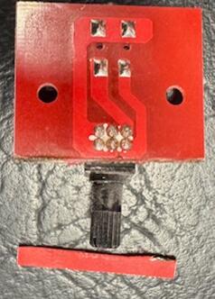

The Skar 1200.1D comes with a little tiny bass knob in a metal box.
Ford F-150 Lightning Add a Subwoofer to your Lightning 1743909341192-dx

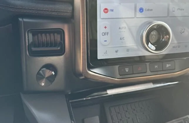

I’ve seen installations where guys put this between the seats, in the center console or even near the light switch on the dash. I wanted this in a location where is was easy to use, and not look like a add on. So I decided to drill a hole below the coin slot.
I changed the knob to a 40mm metal knob and 3d printed a mount. I removed the unit from the metal case. I printed a 3mm washer so that knob can never make contact with the dash (since it is metal)

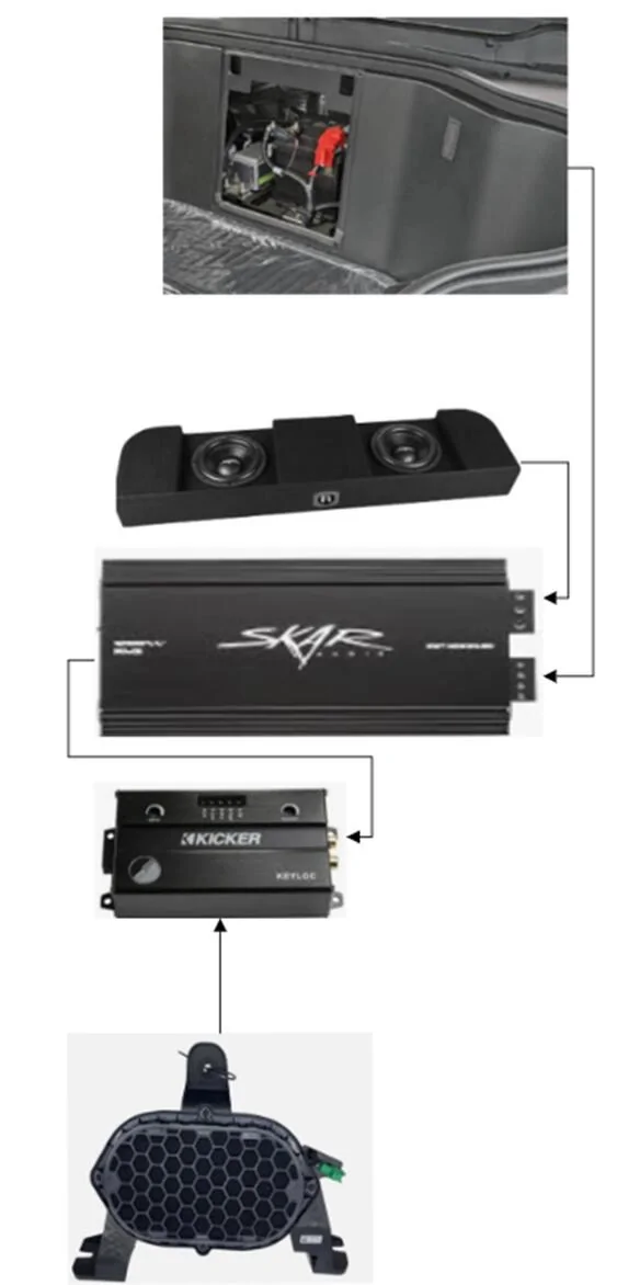

Wiring looks like this. 12V battery provides all of the power. Power is also run to the KICKER KEYLOC. The KEYLOC provides switched power (REM OUT) to the AMP. The Remote In on the KEYLOC is run to along with the R- and R+, L – and L+ to the existing subwoofer output. This provides the signal for the AMP, via the KEYLOC. The KEYLOC also uses that signal to generate a TURN ON feed for itself and the AMP.

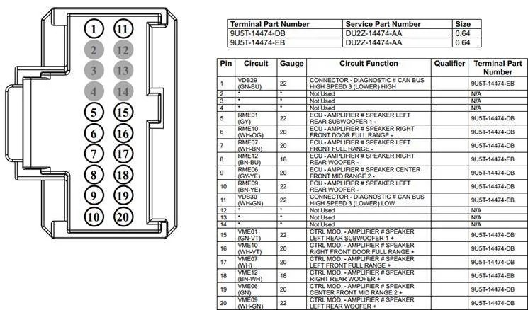

Tabs need to be snipped on both the harness side and the AMP factory connector. The labels on the wiring is wrong. Some wires may be removed!
This harness needs to be setup as a pass through. All of the speaker wires are left unterminated. Interestingly the harness as 2 subwoofers feeds for left and right which also matches the factory harness.
Ford F-150 Lightning Add a Subwoofer to your Lightning 1743909390223-mr
(Notice the tweeters and center dash speaker do not go through the rear amp, they feed from the dash)

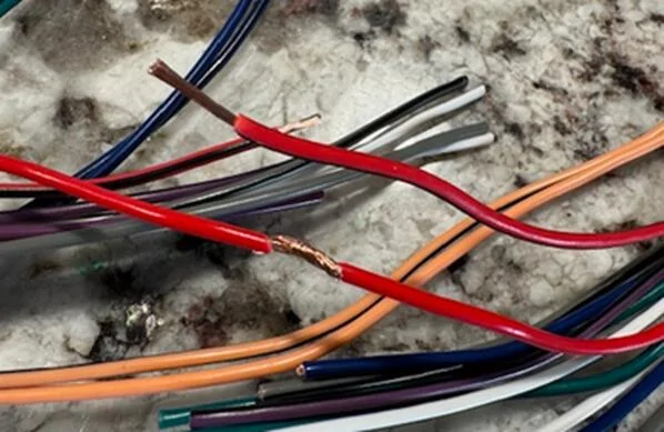

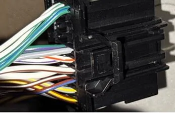

I cut 6 of the orange wires that are NOT USED on the harness. Do NOT cut the first 2 orange wires (those are CAN BUS).
For Reference here is my factory plug (2024 Larait) which matches the color codes above.
Ford F-150 Lightning Add a Subwoofer to your Lightning 1743909401824-k7

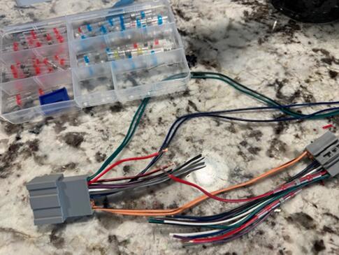

On the APH-FD02

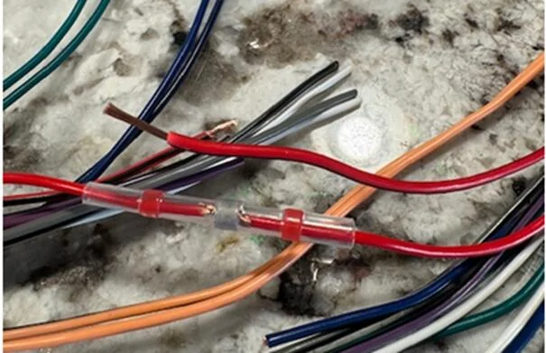

Cut the 6 unused wires on both ends.

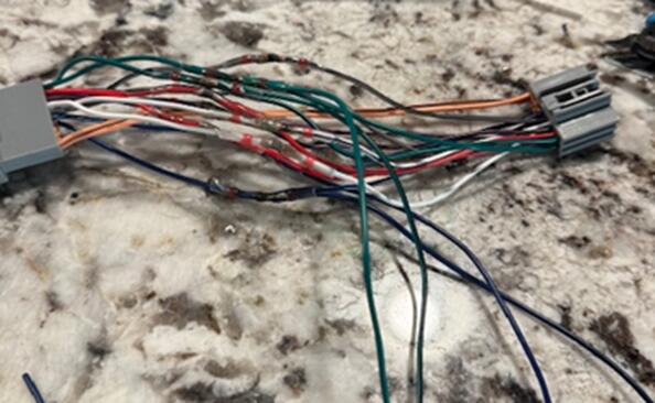

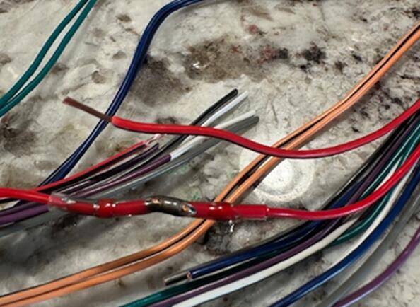

What we need to do:

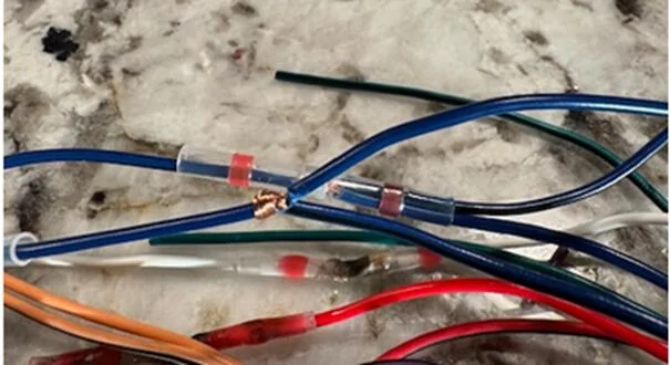

Connect all the wires back together so that they are a pass thru. This will keep your existing system working.
Ford F-150 Lightning Add a Subwoofer to your Lightning 1743909432305-7m
What I am using here are heat shrink solder connectors: slip on a connector, twist your wires together, slide the connector over the wire, apply heat (lighter, candle etc) and the tubing shrinks and the solder melts into the wires.
Ford F-150 Lightning Add a Subwoofer to your Lightning 1743909440910-s6
Ford F-150 Lightning Add a Subwoofer to your Lightning 1743909455080-ss
Ford F-150 Lightning Add a Subwoofer to your Lightning 1743909468649-a
Ford F-150 Lightning Add a Subwoofer to your Lightning 1743909475942-or

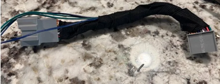

When you are done you will have something like this:
Ford F-150 Lightning Add a Subwoofer to your Lightning 1743909514033-hc

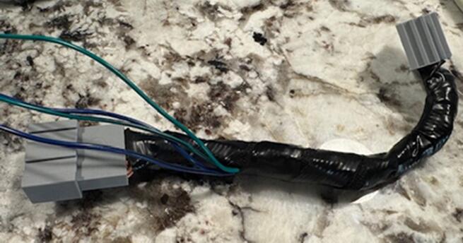

Wrap it with some fabric tape
(Notice the notch snipped o5 the connector to fit our trucks)
Ford F-150 Lightning Add a Subwoofer to your Lightning 1743909524992-a9
And finally some electrical tape. You should now have a pass through cable. The 4 wires hanging out are from pins 5,15 and 20,20
Ford F-150 Lightning Add a Subwoofer to your Lightning 1743909534271-ux

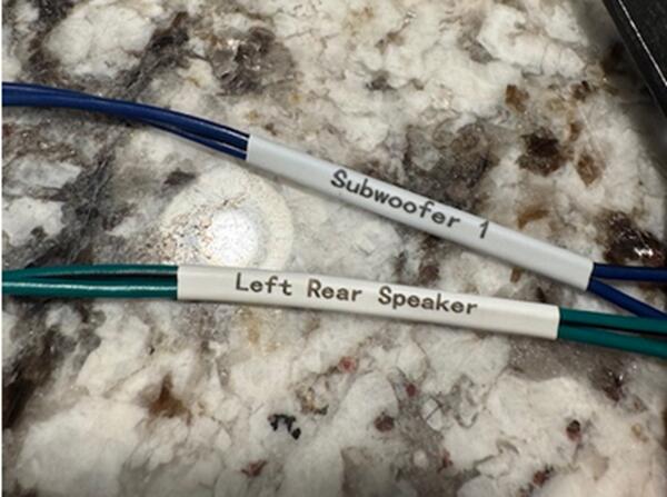

The wires are miss labeled as this PAC adapter is for a di5erent application.

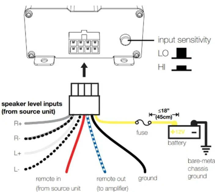

BASIC WIRING DIAGRAM
Ford F-150 Lightning Add a Subwoofer to your Lightning 1743909552835-ju
2 ways to get the source of the audio
Option1:
(Factory Subwoofer Bass roll-off)
From the subwoofer feed (use the plug that was plugged into your subwoofer)
Ford F-150 Lightning Add a Subwoofer to your Lightning 1743909584473-ct
It comes o5 the back of the speaker. You wire white to R+, L+ and REMOTE IN. You wire the black wire to R-, L- to the KEYLOC
Ford F-150 Lightning Add a Subwoofer to your Lightning 1743909591721-d5
Option 2: (Factory Bass roll-off fix)
Use the APH-FD02 harness you made.
Ford F-150 Lightning Add a Subwoofer to your Lightning 1743909635245-en
Ford F-150 Lightning Add a Subwoofer to your Lightning 1743909640076-7i
Connect your 4 wires to the R+,R-,L+,LConnect the remote in to the R+ line as well. This triggers the KEYLOC to turn on.

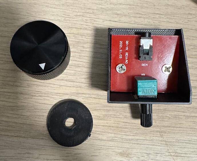

Extras (3D Prints)
These are all on THINGIVERSE under my name daczone If using the BASS KNOB from SKAR, trim off part of the circuit board.
Ford F-150 Lightning Add a Subwoofer to your Lightning 1743909661866-2
Ford F-150 Lightning Add a Subwoofer to your Lightning 1743909667220-s2
This will allow the shaft to be longer and go through your dash. I designed this mount to hold the circuit board securely
Ford F-150 Lightning Add a Subwoofer to your Lightning 1743909679125-cf
Knob from Amazon.
Ford F-150 Lightning Add a Subwoofer to your Lightning 1743909688113-nu
Results.... It sounds INCREDIBLE

Reused the Speaker Mount as a AMP Rack (Dremel away!)

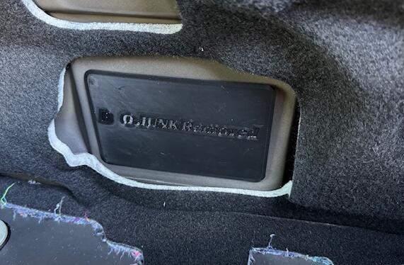

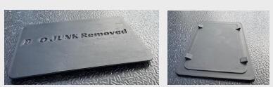

I also did a 3d print for block off plate for the factory subwoofer, otherwise you will have a big hole in the back of your truck. also a mount for the keyloc. There are bolts already above the factory amp. My mount allows you to use this area to securely mount the keyloc.
Ford F-150 Lightning Add a Subwoofer to your Lightning 1743962973067-x4
This is the HOLE behind your subwoofer:
Ford F-150 Lightning Add a Subwoofer to your Lightning 1743962866065-80

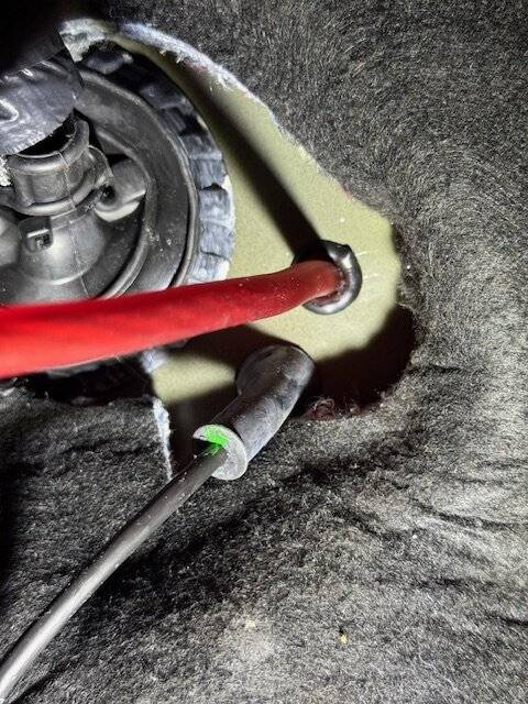

Can you post a photo of where you drilled the pass through?
daczone
daczone
Mar 10, 2025
95
193
Oregon
2024 Lightning Lariat
I did NOT cut the carpet... almost like it belongs there. The other side you'll need to fish to get the wire. You can't reach it. But that was easy! I put slit loom wire protector over it on the outside (trunk)... wrapped in tape of course so it doesn't come off.
Ford F-150 Lightning Add a Subwoofer to your Lightning 1743962376099-k0
At the battery you can see the power wire. Zip tied a fuse on the ground wire.
ALWAYS INSTALL A FUSE CLOSEST to the power source (not the far end).
If the wire ever got pinched... you want the fuse to BLOW.

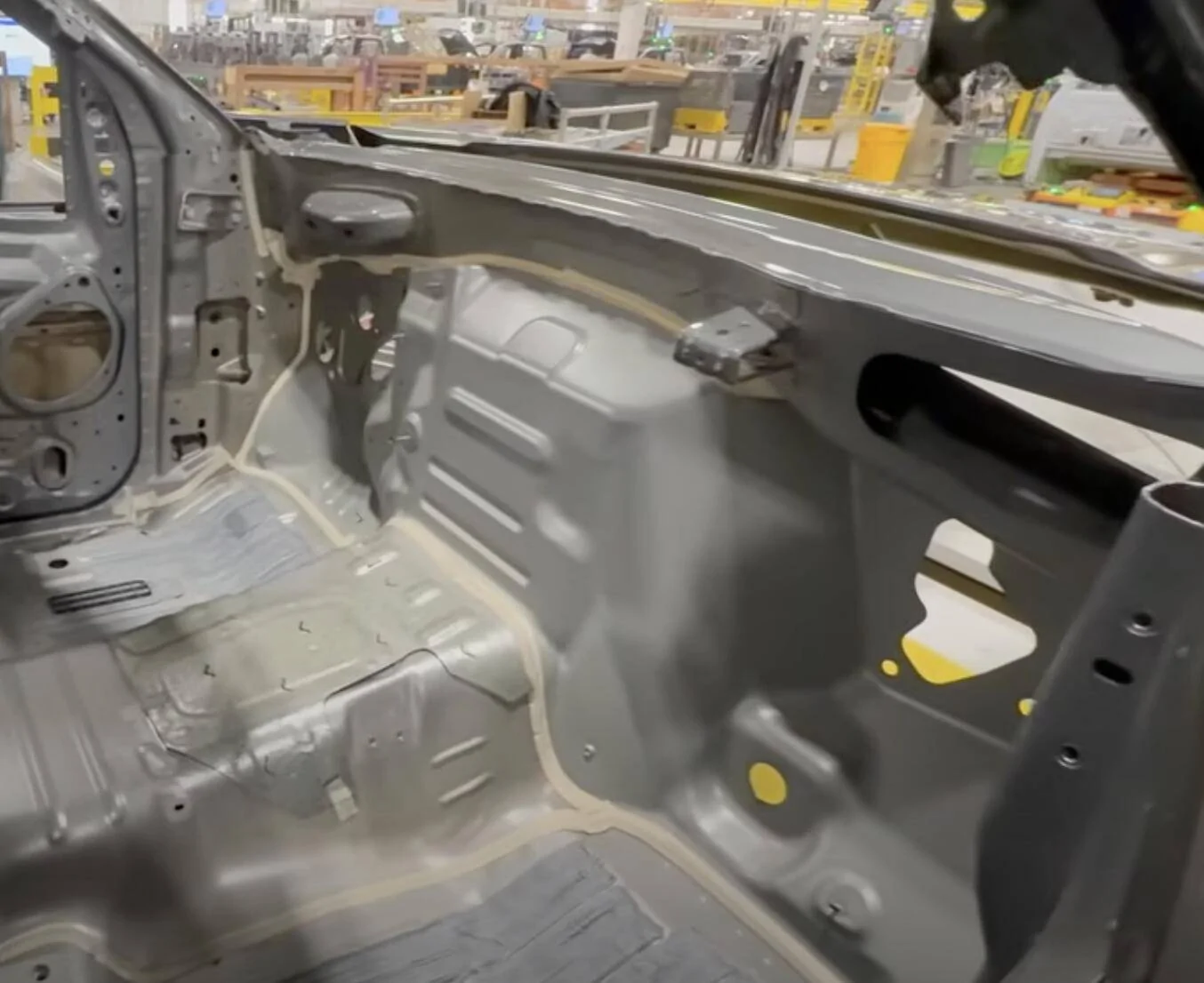

Would it be possible for you to describe where the picture of the hole (for the 12V lead) is located? Maybe you could identify the large and small rubber grommets in the photo? Thanks in advance,
Thanks for the writeup.
3,750
4,814
Very nice write up. You show your power, but where did you ground? Did you use the back of the cab near the seat latch on the driver side?
For those looking, I grabbed this photo from one of the factory tours that has been produced. It might give some ideas of where to get through the firewall.
5,15, 10 & 20? Just wanted to make sure.
