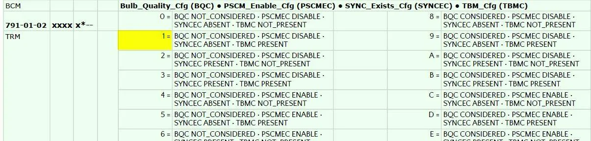

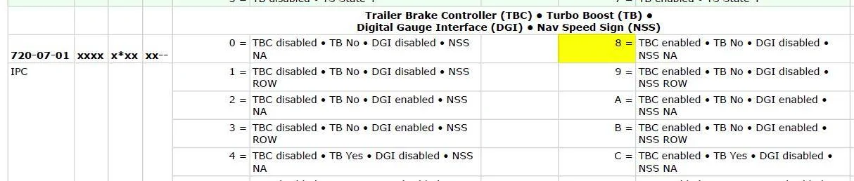

The key was changing the values associated to the attachment below. I can't remember who posted it, but it is pure gold when it comes to enabling this correctly.
I made the changes the highlighted values and the trailer brake controller came to life. I've tested and verified with a travel trailer that it now works. $140USD instead of $240 USD for the "Kit" (RL3Z-19H332-AA).

720-07-01 xxxx x*xx xx--
Lightnings with Tow have an "A" and without have a "2". Your "8" has disabled the Digital Gauge Interface.
If you had a "2" before, you should have "A" now to enable TBC.

791-01-02 xxxx x*--
For 2024, trucks with MaxTow have "5" and without have a "4". Pros have a "0".
Your "1" has disabled the PSCM.
If you had a"4" before, you should have a "5" now to enable TBM.

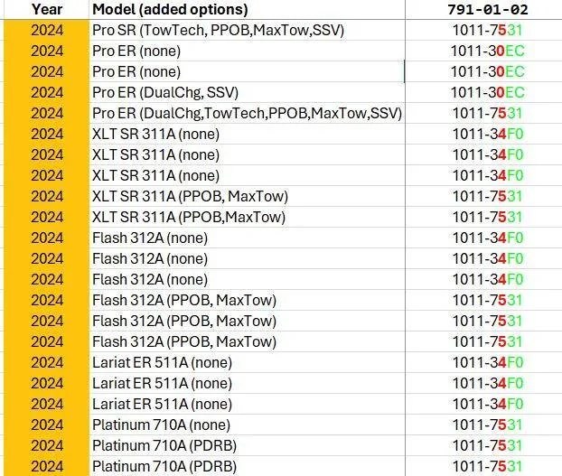

It's odd that your As-Built had a 0 there. The '22 and '23 trucks had either a "0" or "5" matching what you see. Not sure why the "4" option appeared just for 2024. Did you have a real early build 2024?
Here is my database of just 2024's. Byte 6 is highlighted in red. Green are check digits which can be ignored. I realize I don't have the Tow Tech package broken out. Edit: Factory Trailer Brake Controller included with MaxTow in 2024.

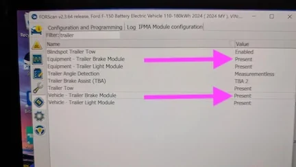

I was unable to load my IPMA (as-built) module. Kept getting "Service procedure has been interrupted" when trying to read the module. So, instead I used the non-as-built version and switched the following from "Not Present" to "Present":
Ford F-150 Lightning Added Factory Trailer Brake Controller to 24' Flash PXL_20250812_233518060.MP

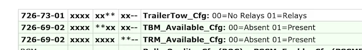

I did not make any changes to the first three blocks listed in TylerEgg's spreadsheet, but I did notice that in my As Built the third line is set to 01; the others are 00. Should I change these?
Ford F-150 Lightning Added Factory Trailer Brake Controller to 24' Flash Screenshot 2025-08-12 at 8.12.25 PM
@TylerEggs did you have to make any additional changes beyond what was in your spreadsheet? Any thoughts on the 726 module settings? Any other ideas for what the issue could be?
