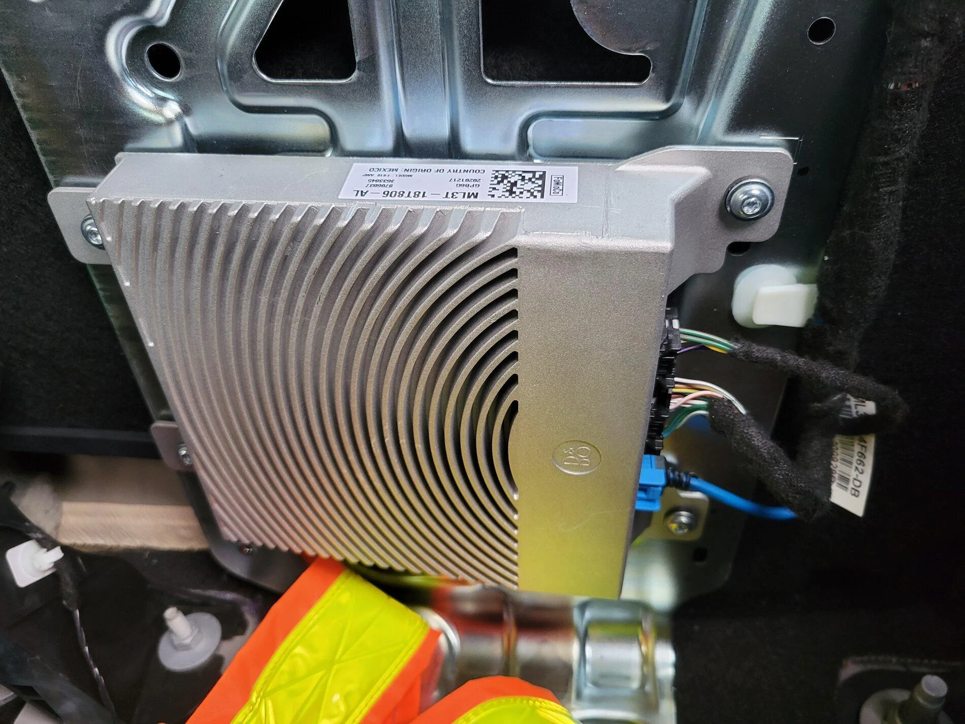

Now does anyone have wiring schematic for this, assuming I could just tap into it for High Speaker Inputs and Amp Remote?
Ford F-150 Lightning Adding a Sub to non-unleashed BO system 20210719_071817
