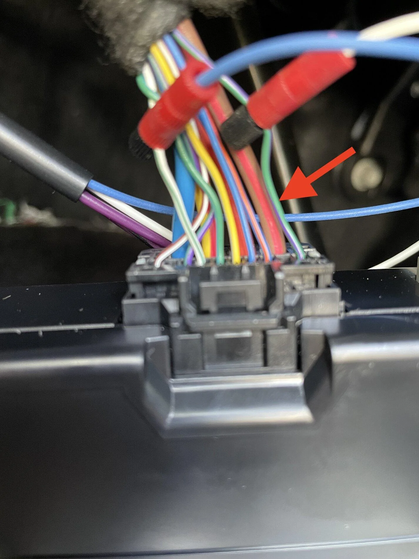

Alright guys. Tapping into the hive mind. Just finished(ish) installing my Amp boards. They deploy if I ground the purple wires. However they do not deploy when the door opens.
Interestingly I do not have a green/blue wire only a green/purple wire. (see below).
Anyone encounter this? Anyone recall the wire locations and if this looks correct?

I had the same issue. The wiring instructions are wrong. The two wires should be next to each other. Try hooking to the green wire next to the white with green stripe wire.

Just looking at mine now, I believe your white and blue wires are correct. Just backed up and read my old post. I mentioned in that post that one of the purple wires has a black stripe on it. And t the other purple wire doesn’t. Check and make sure they are right. Then check the posi-tap, remember one end is pointed the other is not.
You the man! That is exactly what it was. I swapped it over to the solid green wire next to the white/green wire, popped in the fuse and boom.
Guess I will let Amp know they need to update/correct the instructions.

Glad I could help. I was pretty upset when mine didn’t work and got in touch with AMP and they already knew the issue.

I had to look at mine again, yes mine also uses the solid green also. Good call, I guess I didn't get my head up in there far enough the first time. Glad to see you up and running.

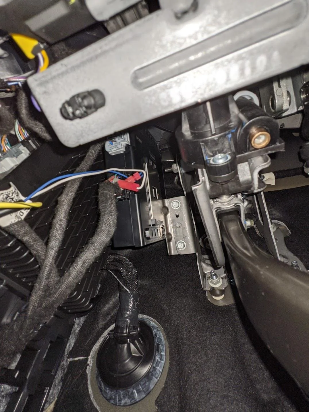

OK I installed the AMP ‘XTREME’ power steps today. They seem to be back ordered at most places, but P3 Performance Products had one in stock for me, shipped it quickly and it arrived within 3 days.
Install is pretty straightforward, except a few minor areas to watch for:
  1. Unlike previous year models, the 2021s require you to splice two wires into the factory canbus (previous year was OBD only no splicing was required). The difficulty is locating the darn wires to splice! There are about half dozen connectors in the driver’s footwell and they all have the blue/green and white/green wires that are referenced in the instructions. After trying two connectors and not working, I finally got the right wires in the third connector - it is one of two that plugs right into the ECU tucked near where the brake pedal exits the firewall - see pic below.
  2. You need 2 posi-tap connectors to splice into factory wires (see pic below) and they were missing in the package. I had a bunch in my garage so that saved me having to find them at a local store.
  3. The passenger side motor makes contact with the hoses/pipes that are routed adjacent to the frame In that area - see pic below. Not a big deal, I disconnected one mounting screw that held the hoses on the frame and just pushed the hoses up, but they do make contact with the motor FYI.
Anyway, the steps tuck in very nice and make the truck look so much better/taller. The steps are also lower than factory running boards when deployed which my old parents will appreciate.
Highly recommend P3 Performance Products, they had a great price on these and had them in stock, shipped it fast.
Thanks for the info! After time have you looked if there is any wear on the lines from rubbing on the motor? That would be my only concern
