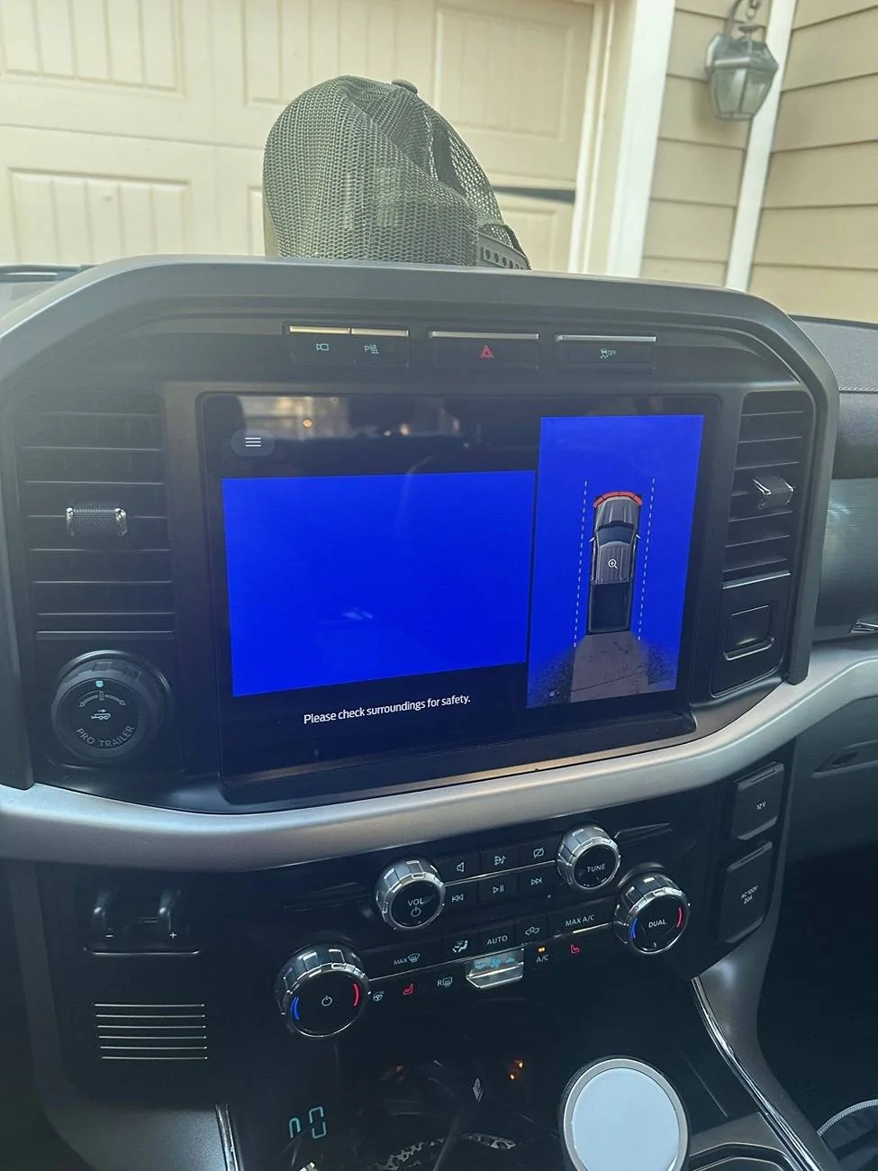

just finished my install up with the boostedbygreygoose harness. Everything was easy but now my 360 camera is just a blue screen, the backup camera is the only one showing. Anyone else run into this?
I believe someone on this thread faced the same issue and had to replace the cameras from the original mirrors. That's what I did with mine and didn't face any issues.
OK, just replaced the camera plate with camera and led light on the driver side only, fixed for all cameras now. so strange. I attached what it used to look like, but changing just the driver camera seemed to resolve it.

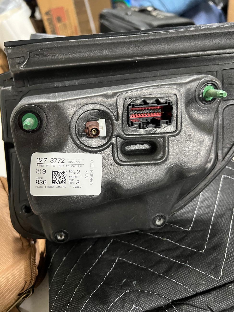

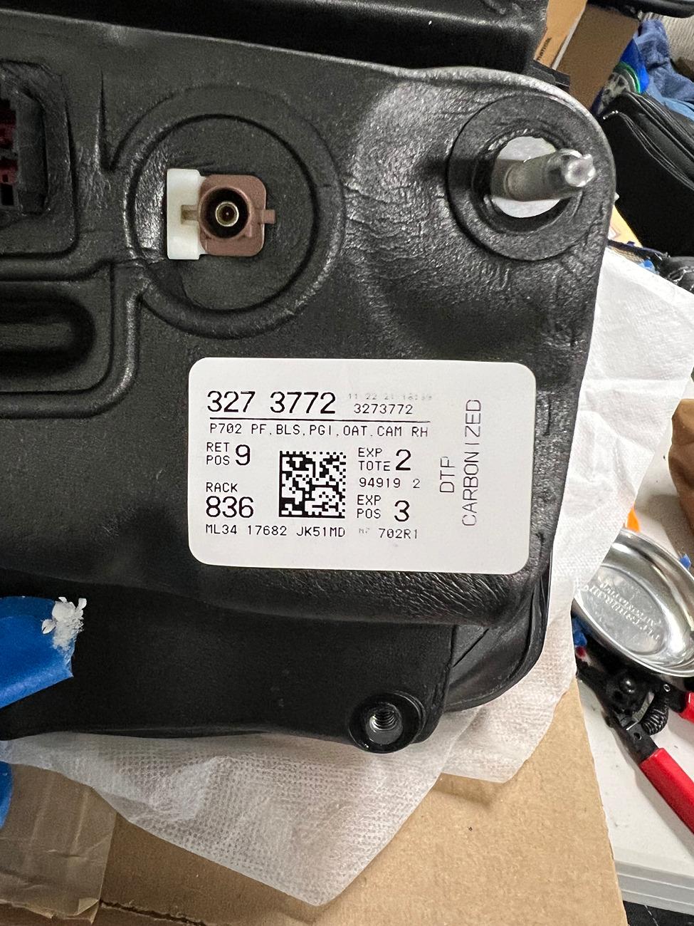

So I saw this thread and also a similar one in the F150Gen14 forum and started looking for some power fold mirrors on ebay, etc. I happened to find a guy selling take offs from an ICE F150 Lariat which were the same color as my truck (Carbonized Grey). Bought those, the boosted grey goose harness and a new door switch (ML3Z-14529-CC). The mirror and harness install are very straight forward. Everything is working, 360 cams, BLIS, puddles, etc. Here are the part numbers of the mirrors. The drivers side is also dimming but I chose not to wire that up as I have heard some people don't like it and I really don't need it.
