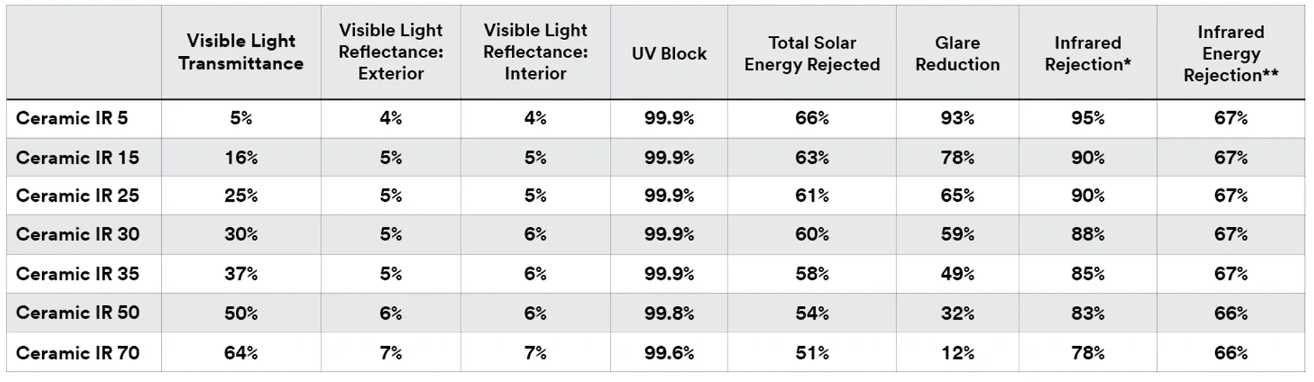

I think something to keep in mind is not just first-passthrough IR rejection but an overall figure commonly referred to as Total Solar Energy Rejection (TSER). Although marketing materials may show, Wow!, 5% tint rejects 95% of IR, it never ends up being that good. The rejected IR, rather than being reflected back into space, likely ends up heating up the window tint film. The film gets hot and reradiates much of the absorbed IR into the cabin. Visible light can also be absorbed and heat the tint film or pass through and heat materials it strikes inside your vehicle. See the 3M Ceramic table below, where the last column represents the total effective IR rejection and the next to last, essentially initial IR rejection. Total Solar Energy Rejected is shown in a middle column:
Ford F-150 Lightning Any advise for tinting - especially the moonroof? 1722924365150-5l
Source: https://www.3m.com/3M/en_US/p/d/b5005118130/ (see page for heading definitions, too).

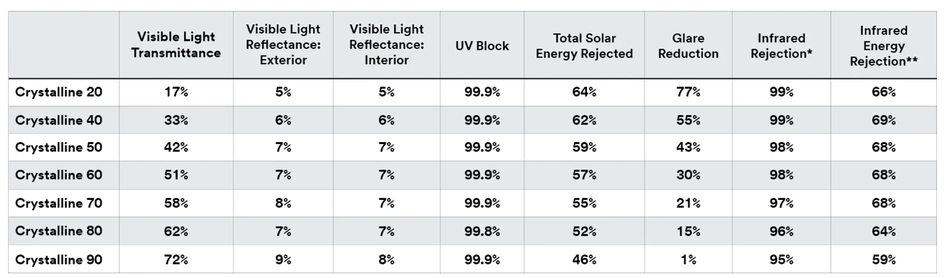

3M Crystalline properties by comparison (2x as expensive as ceramic - almost no 3M dealer in San Antonio sells it):
Ford F-150 Lightning Any advise for tinting - especially the moonroof? 1722924991139-wq
Source: https://www.3m.com/3M/en_US/p/d/b00016683/
I wanted to be ~legal in Texas (law says no tinting of windshield) so I went with 3M crystalline, which is available in 90% VLT. I used that on the windshield and 70% VLT on the moonroof. Had 50% 3M crystalline put on the front side windows and 25% 90% VLT 3M crystalline (available at the time) on the rear side and rear windows.*** I figured the rear windows and moonroof were already heavily tinted in the visible spectrum and didn't need much more tint in the visible. For side window use, I didn't want to reduce front side window visibility too much, nor max out the visibility reduction on the rear windows, either. I was willing to sacrifice a little bit more heating for better visibility in dim, dusk light situations, etc. I'm pretty happy with the results. A lot of heat still gets radiated through the moonroof shade. Ford did a crummy job of insulating that. My 2007 Honda had a moonroof that wasn't tinted with a window film, and nowhere near as much heat came through that with its shade closed.
