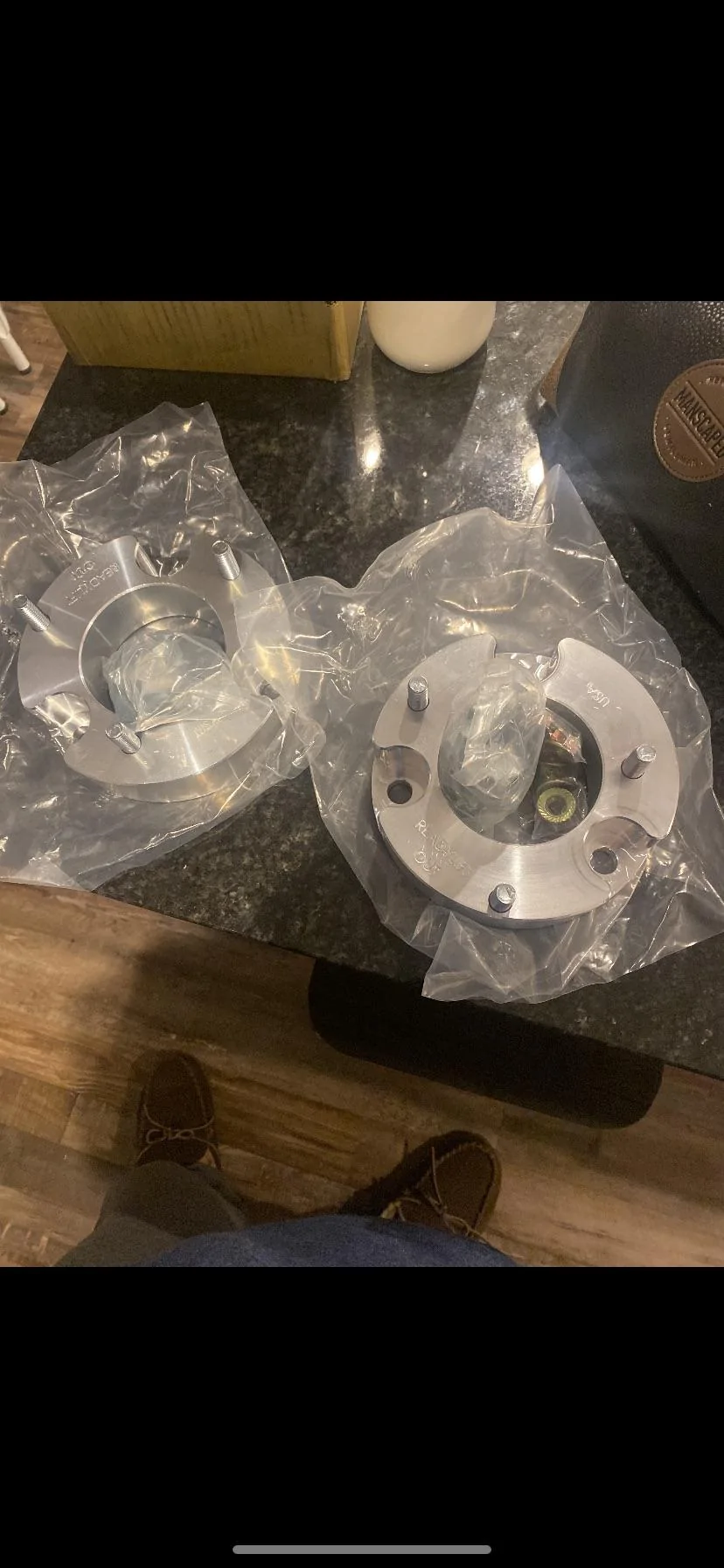

I ordered both kits and will post side by side to
Include hardware. Hopefully that will help you guys. Also, I ordered BDS 4” lift, so my uninstalled ready lift 2” level kit (2021) will most likely be for sale.

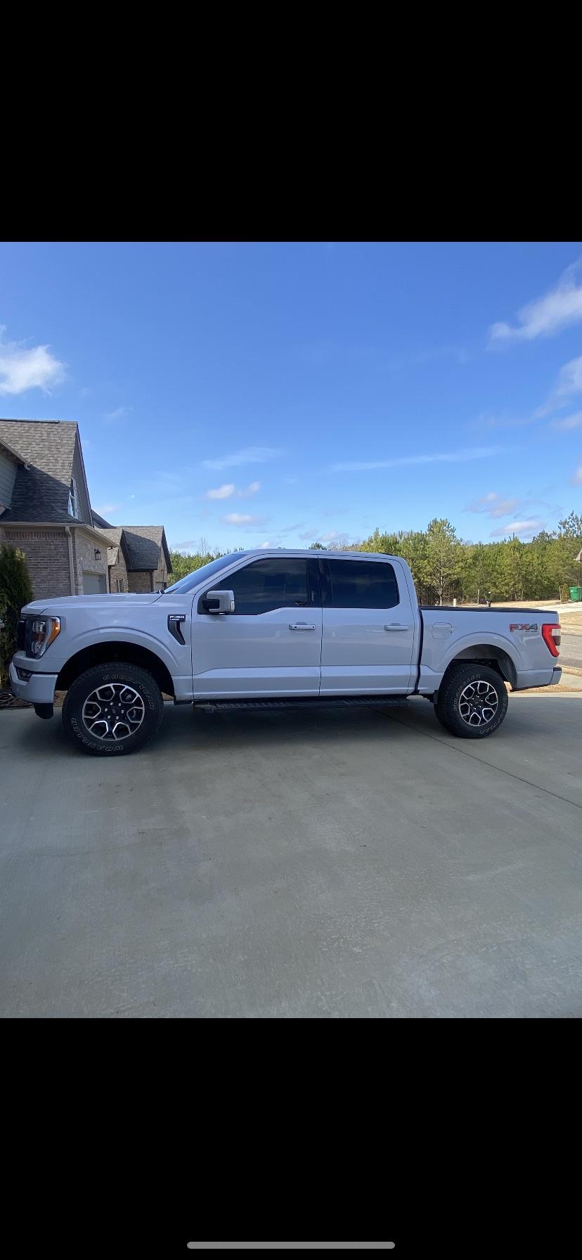

Hey All,
A few days ago I had a local shop install the Ready Lift 2.0inch level kit on my 2021 F150 PB Lariat 4WD 502a. I paired it with a set of Nitto Ridge Grapplers 35X11.5XR20 on stock wheels. So far I have been very happy. No rubbing and minimal change to how it drives. Too early to tell what effect it will have on MPG, but i'm sure it will have a negative impact based on how heavy these tires are. I have noticed a vibration/shutter under me when I try to accelerate at higher speeds (50mph+), but I noticed this prior to the level and its seem to have gotten worse. Any ideas what this is? Also, happy to try and answer any questions on the level/tire setup.

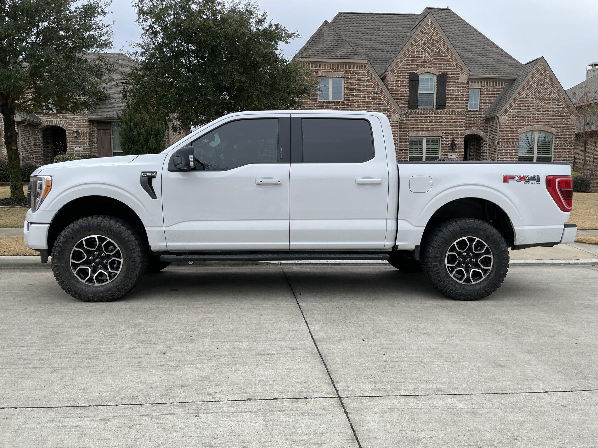

Hey All,
I have a similar set up as you, as far as powerboost with2' level, I went with aftermarket wheels and the Ridge Grapplers in 295/60/20. There are many members experiencing the shutter you speak of. I too had the issue before the lift and wheels. I also have an issue with skipping second gear. I have been waiting over a month to get into my local dealer. You can search for the shutter in the search option. There's plenty of info for you to sift through. I can also tell you I lost 3-4 mpg's with my setup. My speedometer is only 1 MPH off.
