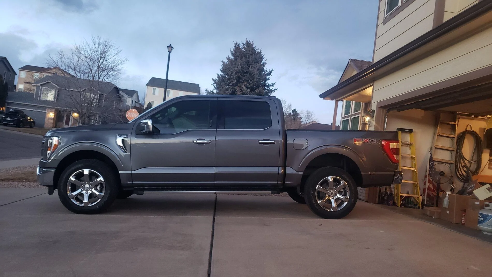

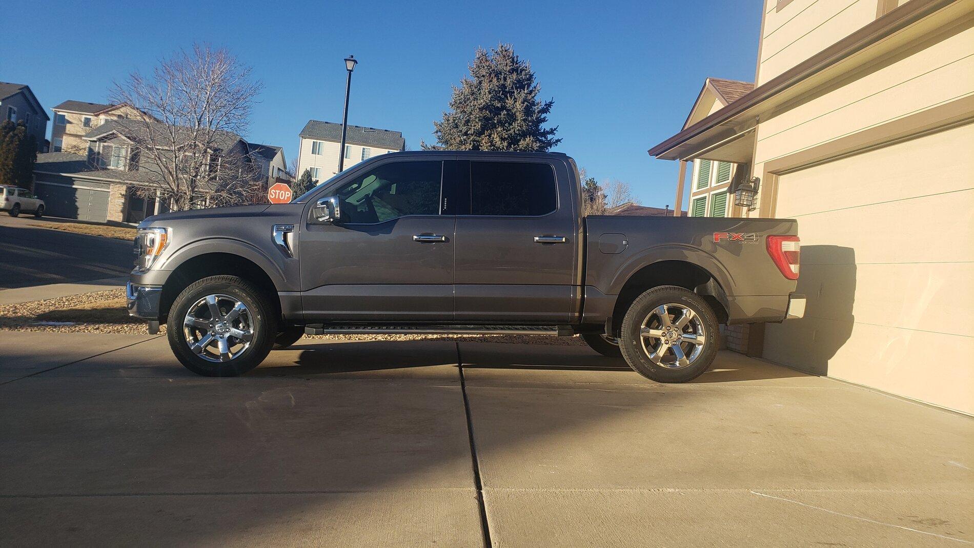

I had my 2 inch (new kit) installed yesterday. The tech said the cam bolts/plates make the alignment very easy and that the kit was awesome. It rides great too !
do you have any hub center to fender well measurements?
FX4 or Sport?
