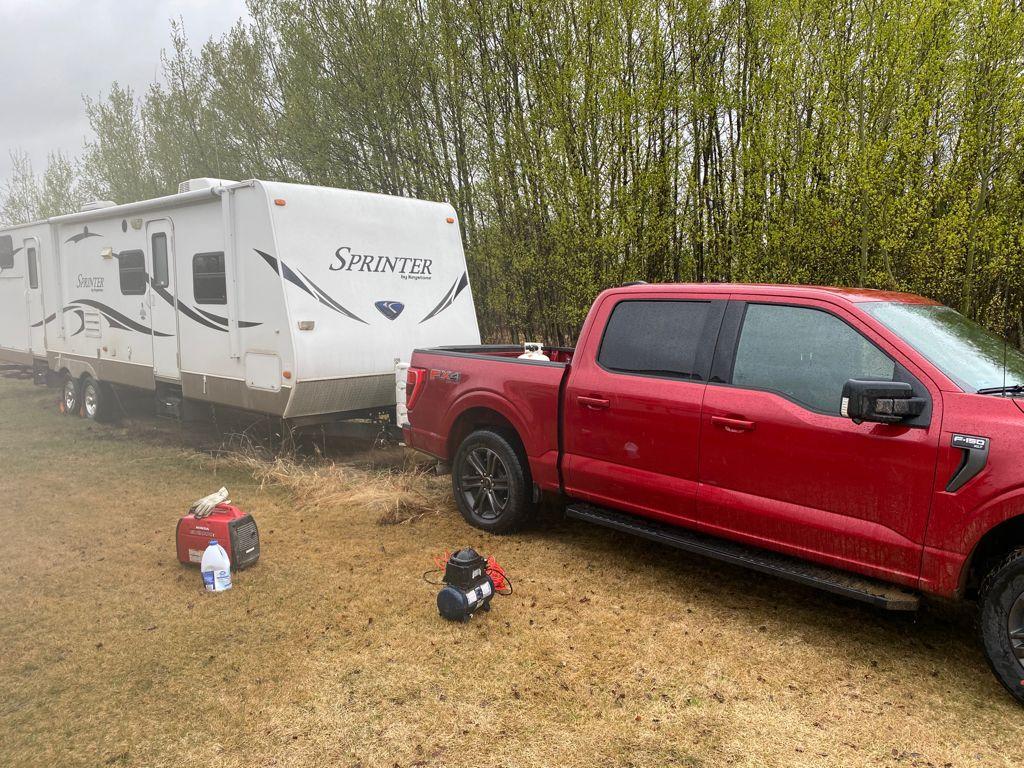

I have them and hitched to my TT today, 8200lbs dry, and they still had a
Ford F-150 Lightning Anyone use Timbren suspension? IMG-20210508-WA0000
bout 1/2" before they touched the axel.
