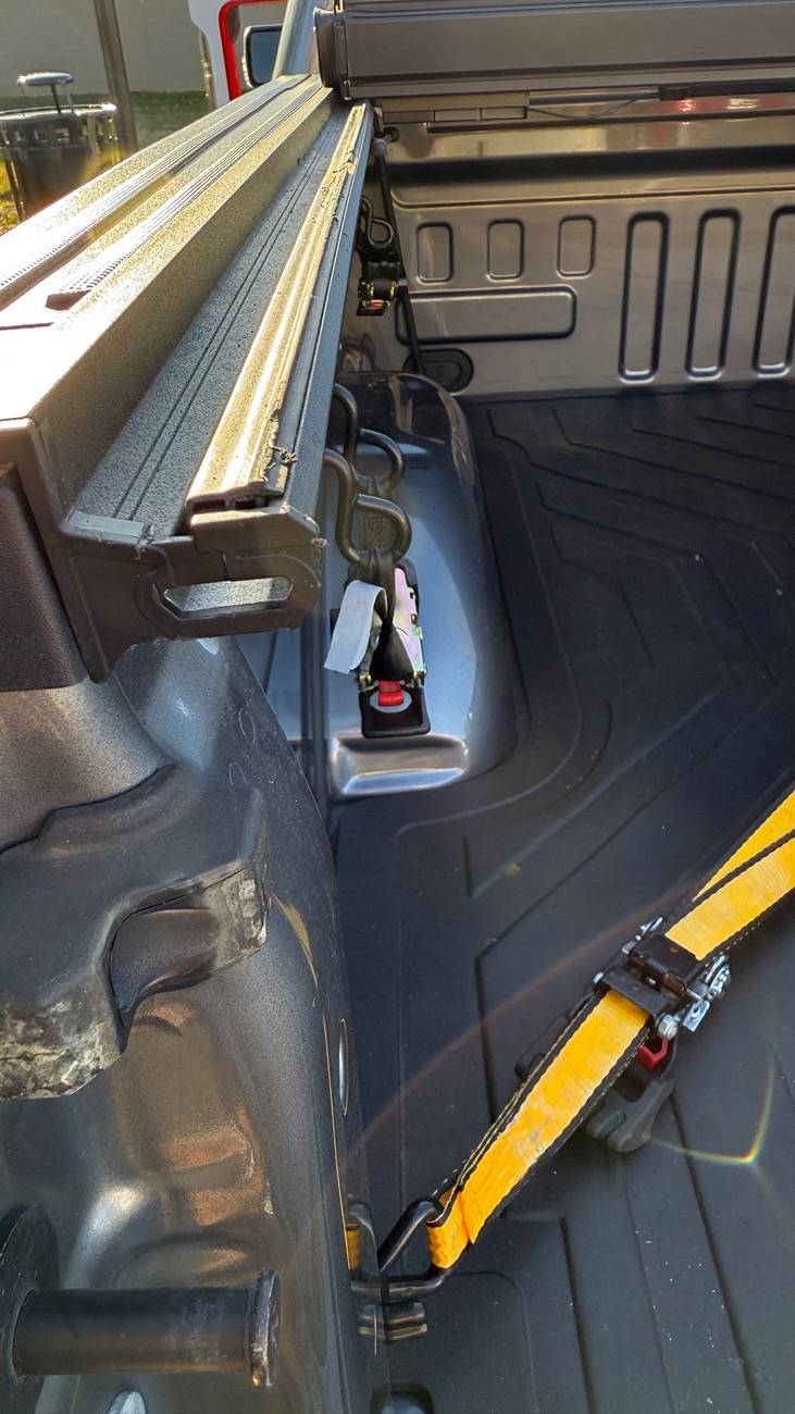

I need help figuring out how to remove the old weather seal from the bakflip mx4 as they have sent me a replacement. If anyone has done this, any tips will be helpful

There's a 3M adhesive remover that you can use. You can find it at local auto shops and hardware shops.

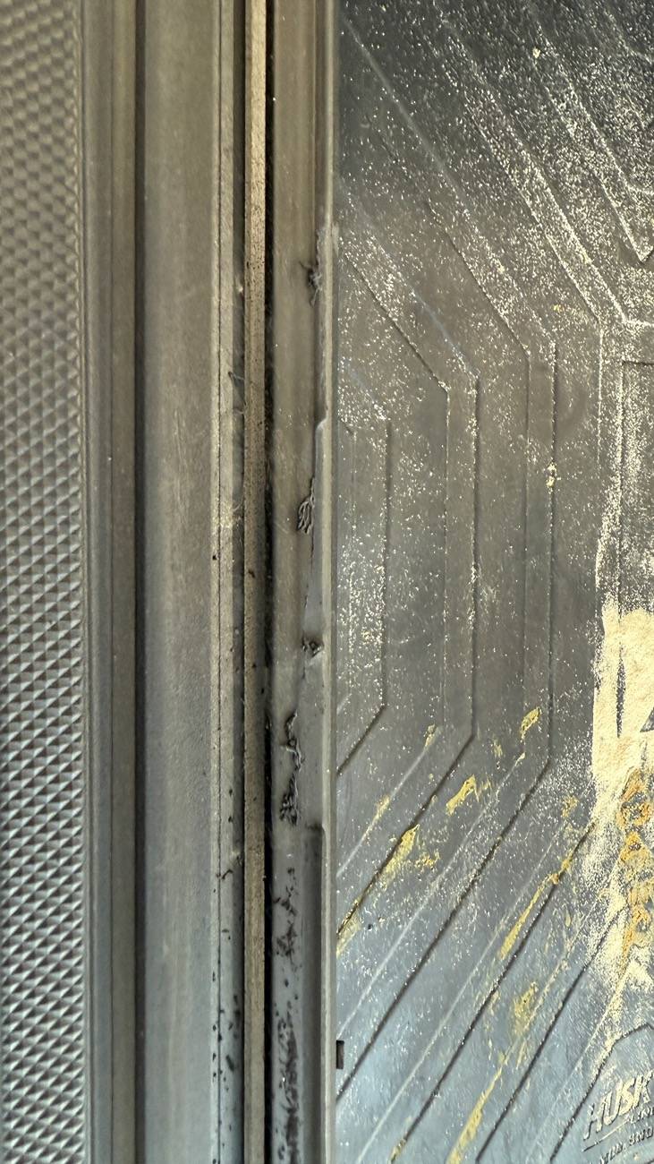

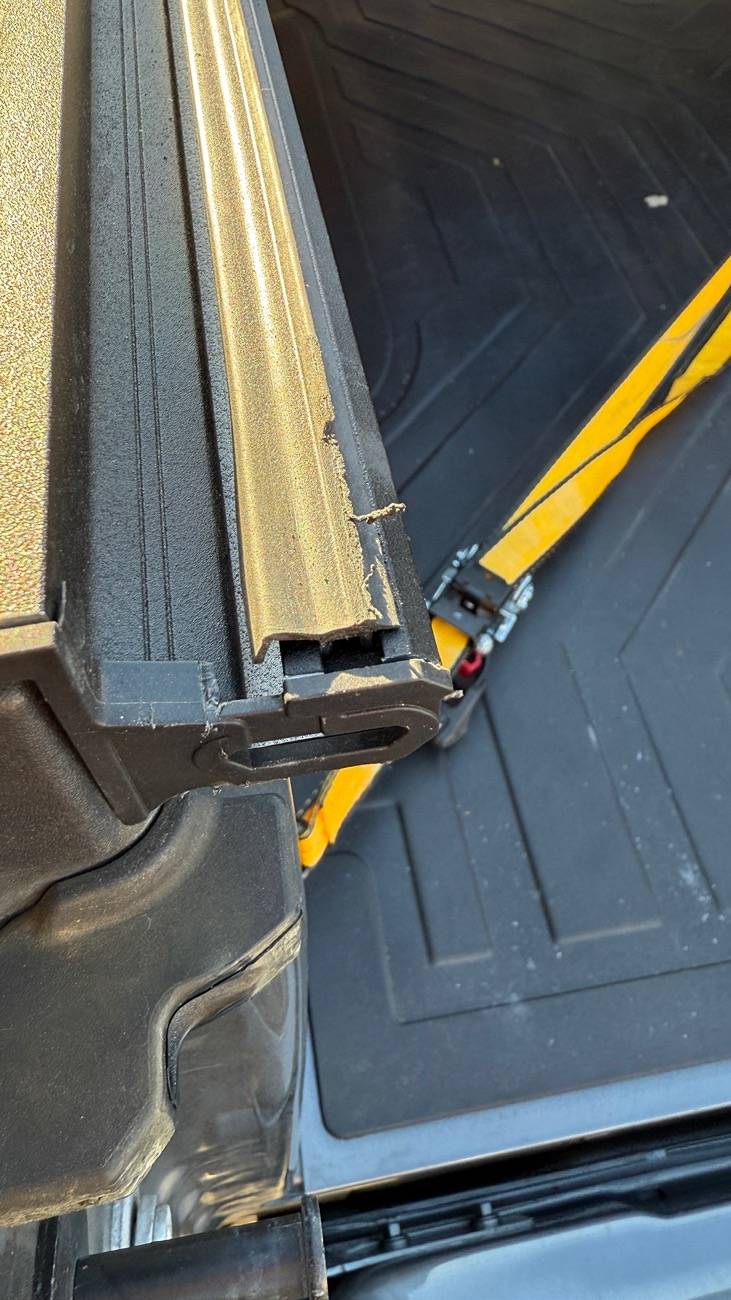

this is the whole strip I need to remove sorry here is a better picture.

Gotcha. You can pull it up from a corner and strip it off from the rail by hand. A plastic scraper can help to get it up if it's stuck. You can even try getting under the seal with a thin fishing line and "saw" it free from the rail. If it's really stuck, a 3M adhesive remover around the edges will loosen it up and make it easier to pull off.
