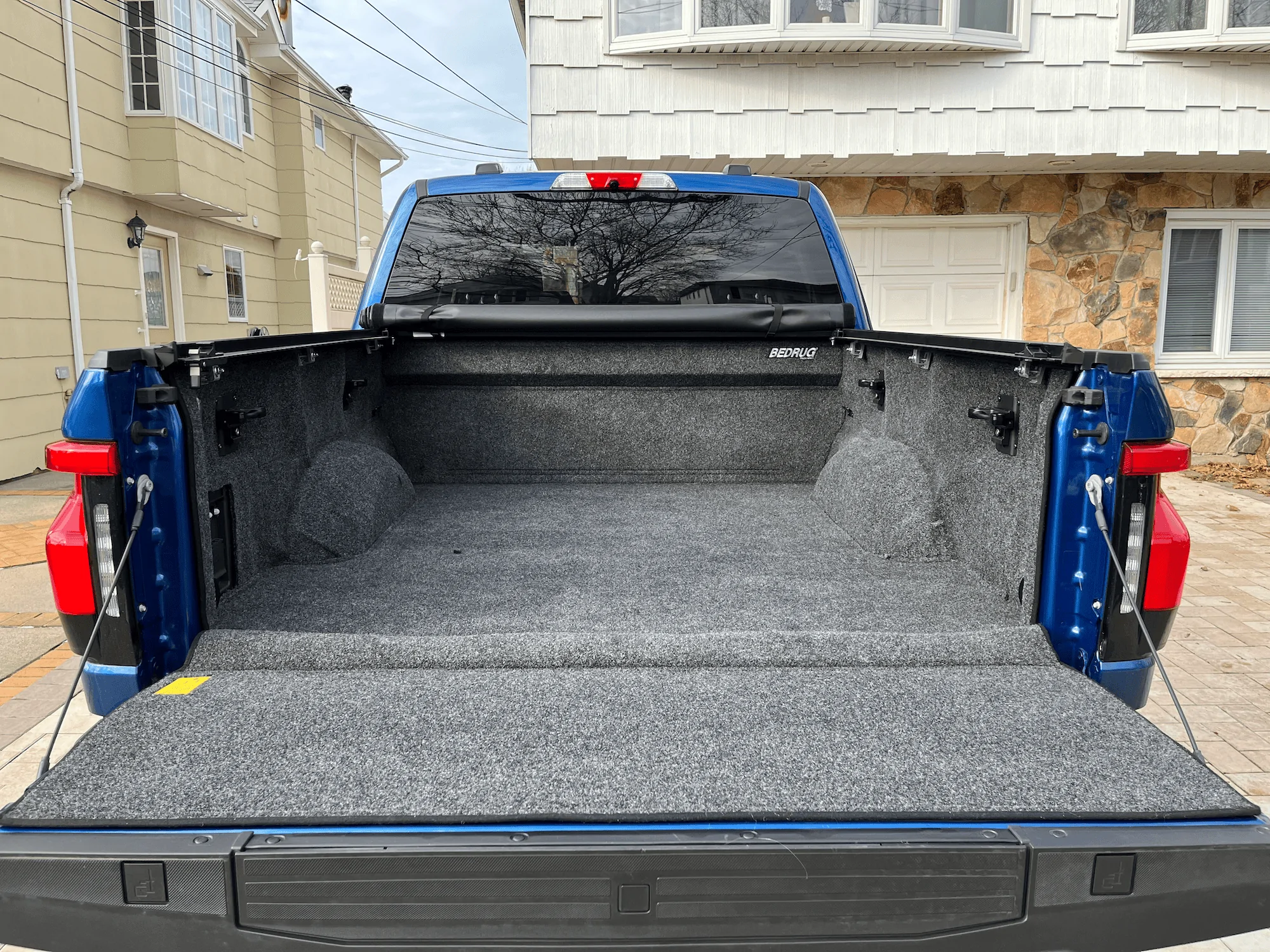

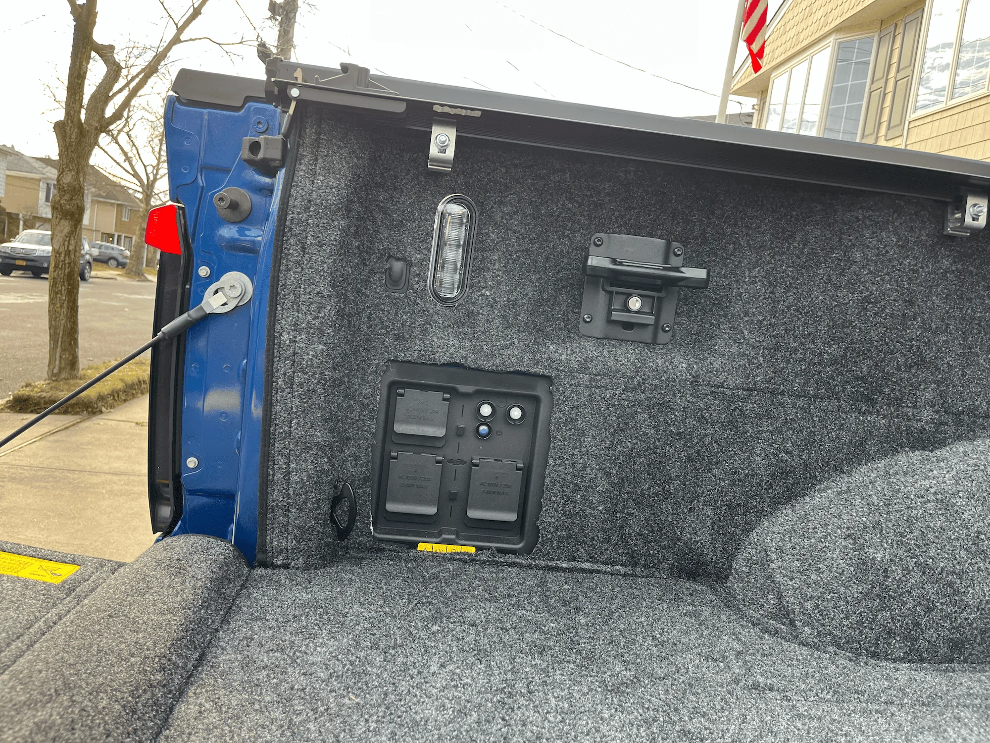

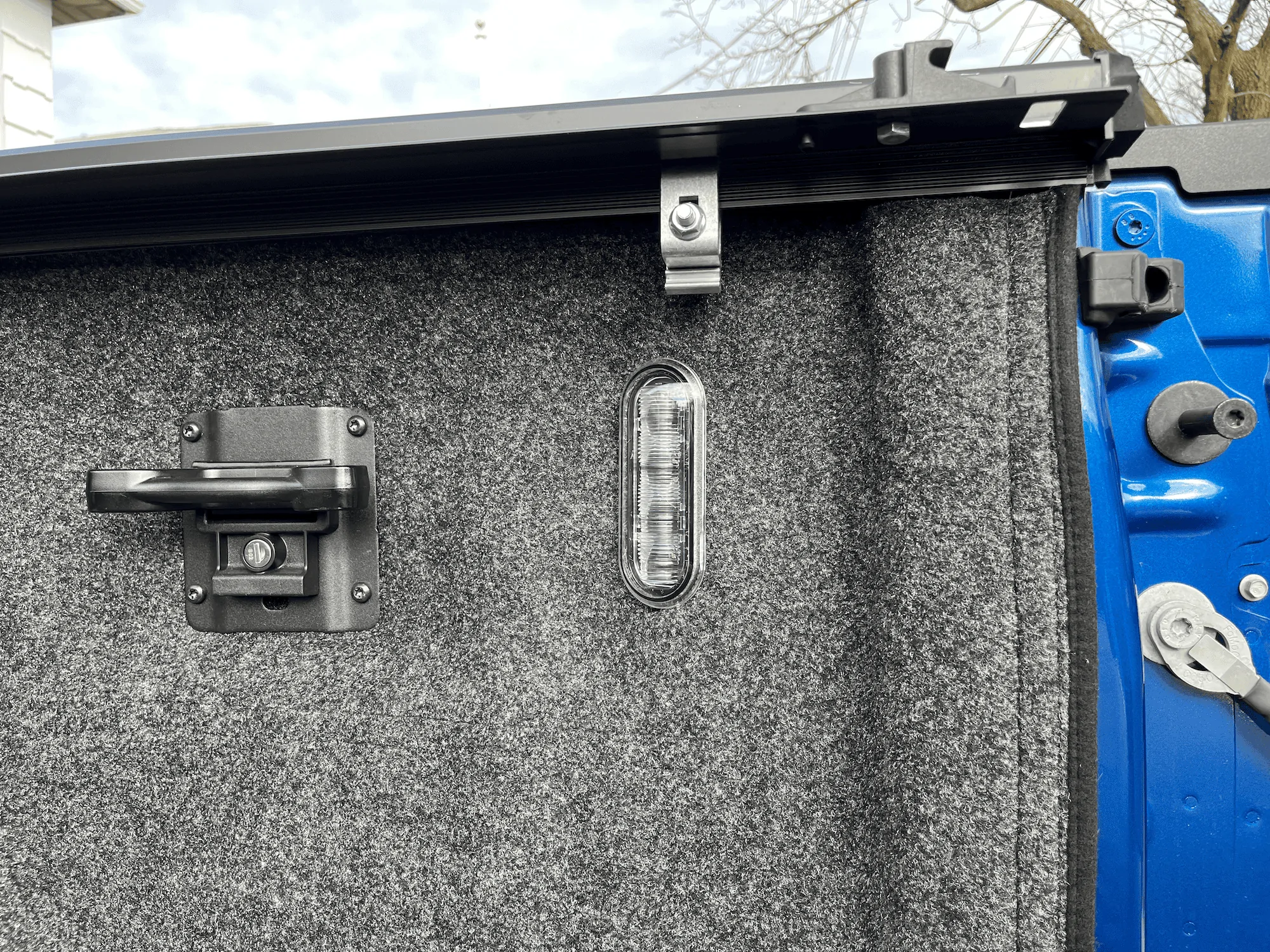

Now that it's light out, here's a better look at the final install.
I'll eventually tweak the cuts around the ProPower and light switch, then add some Velcro around the lights just in case, but otherwise, it came out great. I obsessed over the cuts in my last F-150 to get things to snap back and that's just not needed.

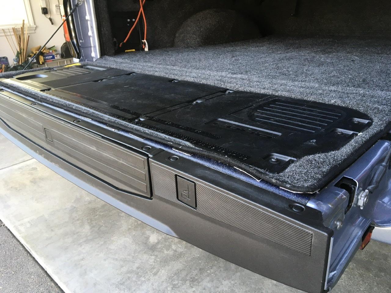

Yeah, I had it perfectly placed, was putting the work surface back, and then realized there are positioning tabs molded into the work surface that fit into holes in the tailgate that I didn’t see (long day…got a little rushed at the end). I didn’t punch holes in the surface of the BedRug to accommodate them and it left me two buldges🙃 as I reintalled the Torx screws.
It forced me to pull the surface back off to punch the holes for the tabs, and thus reposition the rug. I already had the top row of Velcro set on the tailgate and reinstalling the work surface “tugged” on them….and is now pulling on them (See photo). I need to get some more Velcro and reinstall that top row to clean it up.
Other than that, I’m happy with my outcome…….

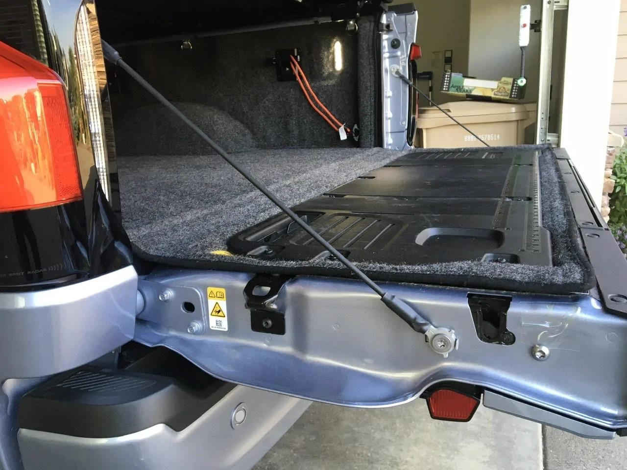

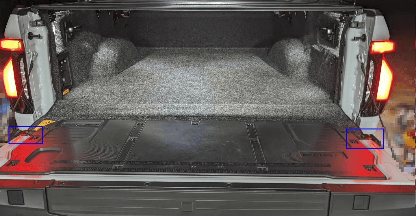

Well after doing the install - I understand all these comments now.
Initially I was going to do the whole tailgate.
I cut spots for the screws and "humps" so the work cover would sit flat, but I wasn't happy with how it looked and how the corners curled.
Ended up just cutting the outside at the hook points @Firestop recommended and I'm happy with how it looks.
Can provide more photos if someone wants, but here is what it ended up looking like last night.
Blue boxes to show the cut
Ford F-150 Lightning Bedrug concerns 1709662590784
After seeing what it looked like without the cut I realized it would get in the way more than it would be nice.
Going this route also didn't require any velco since I was using the side mounting points as clamps - and the work surface to hold it in place.
Now I don't have to worry about velcro, or corners coming up or getting caught on items and I still have the tailgate gap covered.
Very pleased.
Thanks for the help and installation tips

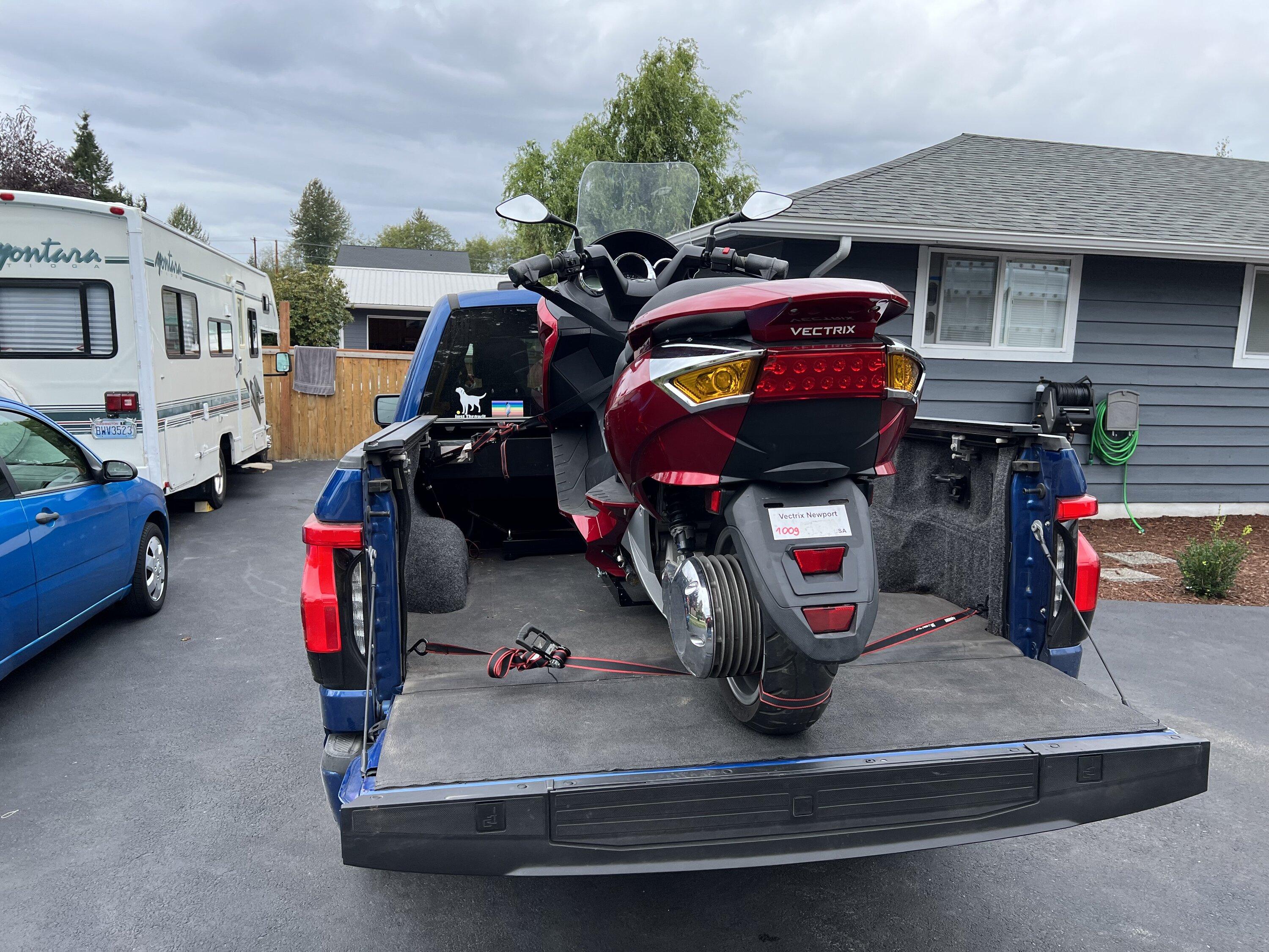

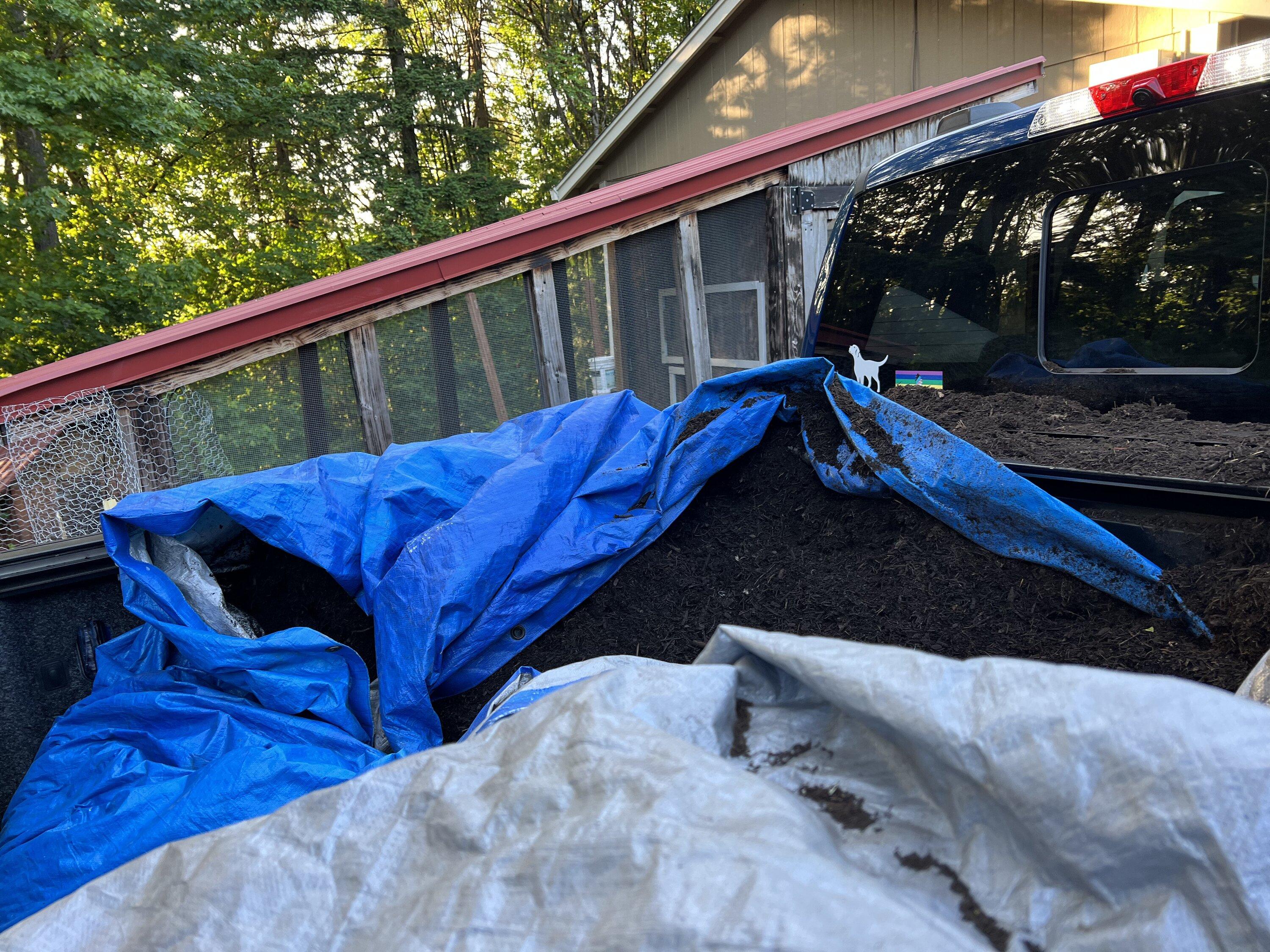

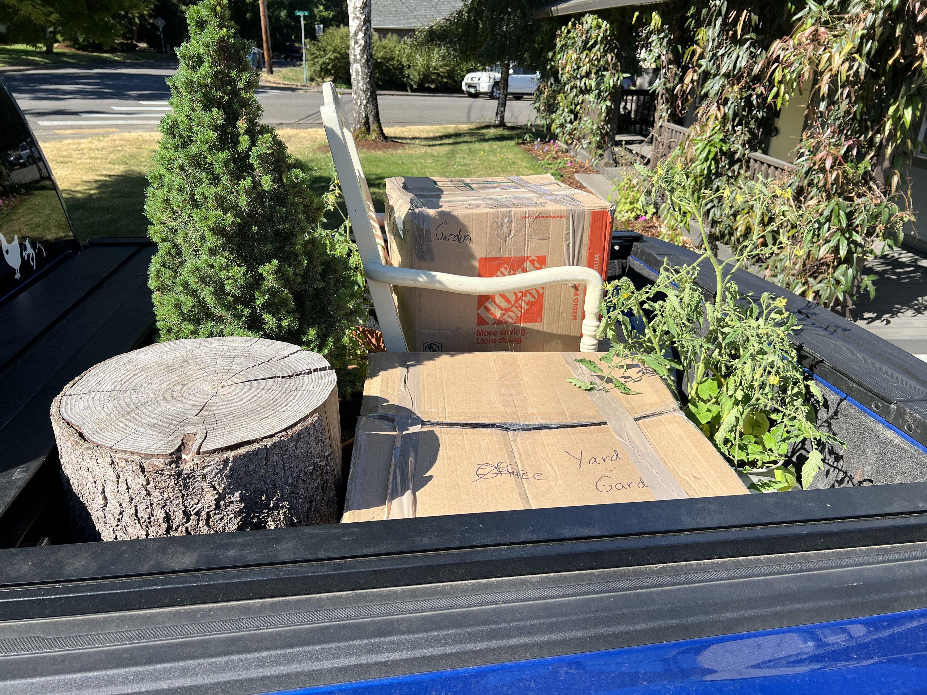

Obviously no longer have Adira (RIP) but here's just a selection of photos of me using the bedbug in my truck to full extent.
Never had any issues.
We've hauled wood, dirt/soil, motorcycles, camera gear, and I would 100% recommend them.
We have the slightly tougher one with the rubber mat on the bottom. It just rinses out :)
In fact, we're hoping insurance will help us cover that... ;)
