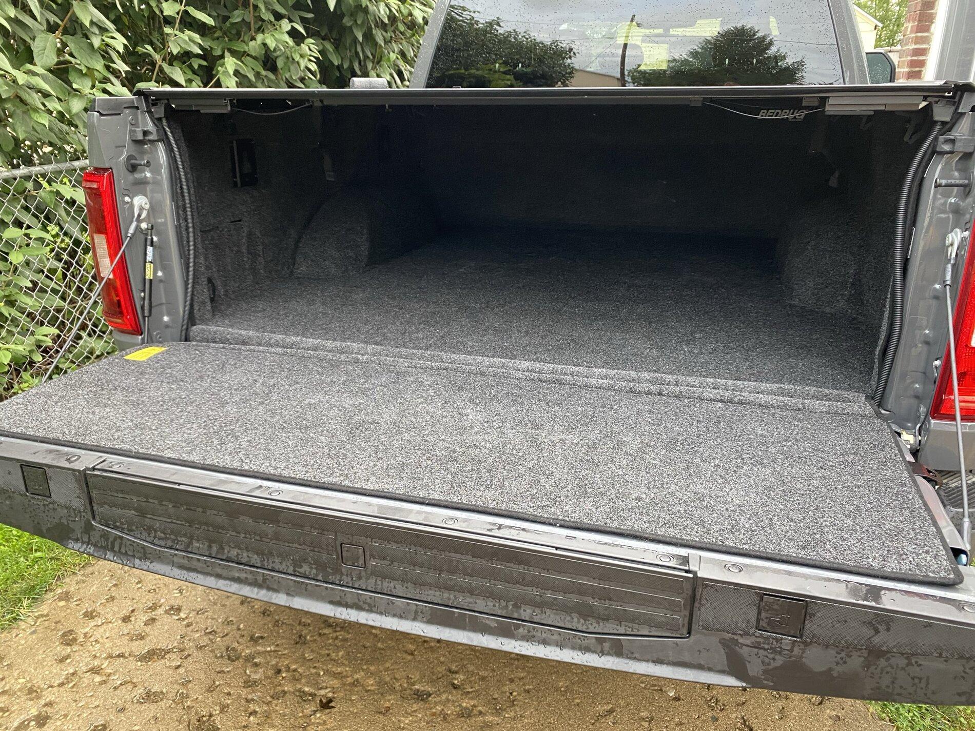

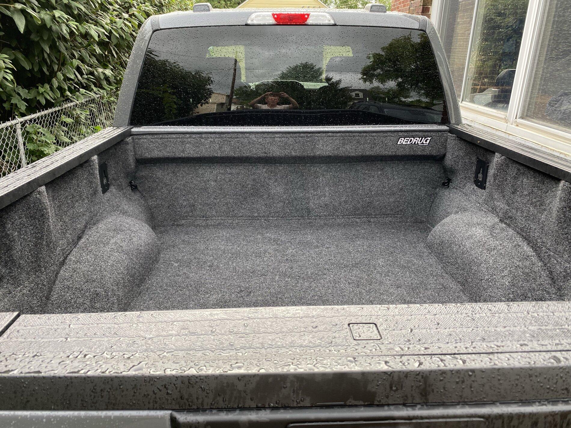

You'll want to get the filler between bed and tailgate to fold up not down. That way you won't create a bind because it's wadded up when the tailgate is closed.I just finished installing the Bed Rug in my '21 5.5' bed F150. The installation was fairly simple, and took a little over an hour. There is a LOT of velcro holding this thing in place.

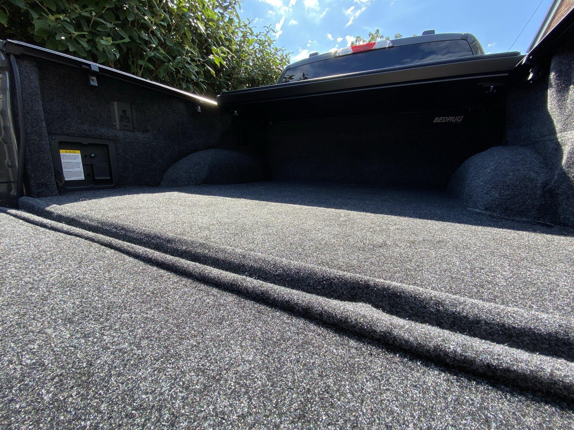

Looks good.Installed mine a month or so ago. Longest time is just making all the cuts and trimming some backing to get thr switch and lights to click back in.![]()
They are already marked on back by manufacturer. Just have to cut them out where needed. Looks like he did a nice job and laid them under the bezels.L

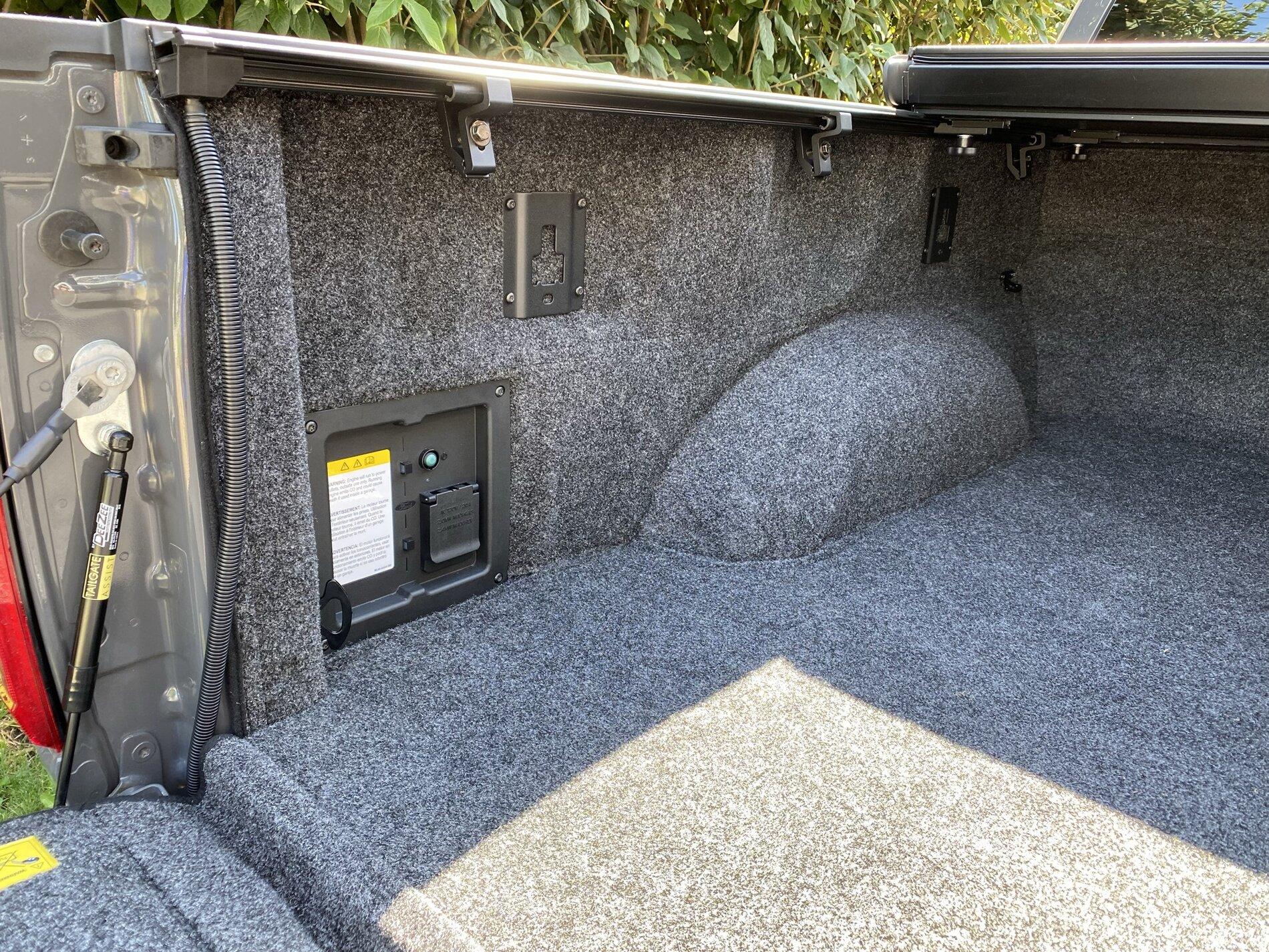

this lights and switch have the locking tab on the bottom, just insert a panel tool or screwdriver.. for the pro power I removed the 4 bolts and then took the panel apart and disconnected the wiring connectors. Then cut the rug and reassembled. The pro panel has two guide pins on each side of the box that you will need to cut the carpet for.What is the best way to remove the LED lights, switch, and Pro Power panel without breaking anything? I'd like to install a bedrug just like bdubbs1198 did his. Would greatly appreciate instructions.
The key is removing the tail lights so you can access the retainer clips and plugs. There's a great how-to here:What is the best way to remove the LED lights, switch, and Pro Power panel without breaking anything? I'd like to install a bedrug just like bdubbs1198 did his. Would greatly appreciate instructions.
