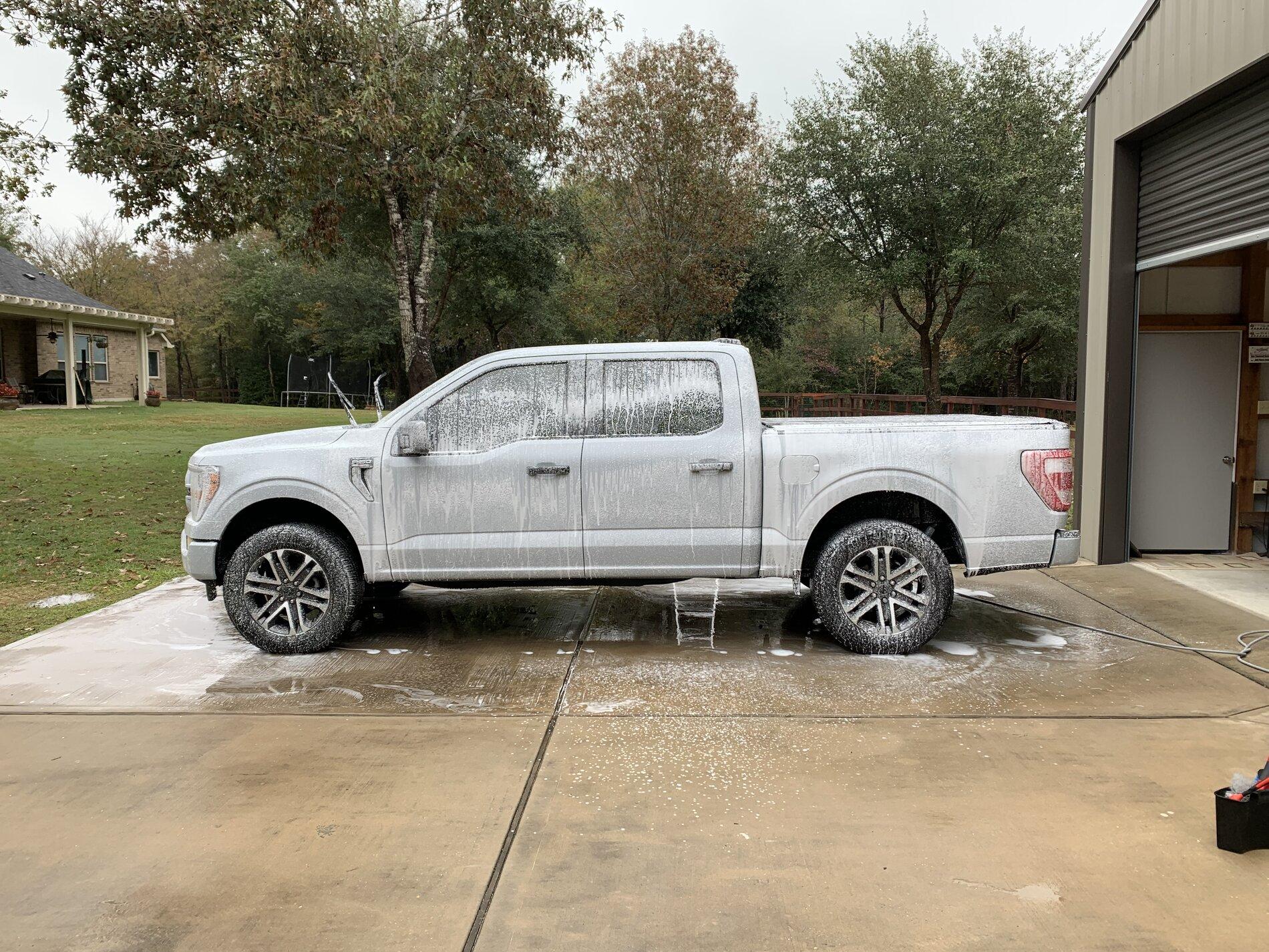

Installed a week ago and just got a bath today! I’m blown away by the ride improvements, less body roll, more road feel, feels stiffer and stronger in all driving situations. Haven’t been off-road yet, but loving the leveled look. Thanks for all the good reviews making me pull the trigger on the Bilstien kit!
Looks awesome, glad you like them!

I have a 2wd truck, so I have the 4wd struts and shocks giving me about 3in in the front and 1in in the rear. The front struts are at zero. Tizzio has a 4wd at max height and got about 2.5in in the front.
