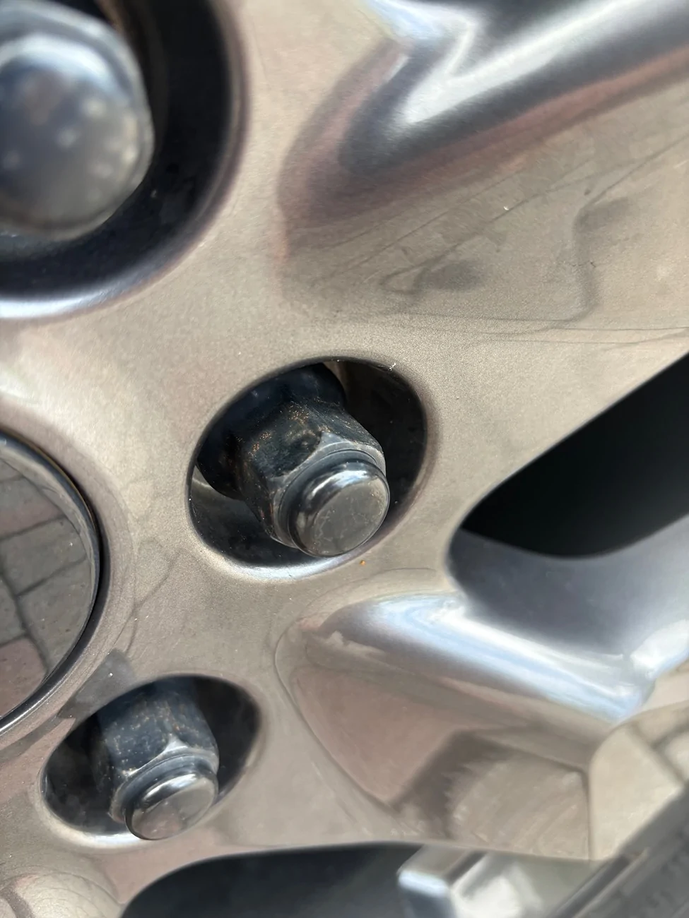

Here’s how the Gorillas have held up after a bit more than two years. Still looks fine walking up to the truck. If you look closer at them they are developing small spots of corrosion.
Granted, I’m in the south without salt on the roads…For now I’ll be keeping them and only swap them if they get noticeably worse cosmetically.
