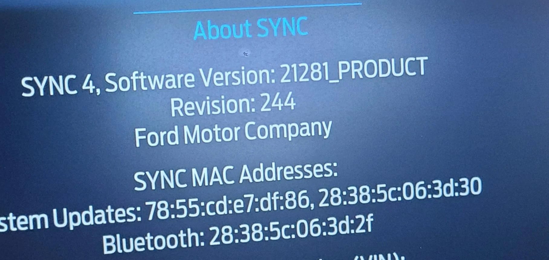

Just got back from the dealer. Supposedly my job1 truck got the 21G01 update. Can't seem to get BC working though. Sync did update.

Thats not the latest....

Yes not the latest. Should be 22028. Look in Ford Pass account upper right corner. Then scroll down to message center. Will show latest update you are at.

22034 is the latest APIM for BC. @azDcab21 if You send me your Vin and I can tell you how bad they messed your truck up. Ford is going to have a mess on their hands with dealers attempting this. So the fiasco begins. Going to be a lot of unhappy people
