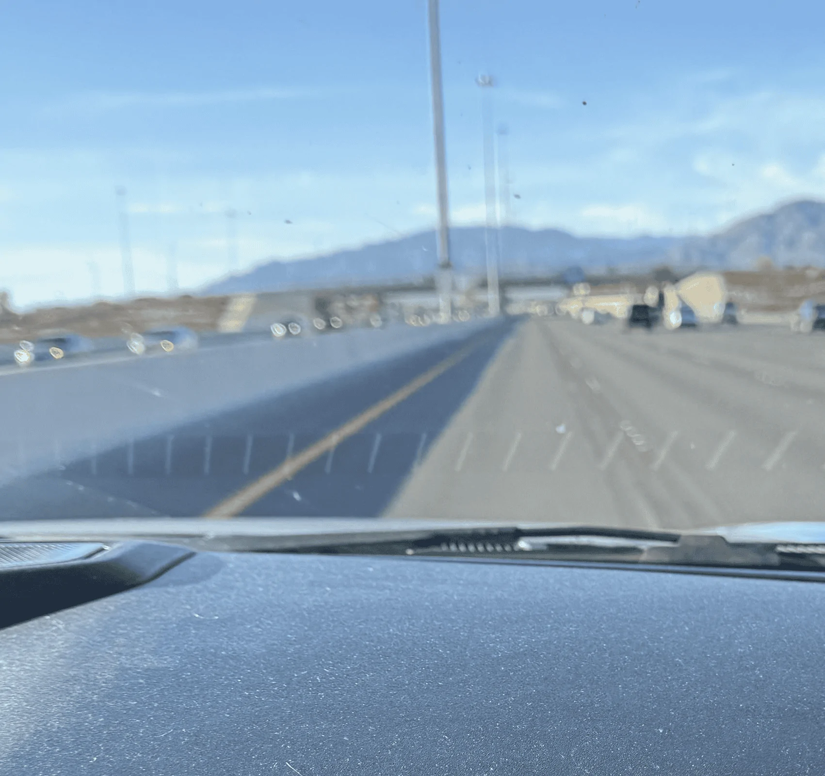

Ok... BC didn't "really try to kill me, but it would have been bad if I wasn't paying attention. And yes... I know you are ALWAYS supposed to be paying attention... and I do.
Anyway...
Driving home today, I was headed north out of Vegas on the 95 in the carpool lane. The sun was on my left and cast a pretty dark shadow on the road with the shadow ending in the middle of my lane. BC was happy for 5-6 miles and then just starts heading left towards the barrier. It wasn't a super sharp turn to the left, but it was deliberate and not just a "drift out of the lane situation". I noticed it was happening and had my hands on the wheel, but I let it go a bit because I wanted to see if it corrected itself. It did not and I took over when about half into the shoulder.
BC is awesome most of the time. Not awesome enough for $800/year, but I still have another year on my free trial. Maybe Ford will lower their prices by then.
Apologies on the quality of the picture.
