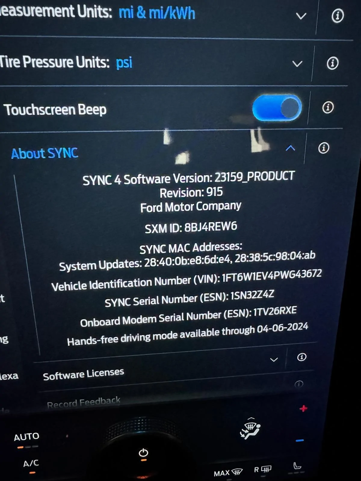

Well, I have an update to report. I think I know why my blue Cruise quit after my 6.1 update last night.
Under Sync general about my hands-free maps show they expired April 6, 2024.
But my connected services show that I am good for three years until 2027.
Is this just some kind of glitch and I will need to wait for an update to download to fix that?
On trucks with later updates the date is hidden, I'm up to 6.8.0 + various Priority updates
Could you share a snapshot of the screen you're looking at?
Here’s a picture. As far as I know this changed with the 6.1.0 update that installed yesterday but I realize I really have no way of verifying that. It just seems like an awful big coincidence.
Technically, it could have happened at another time though.
The connected Services shows I am good until March 2027

4th day of June 2024 (FORD DATE FORMAT}) if I recall correctly.
There is an update floating out in the ether which pushes it much further out into the future and also makes it invisible to the driver.
Hmm.. okay. Well thanks for that. I guess that means there is some other reason blue cruise didn’t activate today. We’ll see what happens tomorrow

As I read this thread, I bet what happened is that somewhere in the software stack, 06/04/2024 was interpreted as 04/06/2024 and triggered the warning. Darn date formats!
I'll say, Mine says "Hands-free driving mode available through 03-09-2074". Lol
only have had Lightning since last Thursday, I'm on the 23159 revision 915.
