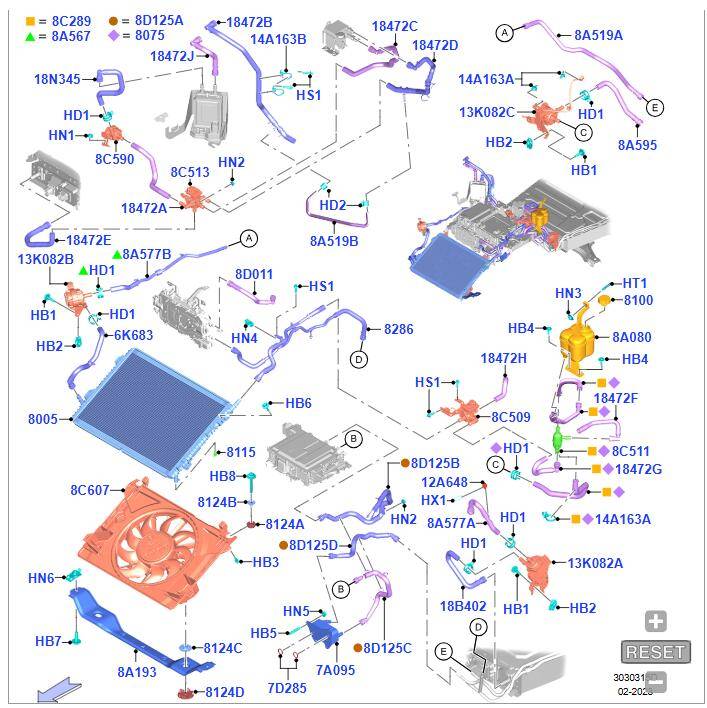

Try charging your 12volt battery. Seems to fix a lot of random stuff on the truck.

For me, the dealer just replaced an oil pump and a heater unit, but it apparently did not do the trick. I’ll forward this to them though, thanks!

Ford eventually made it right, but it took over a month for them to replace half the heating system. Turned out to be a bad pump from the factory, so QC failed hard.

I had this issue. The dealer did not believe me initially (but then again, I knew more about the ‘24 heating system than they did). I insisted the keep searching. Eventually they replaced the blower motor and all is well now. I have a thread about the experience on this forum.
