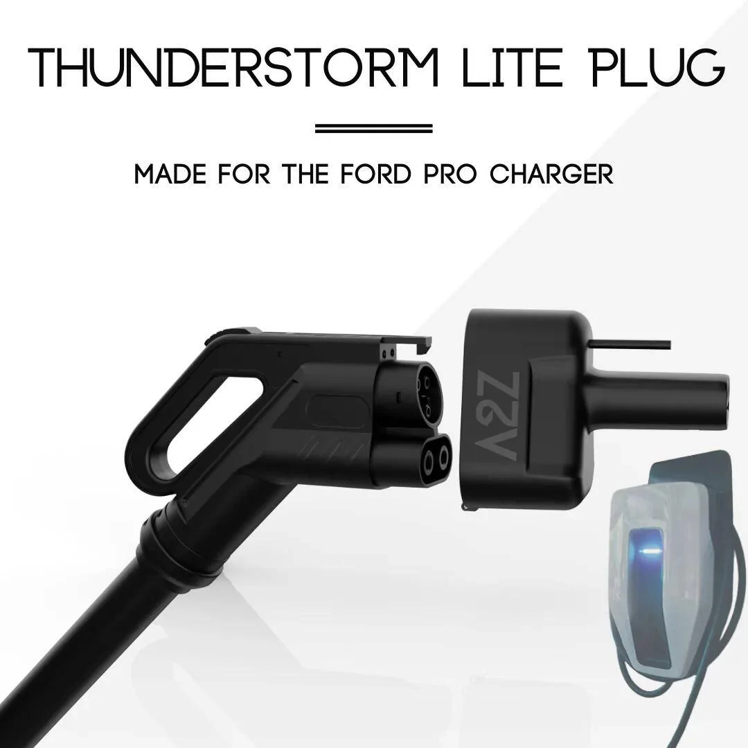

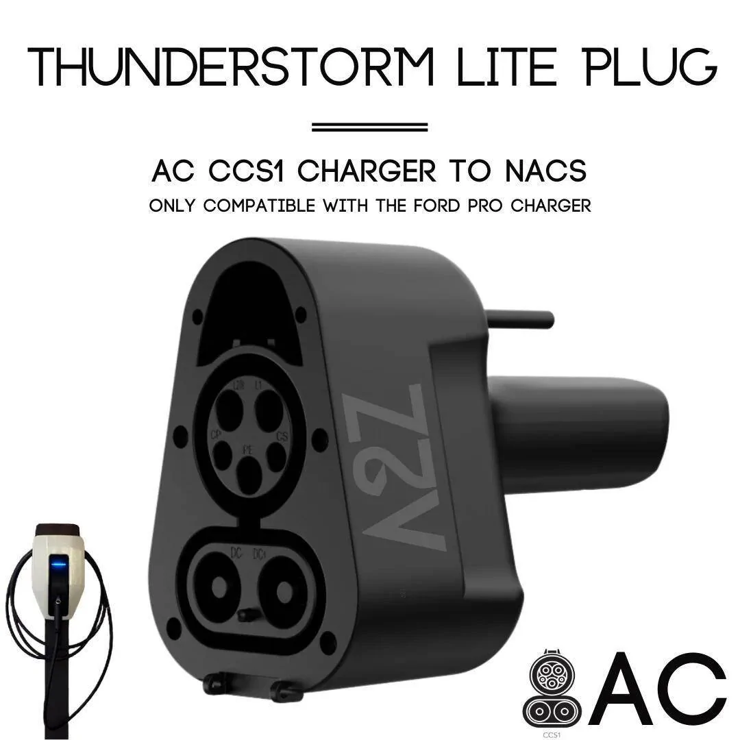

A2Z EV has a adapter for owners with a Ford Charge Station Pro and a Tesla.

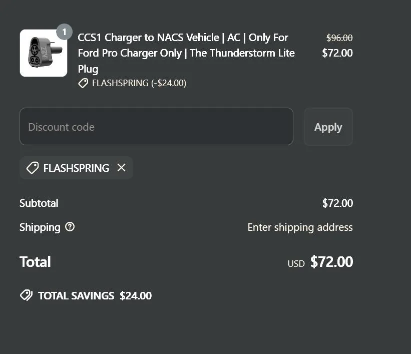

You can click the below link and then use the code "FLASHSPRING" to save 25% off instead of 5% off.
CCS1 Charger to NACS Vehicle | AC | Only For Ford Pro Charger Only | The Thunderstorm Lite Plug - Click here and use discount code "FLASHSPRING"
Description
Important notice : This adapter is specifically compatible with the Ford Pro and GM PowerShift Charger and will only serve with the AC function.
Key Features :
  • Power : AC/Level 1/2 charging
  • Safety and Security: Our adapter locks the CCS latch once fully connected, ensuring no unplanned disconnections or thefts. Includes an interlock safety pin preventing accidental removal of the charging connector while charging. Unplug it with authorization from your car, phone, or charging station's control panel.
  • Protection : IP54 (mating) & IP67 (enclosing). Includes a hard case.
Requirements :
  • For the North American market.
  • AC Ford Pro & GM PowerShift Charger only
  • Tesla model S, 3, X & Y and NACS port equipped vehicles.
Built for Safety: For added safety, the A2Z Thunderstorm Max Plug incorporates two temperature sensor switches. The first sensor derates the charging process upon reaching a certain temperature, while the second sensor halts charging, the temperature are strategically placed within the adapter. Charging can resume once the temperature normalizes and the adapter is reconnected.
Easy to Use: Plug the A2Z Thunderstorm Max Plug into the charging station, then into your vehicle. To unplug, simply authorize from your vehicle or phone
