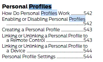

Do you have a second key fob that has not been configured to the truck?
Use that for your wife's operation and profile creation.
