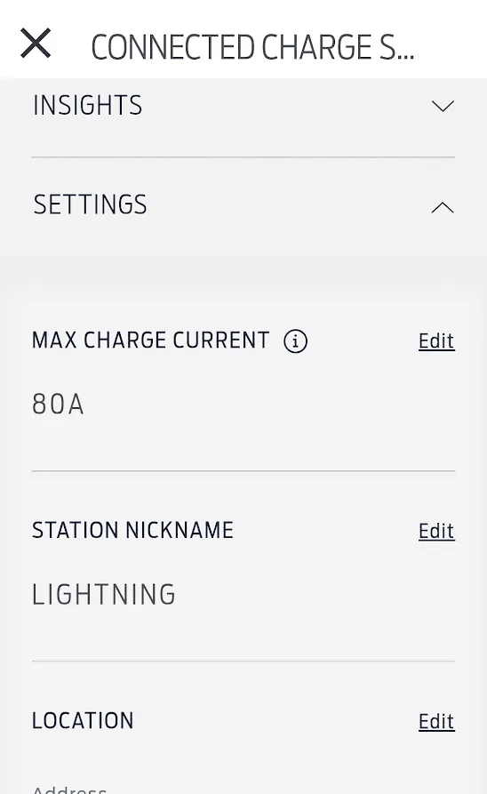

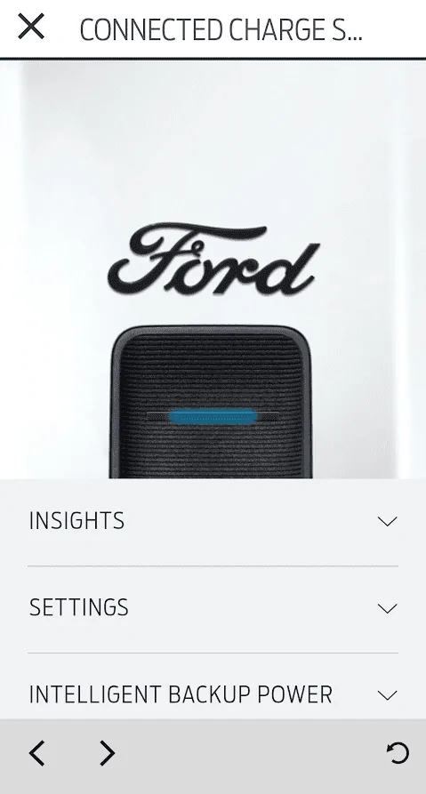

I killed the power, turned it up to 80amps and turned it back on. It connected to my wifi again but I still can't get it to connect to my Bluetooth.
(For clarity of understanding)
The FCSP does not connect to bluetooth on your phone directly, ie. you won't see it in your mobile device BT list of available devices.
The FCSP connects directly to the WEB via your home network.
Give it a few minutes to an hour to ensure that it's hooked up with the Ford cloud.
You should be able to see it VIA Fordpass, Account, Charge Station tile, you should be able to see Insights, Settings, etc.....

Oh this is good I see it in my Ford pass app and have connected it to my Wi-Fi but the Ford charge station pro setup app says to connect to Bluetooth on my phone I'm just going to skip that app I don't really need it I don't think
If you can see it via The Ford Pass then you're all set, the configuration app is useless at this point, only to be used if you need to do a root reconfiguration, hopefully that won't be necessary
